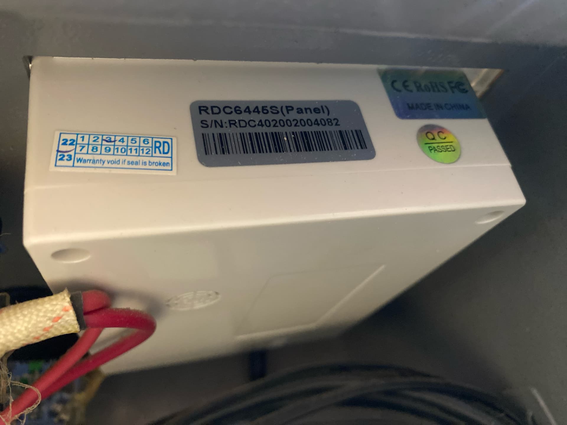

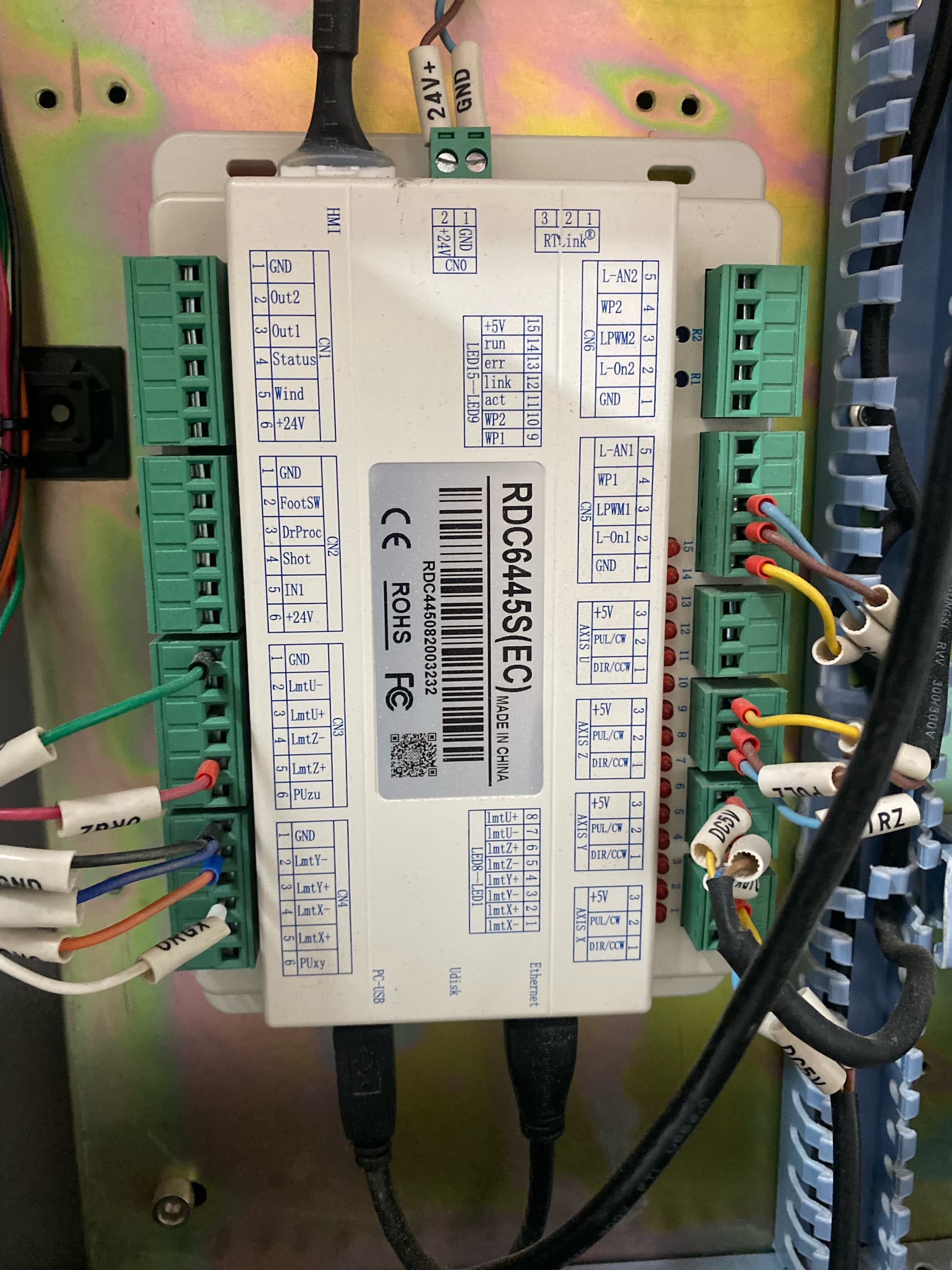

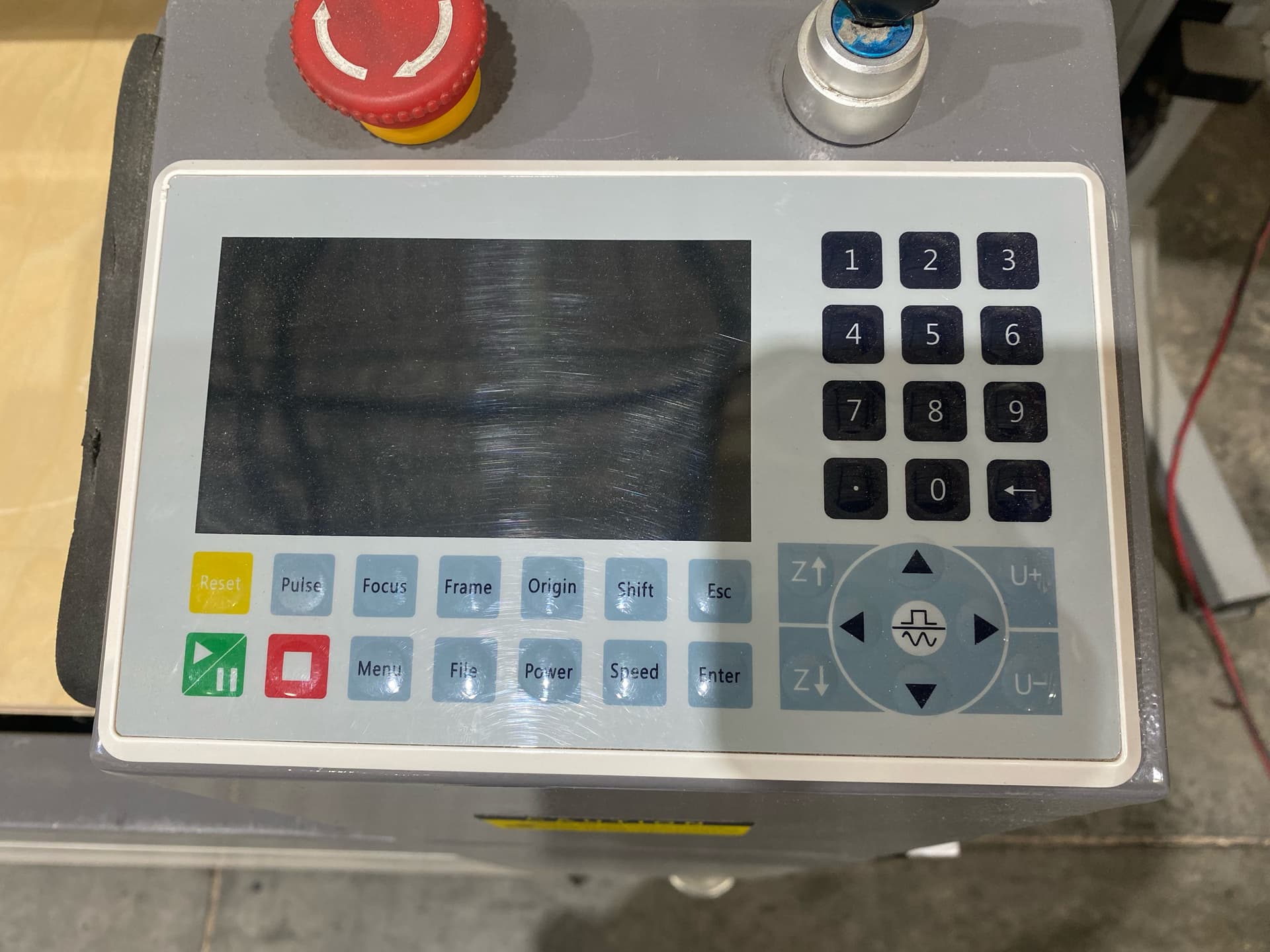

Full Spectrum LC1290 upgrade to Ruida and now crawl speeds
That is correct. No matter what we change in the control panel or in LB the actual run/traverse speed is around that 10mm/s.
Curious. I don’t see anything obvious that would be limiting speed to the degree that you’re describing. I’m wondering if perhaps the laser is just never getting up to speed.
Can you upload the .lbrn file that you’re using to test the speed?
Did you change out only the controller?
Did you get the vendor data from somewhere to populate the new Ruida?
Apologies here.
We replace the controller and the brain an we went from the preloaded settings.
So we can get the laser moving real quick when jogging around or when is first powered up. We also had it moving great for cutting but never for rastor(fill).

So we’ve tried 00mm/s and ramped up to 15,000mm/s with literally zero speed change from actual ~10mm/s(Rastor Only). Running the same test of cutting only showed an increased actual travers speed. So Rasto appears to be stuck at the one speed and Cutting has some kind of %ratio that we’re unable to locate and correct.
