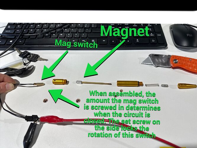

Fixed the problem!
It was a hardware issue with the touch probe. Turns out the touch probe isn’t a standard limit switch and instead uses magic (magnets). The set screw had come loose, and the magnet was too close to the electronic switch causing it to always show a touch. Disassembled touch probe attached. The settings combo that work are:
Z Axis
Dir Polarity: Plus
Key direction: Minus
Lmt Polarity: Minus
Focusing
Focus enable: Yes
Focus: 4mm (depends on touch probe install position)
Mat thickness: 0mm
Enable focus: No
^ The focusing menu does have “Focus enable” and “Enable focus” and the combo Yes/No seems to work best for me.
Hope this helps someone in the future!
