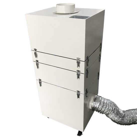

Hi all,
Due to increased housing where I vent my laser, I am looking at options for filtering the fumes before sending them outside. There are 2 options I am looking at, one (more expensive) option is a unit that has a built in extraction fan, while the second (much cheaper) option is just the filters in a unit that connects to my existing extraction fan. Does anyone have any experience/insight into these types of units?

Thanks guys. I wouldn’t be using multiple fans: Option 1 (cheaper) retains the existing fan, but pushes the air through the fume box before it is expelled. Option 2 (more expensive) replaces the existing fan as it has one built in. To me I can’t see how this is any different but the price difference is quite a lot?
Both have multiple filter layers so I don’t see any difference there.
I am leaning towards to cheaper one as I don’t see any real benefit to having the all in one unit?
Yes both options have multiple layers of filtration as you mentioned.

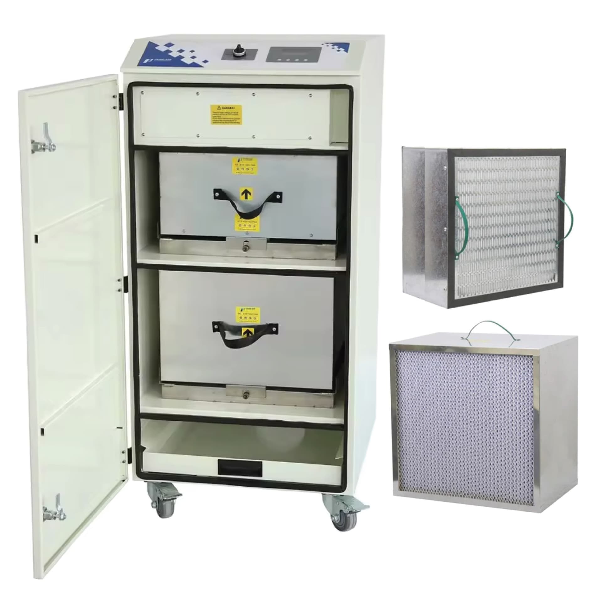

These are the x2 different units I am looking at:
This is the one that is filters only:
This one has the inbuilt fan
I think they look nice and they should work…, but…, acquisition and operating costs require a profitable order backlog.
