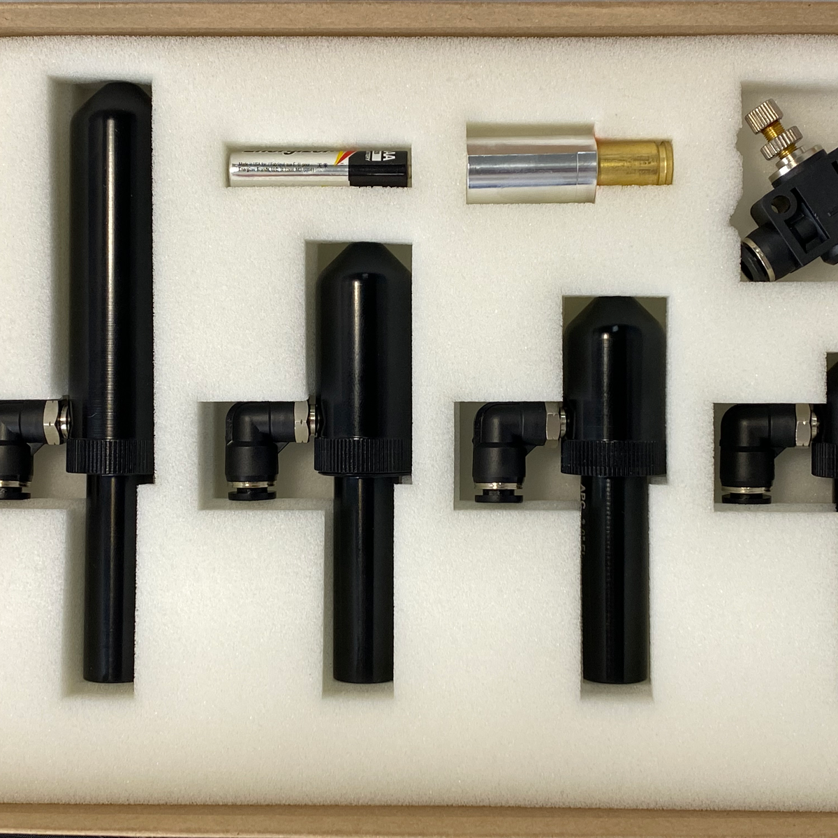

I have and thoroughly love the American Photonics 3 piece set 1.5, 2.5 & 4" lenses. Their focusing system is unique in that they all use the same focus distance form the workpiece, a AAA battery in it’s side. The lenses are glued into the tube so there is no way to install upside down or to have them fall out of the holder while handling.
I do a trick with the 4" lens when engraving tumblers. I made a custom focus gauge and use the 4" lens with the cone for the 2.5". That gives me plenty of clearance so I don’t have to worry about hitting the handle tabs.

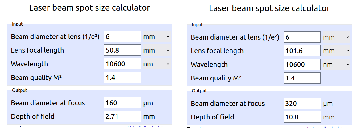

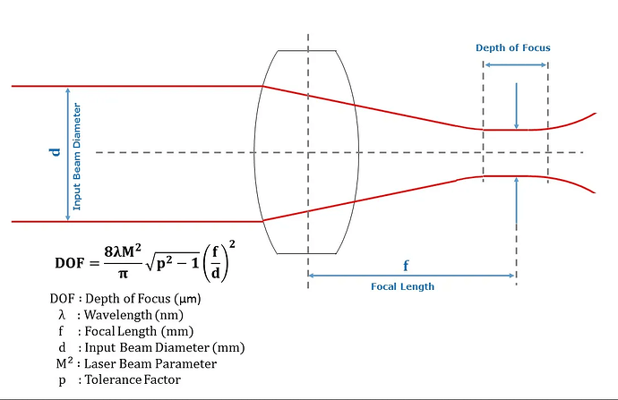

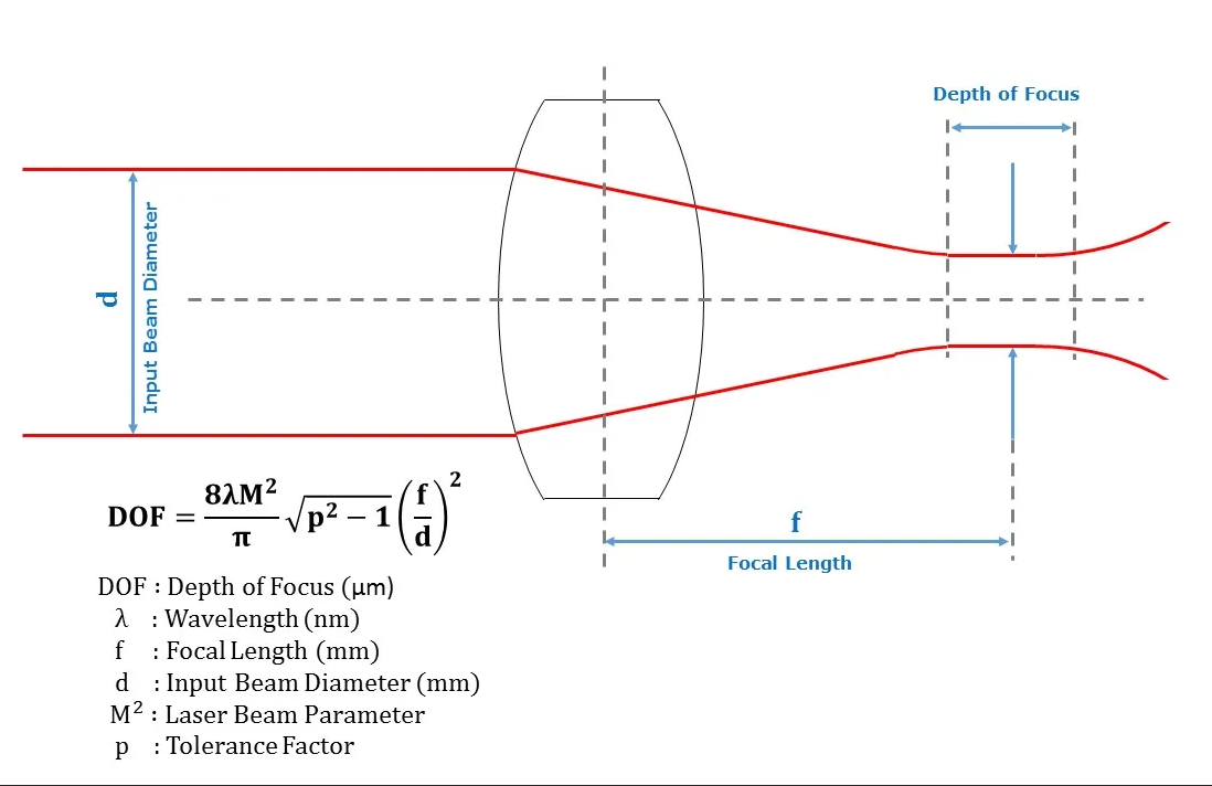

Pick your lenses on how much resolution you expect for engraving or how thick of material you need to cut. Shorter lenses have smaller spots and shorter depth of focus (dof). Longer lenses larger spot and deeper dof.
You can compute various options via on-line calculators such as this or this. See which one works for you best.

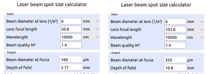

Here is the 2nd calculator where I used a co2 frequency and a 2" and 4" lenses.
I cut 3mm acrylic and basswood with my 50.8mm (2") lens. The spot size is 160 microns (0.160mm) You can see it only has a dof <3mm, so you could see a slight taper in the closet <0.15mm of the edges.
If I move to the 4" (101.6mm) lens, I have a spot size of 320 microns, but a depth of field of over 10mm. I use the 4" for cutting thicker material.
The best resolution from the 2" would be it’s spot size or and interval of 0.160 for a possible dpi of 158.75. – 25.4/0.160 = 158.75 A 4" lens would be 25.4/.320 = 79.375dpi.

I have four lenses also. I have a tube for each lens, so I marked the tube (using my fiber) so I know pertinent information. This is the 4" (101.6mm).
Make sense?
