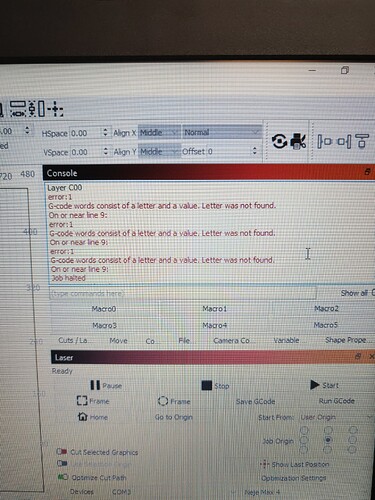

Problem with engraving a photo, laser starts in lightburn software and then freezes, don’t know where to look for the cause. Anyone have some idea? Photo of error

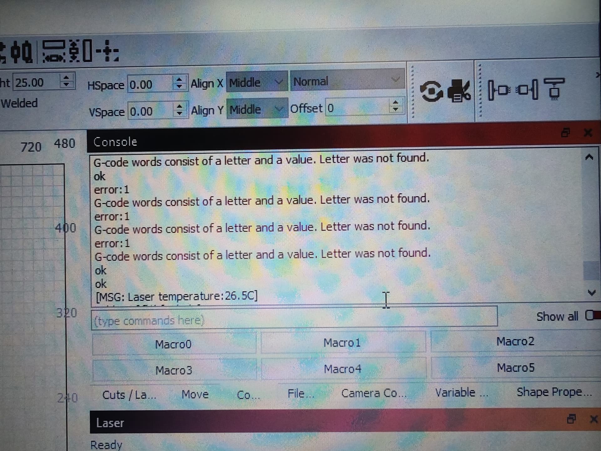

Try scrolling up a bit more to the FIRST error that appears in the console

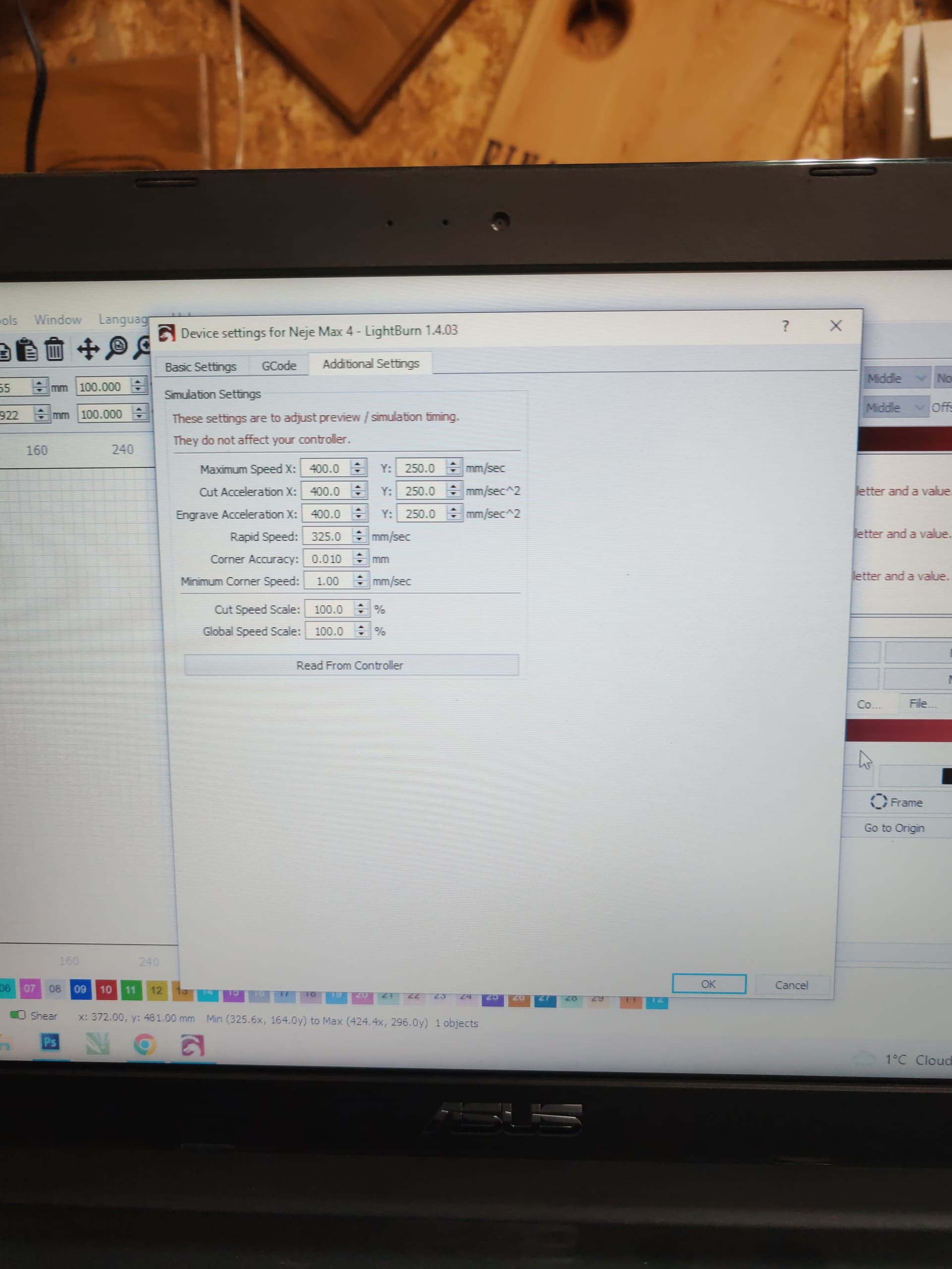

Edit → device settings

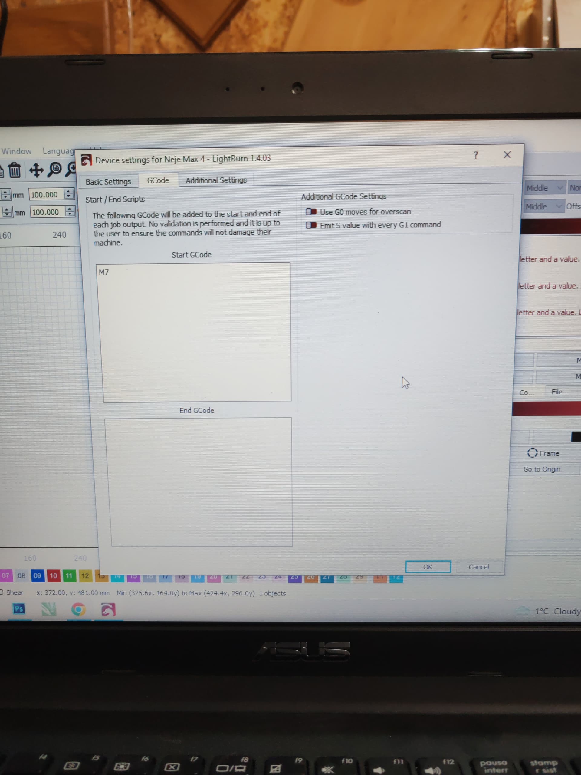

Could you send a screenshot of that menu too as well as a full screenshot of lightburn itself?
Disable Gcode Clustering
AS far as i know Neje does not support it
Should fix the issue
Also, does your NEJE have Z axis (up and down)? If not, disable those as well (top right corner)
Yes, g-code clustering was the problem. Thank you very much and for extremly fast help ![]()
