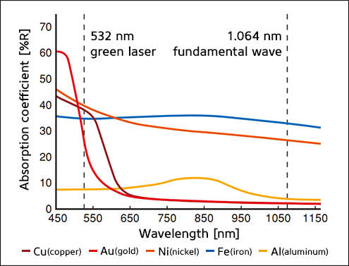

A 532nm (green laser) has a higher percentage of absorption, than the same materials at a longer wavelength. This goes the wrong way when we
These are absorption values for different metals. At lower frequencies (longer waver length), like IR (Fiber and Co2 are in the IR area,) there is not much absorbed, most of it’s reflected
The machine pumps the fiber up, then opens the gate and it’s dumped out the fiber.
When my fiber pulses, each pulse is 18 kw. Even with only a 10% absorption, that 1.8kw per pulse.
