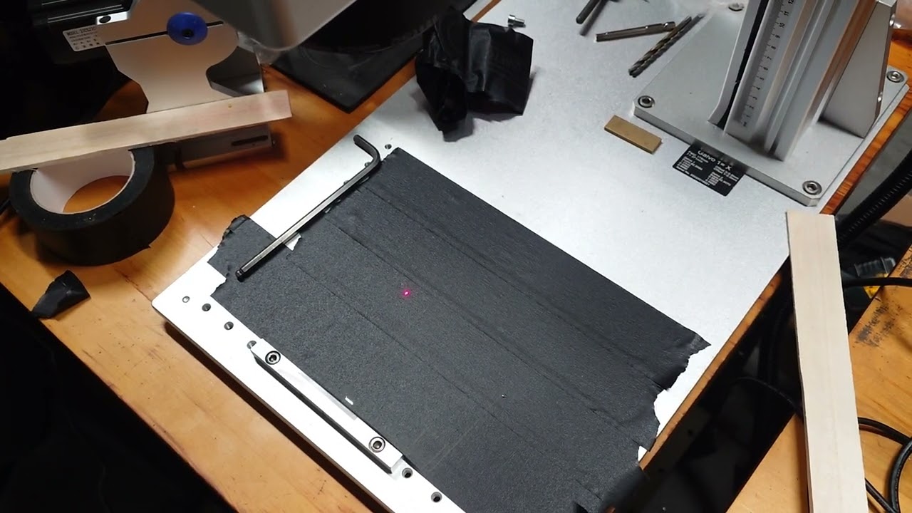

I have an OMTech 30W Galvo fiber laser that I’ve been using for a while.
The main thing I’m having an issue with, that has always been an issue (machine is secondhand) - is the laser gets weaker the further away from the bottom left you get. About 60mm up in the Y direction (away from operator) it’s basically useless. It doesn’t mark at all, unless you’re at 100% power, in which case it makes it maybe another 20mm, but the areas below it will be much deeper engraved. The X axis (left to right) doesn’t seem to have this issue as bad, but it still is present, however only slightly.
I’m guessing it has to do with some mirror alignment? I only find ways to align the red dot though.
This issue occurs with both my F160 and F254 lenses, it seems to scale linearly with the lens.
I lined up my red dot and whatnot but it’s always had some skew/buldge issues on the edge. The red dot is correct on this (it follows the skew the laser outputs), but it still doesn’t provide a square field, so engravings get skewed on the edge. I’m working to use EZCad to get a corfile, but I can’t even get the calibration square to mark fully.
My laser also has a plate with some values on it (Galvo 1 = X, and some scale values) - but these are not consistent with what I’ve seen works in EZCad/Lightburn.
Here’s a photo of the calibration plate (can I use this for something like the skew/buldge/scale adjustments? or should I not trust it?) + the issue (although it’s not visually very interesting)
It’s not likely mirrors, but the head itself. If the head is not mounted parallel to the work surface, you’ll see the focus distance change across the work area. Using some shims between the tower and the head to adjust could help.
Interesting! I’ll try using my precision level on it to see what I can find.
I couldn’t find my precision level, but I have another one that’s pretty good, and I’m seeing that its about 1 degree off across the head (the final box) with the farthest part from the operator being the highest, so that would explain this. I’ll try shimming it out and report back.
Ok, I tried shimming it to neutral, and also in the opposite direction of where the issue is (by just a little bit) and had no luck. The laser fades off in intensity very quickly towards the top half, although the red dot is able to cover it. I believe it also has a much lesser intensity towards the top.

If your table is level, the head is not
Haha I figured someone would say something because I left the level in the photo, the table is not level at all because of the poor concrete in this building. I checked the head vs the base and everything is within 1 degree (side to side is about the same amount off as front to back, and side to side engraves fine)
