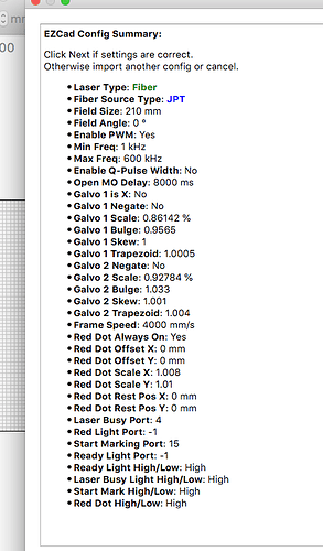

Good Morning. I have installed Lightburn Galvo on my Mac and have gone through the import of the Mark 7 files. AT this time I can not seem to get the frame functions to work. I do have a red dot but when I frame the laser fires a quick burst and I do not see the frame action. I know it is firing. I have placed a bamboo cutting board on the laser bed and see the smoke from the burst. I have read through the forum and have not found any solution that seems to work. The source is a JPT LP 50 with a ezcad board. I do not have a windows computer to install ezcad on to test the machine that way. Any I help will be appreciated.

I see you have your ‘Start Marking’ port set to ‘15’ in the above screenshot- did that change not persist when you adjusted it, or did you change it back to ‘15’ because setting it to ‘None’ didn’t solve the issue you’re having? If it didn’t persist, make sure you are clicking ‘Ok’ after making the change, and not 'X’ing out of the Device Settings window or clicking ‘Cancel’.
changed it back.
When you click the Framing button and the laser fires, is it pulsing in one location, or marking the graphic you have in your workspace in LightBurn? Is it pulsing once or continuously? What status do you see in the ‘Laser’ window?
one location
