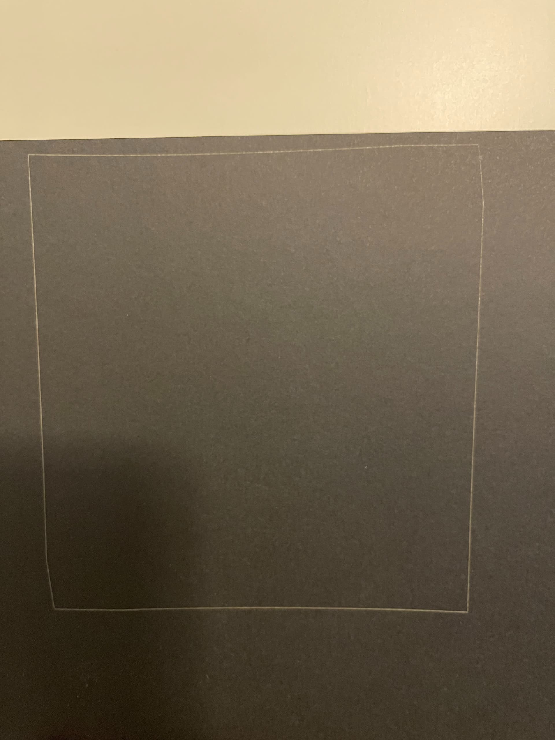

Today I noticed when framing on a JCZ 50W fiber laser my framing bound lines are not square. One side is bowed outward. Removal of the 110mmx110mm lens shows the same issue. I am unsure if this is related but I have also noticed that the sizing on lightburn vs the output size of the frame is not the same, whereas the bound lines are a bit larger than what is displayed on lightburn. I am assuming this is due to poorly aligned mirrors. The laser head did not undergo any type of impact, and this was never an issue for the past two years that I’ve owned the machine until today. I am unable to find any reliable resource on aligning the mirrors, should that be the issue. Any insight is greatly appreciated! Trying to take a picture has proved difficult and can only capture segments of the framing preview since it is constantly flashing.
Here is a picture of a scrap piece of plastic I ran a square engrave on to show the warped side of the square which is indicated when I run the frame function as well. You can see on the left side of the square, the line is bowed outward. This frame is exaggerated obviously with the removal of the lens.

This is an F-Theta lens which focuses on a flat plane. These have inherent anomalies and need to be corrected… each lens needs a unique correction file for that lens…
Where did you get this machine…? Is it a MOPA?
It should have a configuration file somewhere on the software memory stick. It’s markcfg7 and needs to be used when you configure the device for Lightburn.
Mine was here on the memory stick
/LMA22A1095JZ/Ezcad2.14.16/plug/markcfg7
Did you find the file and import it into Lightburn when you created the device? This is, by far, the most simple fix.

Using the original USB that came with the laser, I reinstalled EZCad2 on my PC. Testing it using EZCad2 confirmed that the corrections on that file worked. When I installed my laser as a new device on my Mac in Lightburn and imported markcfg7, it did not remedy. To confirm, I also checked the params in EZCad2 and even copied them over in device settings on Lightburn, but the issue still persists. Seems to have even worsened. Not sure what I’m missing here, but maybe creating creating a cor file for lens correction on my PC and then importing into Lightburn will be the ticket.

Doing a reboot of the laser, Lightburn, and re importing the device with the markcfg7, it seems like I’m good to go. Everything is now scaled correctly, and bulge, skew, and trapezoid are corrected as far as preliminary measurements look. I will note that on a 110mmx110mm lens, it shows the field width and height as 160mm. Making a square larger than 110x110mm, the skews and bulges are back in play, but I assume that’s normal given that I am working outside of the lens’ parameters. Should this be adjusted back down to 110x110? 160x160 field size came right from the markcfg7 file.
