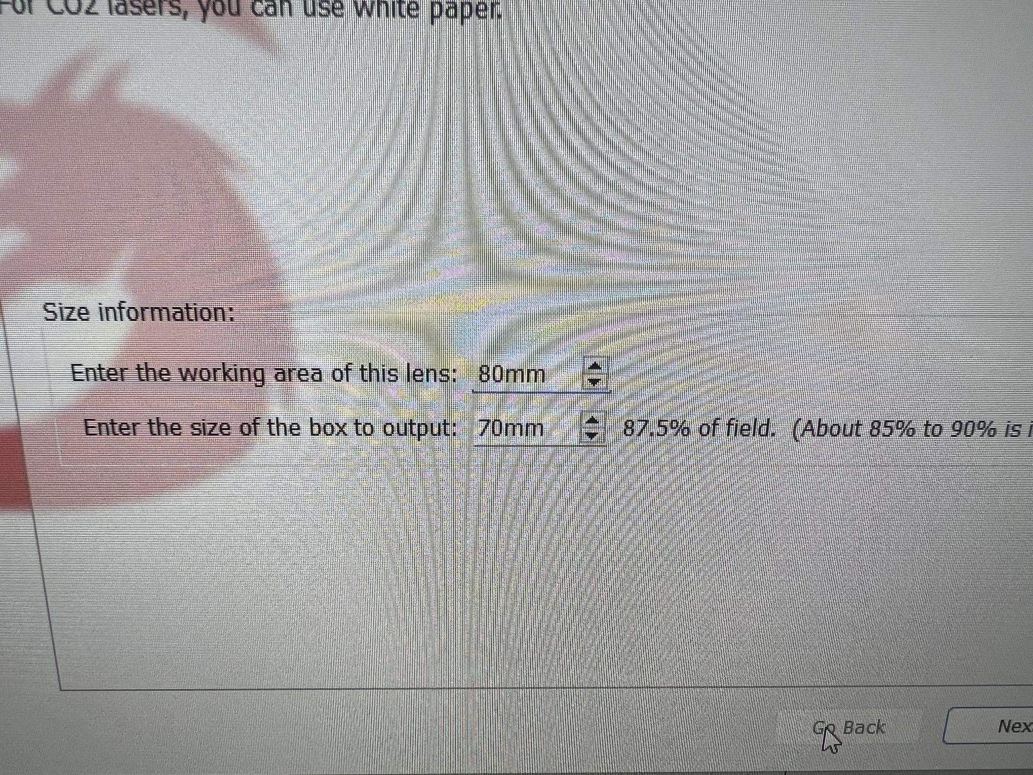

I’m running the Galvo Lens Correction tool in v1.7.03 with a ComMarker Omni 1 UV and the 150mm lens. No matter what I enter into the working size, the output grid to measure stays the same size and is larger than the capabilities of the laser’s lens to output. My grid corners are cut off and I have no way to measure them to continue the test.

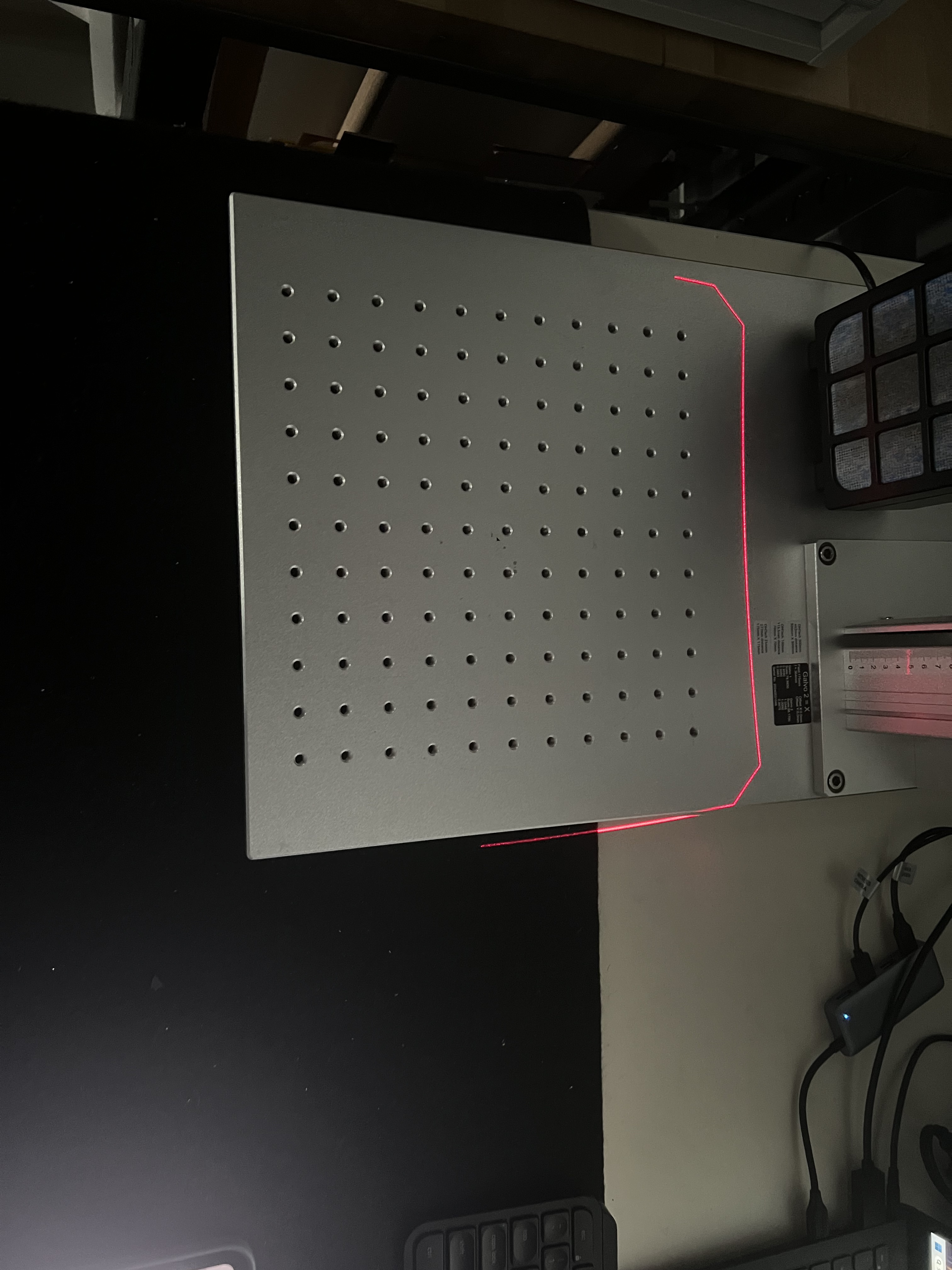

Changing either of those settings does not change the framing on my galvo. I shrunk both down to 50mm/10mm just to test and my galvo is still scanning at max size possible (about 330mm with clipped corners when calibrating a 300mm lens). I had to revert back to manual calibration using the device settings menu. Hopefully this will get fixed in the future.

Yes, it is both the Frame (preview) and the actual laser firing. I almost burned a line in my worktable because the extents are larger than my laser bed!
Here are some photos to show what I see, with what should be a very small 70mm square for testing, you can see the frame is at the max of the galvo range:

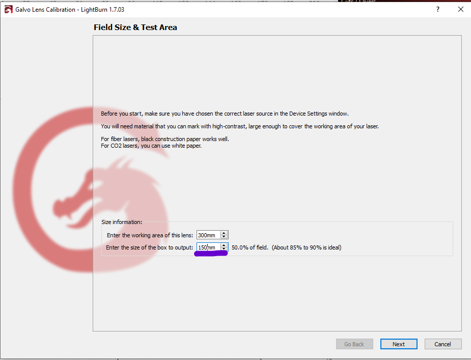

You said 150mm lens but you show 80 in your setup. Try 150 if that is your lens (150 x 150 )and then 75 or less for box output? It’s OK if your box is way bigger, after calibrating it should be close, then back on the settings screen you can fine tune scale.
It is a 300mm lens, but either way, nothing changes the framing, it is always max. I tried variations of the workspace size and calibration square all the way from 290mm down to what I show in the photo…. Nothing changes it from maxing out the galvo range. BTW, calibration the old fashioned way worked fine, it is just tedious.
150 or 300?
If you are indeed using a 300 lens, you put 300 in the top box, and 150 or less in the bottom box?
