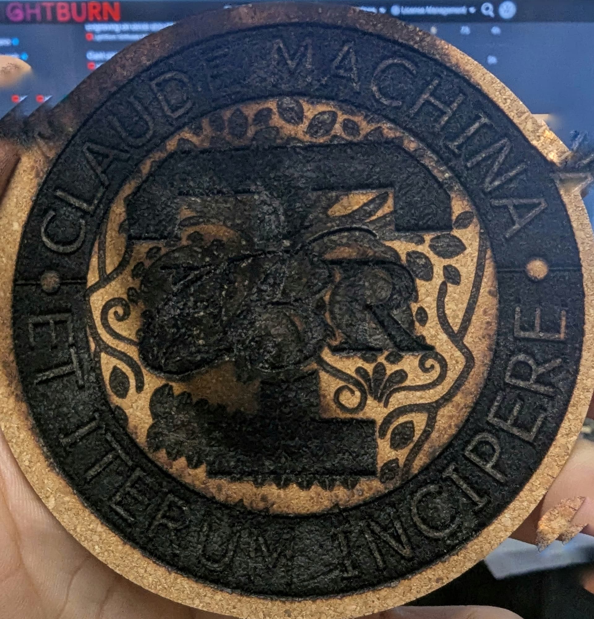

This all being the case, I pulled the file for a cork coaster out of my stash and worked up the replication steps for the bug (and original buglet). I originally encountered the bug on my MOPA fiber laser, but since my CO2 galvo uses the same driver and cork coasters are cheap and make watching the process much easier, I went with the CO2 laser. I believe the results would be the same on my fiber laser.
It would be quite welcome if the job counter would increment even if the Live Framing window is not currently open, but the results of reopening the Live Framing window during a job are certainly of higher priority. If the issues are as simple as I believe, the device file and project file should basically be irrelevant, but I include them here just in case.
Note: One coaster was very, very harmed in the making of this report. :rofl:
