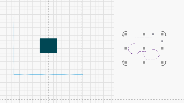

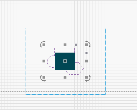

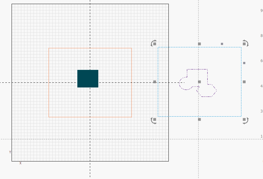

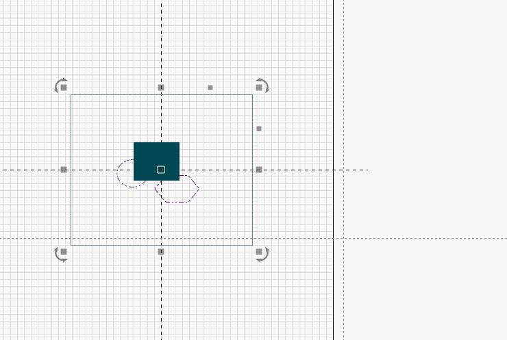

Hope I’m not getting too far into the weeds here, this example I used the 2 tool layers as registers and grouped with the 2 shapes. The 2 tool layers were centered before grouping. This way Shift-P centers the tool layer and art is located in reference to the tool layer regardless where the art is located in relation to the center of the work area.
Without register box:
Shift+P
With the register box
Shift+P

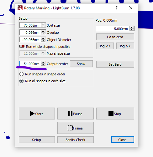

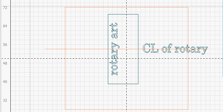

For the rotary, you could add a set of crosshairs that perfectly aligned with the rotary location.

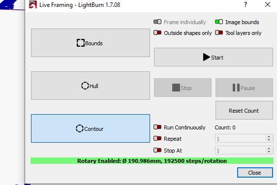

You also need to check/ adjust your output center, looks like 54mm in my example. If you get your rotary perfect it would be 50mm for a 100x100 lens.
Last, changer your framing to “Contour”

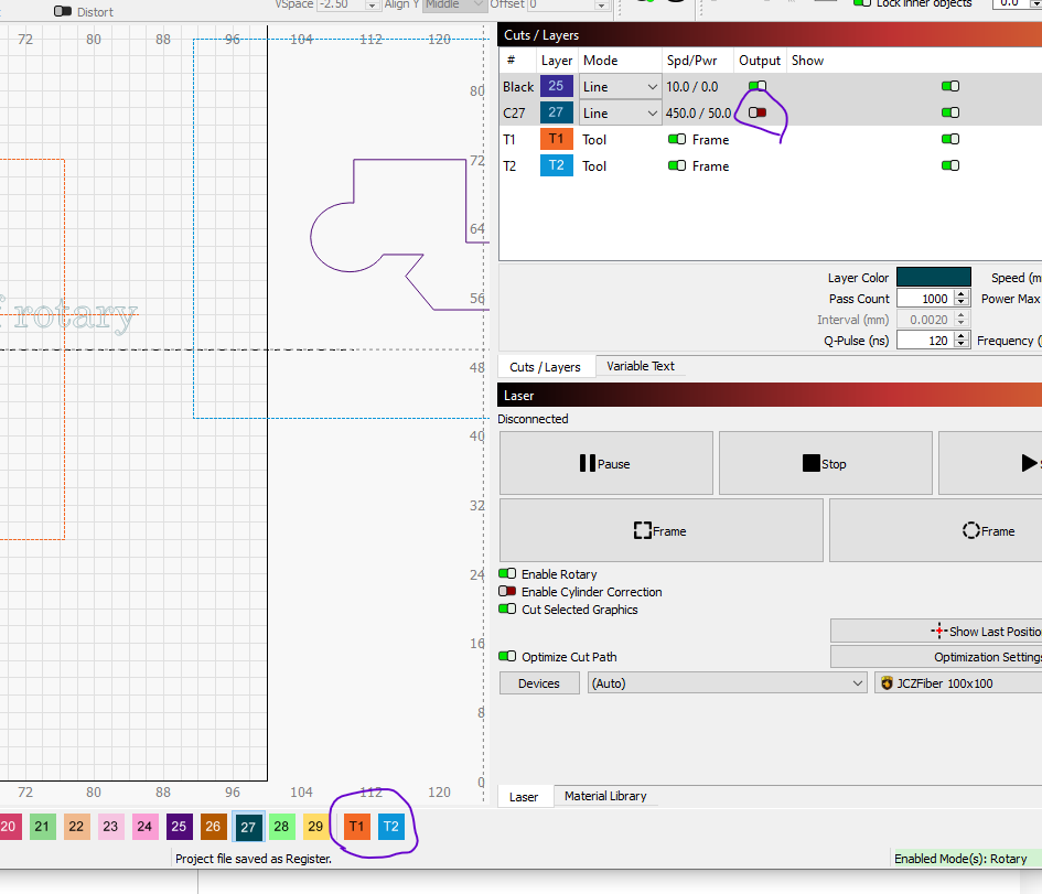

I appreciate the help and time put into teaching me, but for the life of me I can’t get a tool layer. I’m starting to see how it works and i’ve looked at 'Tool" articles but how do I get a layer that says Tool?
No Problem.
Select the object and click on T1 or T2.
T1 or T2. Or really any layer can act kind of like a tool layer with visibility on and output off.

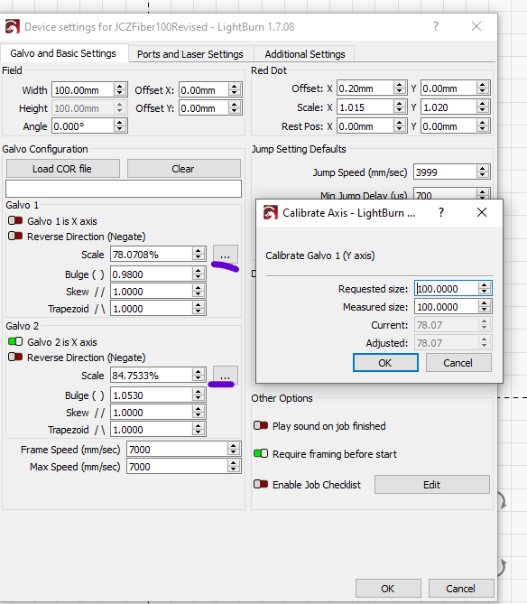

One part of the design is to long for the piece with a 110 lens. If I switch lenses, how many settings do I have to change besides the size in basic settings?

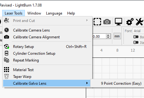

So if the lens didn’t come with the laser you need to go through a complete setup. Each laser and lens combo has its own unique settings. It’s not that difficult but may seem a bit overwhelming at first.

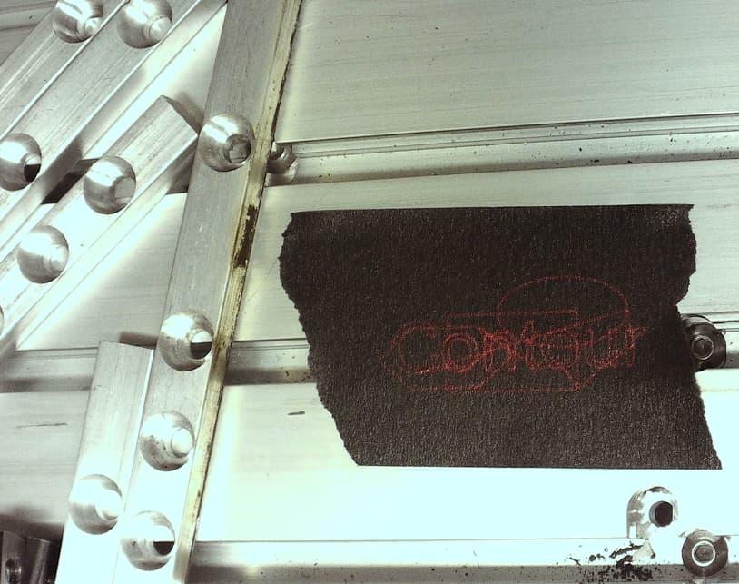

Review this information. I like to cover the whole bed with black painters tape, low power leaves a nice crisp white line to do your measuring with. Black construction paper works also, lots of things will work, needs to be flat, bigger then your table, and mark easily.
After going through this with the new lens, next step is scale. Each axis has its own button
I calibrated the 110 with black construction paper and ended up with burn marks on the bed. I couldn’t see the lines on low power, so I kept bumping it up. Maybe I’ll try the tape next time.

The black tape is the way to go.
