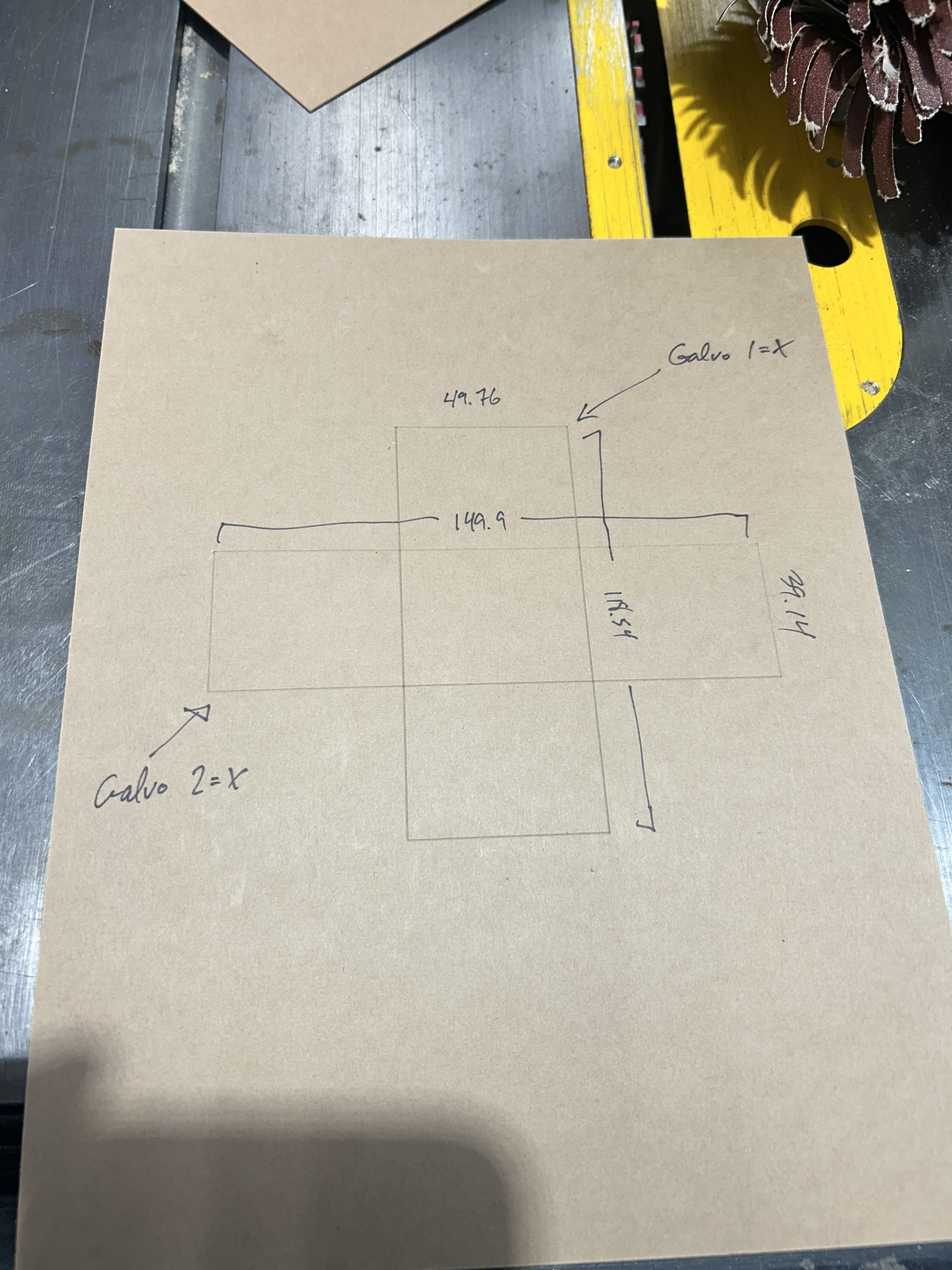

Do this test please:
  • Engrave a rectangle of 100x50mm.
  • Swap the two Galvos axes in the Device Settings by clicking on “Galvo 1 is X axis”
  • Engrave another 100x50 rectangle and compare the two.
The result result should look something like this where all the short sides and the long sides are the same distance.:
Let us know, how that goes.
So the video didn’t exist when I got my laser. I did follow @LaserEverything video for setup. Intially installed provided config files, scale etc wasn’t as good as I would like so then ran lens correction in Lightburn and made some adjustments until I was happy with everything. Had all measurements within maybe 0.2-0.3mm. Laser had been working happily with these settings for close to 3 months. See attached pic of burn you asked for.

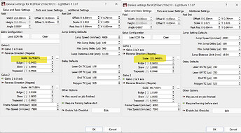

Thank you for the test. I forgot to mention, we also need to see the settings of the device you used for the test.
We received your Support Data in the email and noticed, you have duplicates for both the 210 and the 300mm lens devices with different scale factors for the Y Axis. Are you sure, you chose the correct one?:
Since the settings worked a week ago, try loading a prefs backup from that time to test.
Here are the settings used for the test. Yes, I installed the duplicate lenses yesterday and adjusted the scale to get a project completed and to test if this was a problem specific to one lens or all.
I am sure that I used the 300mm lens from this screen shot that had, before yesterday, been working correctly.
For my own sanity’s sake I have ran the original markcfg7 profile in Lightburn provided by Haotian and then ran the same requested size square in Ezcad 2 provided by Haotian. Below are the results. My opinion is definitely starting to lean toward some type of hardware issue after performing this test.
@Mike_B My train of thought about switching the Galvo axes was incomplete!
Of course, when we switched the axes and left the scale as is, it does not give any easy insights because when the orientation changed, the other axis gets scaled.
If you do the same test again but rotate the rectangle after changing the axis (press the . Key) you should get two perfectly aligned rectangles.
Yes they appear to be aligned perfectly.
