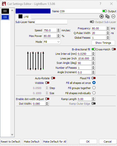

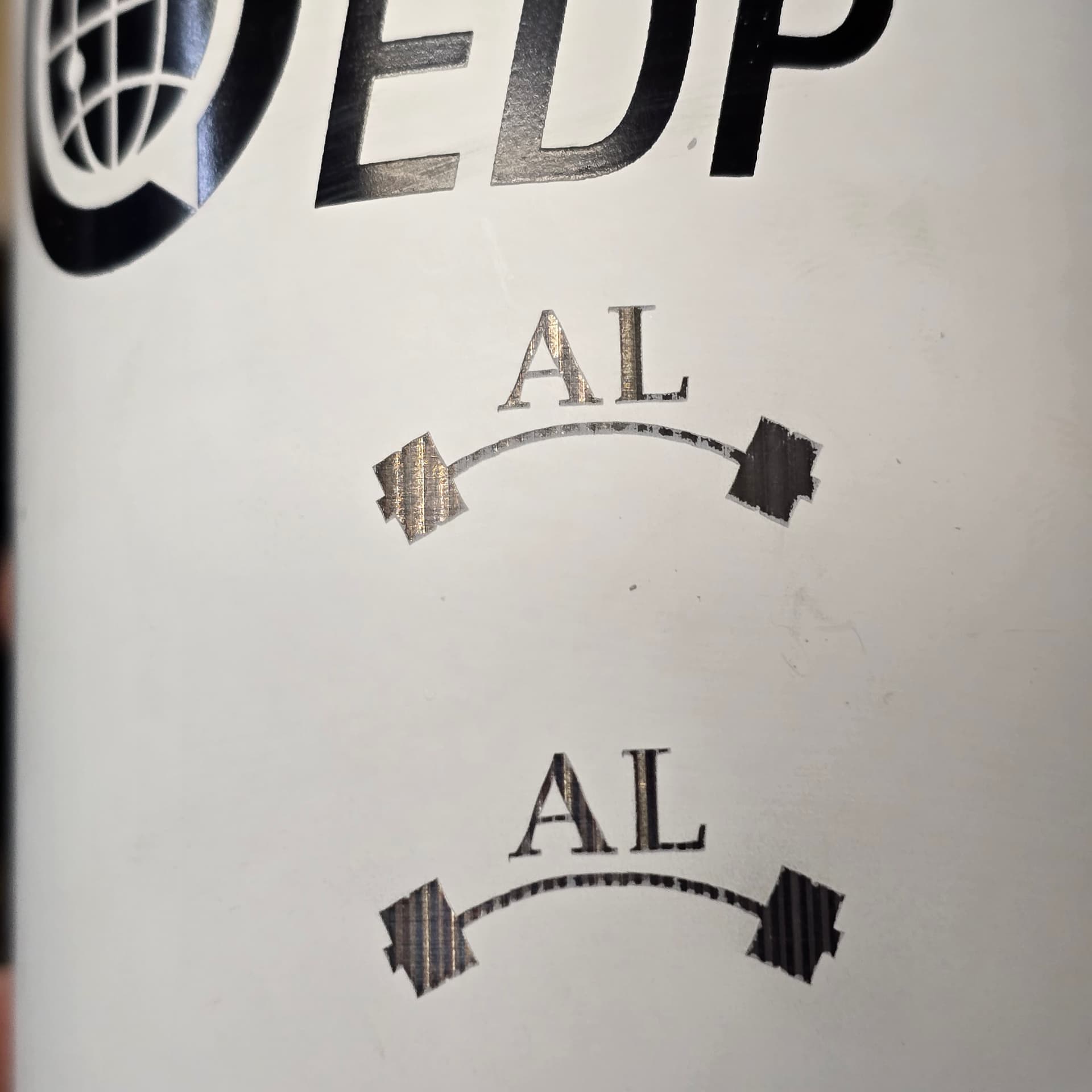

I’m having trouble with rotary on a galvo where i’m getting this striping pattern. my split size and lines/mm are both set to .02mm. Does anyone have experience with this?
Thank you

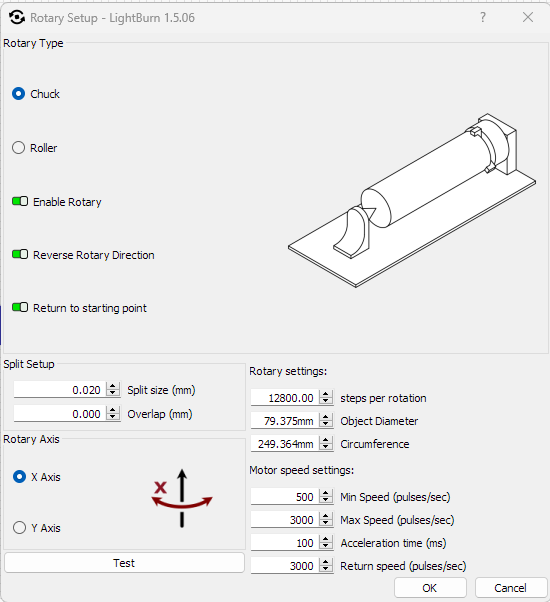

Chuck or roller? Diameter of workpiece? If Chuck, what are your steps set for in LB? Does the rotary turn 360 when you hit test? Post screenshots of your parameters and rotary setup.
It looks like cadence, and 0.02/ 0.02 is probably causing a lot of that. If you answer the questions above probably can get you straightened out easily enough. .
If tumbler exactly 80mm,
| Circumference | Steps | resolution |
| 251.3274123 | 12800 | 0.01963495408 |
So the surface moves 0.0196mm with each step. Your 0.02 is pretty close, The small difference is possibly what is causing the cadence pattern. I would suggest a multiple of 0.0196 for your split like 30 or 40. 30 hits a zero 3 places in so example split 0.589mm, line interval 0.0196

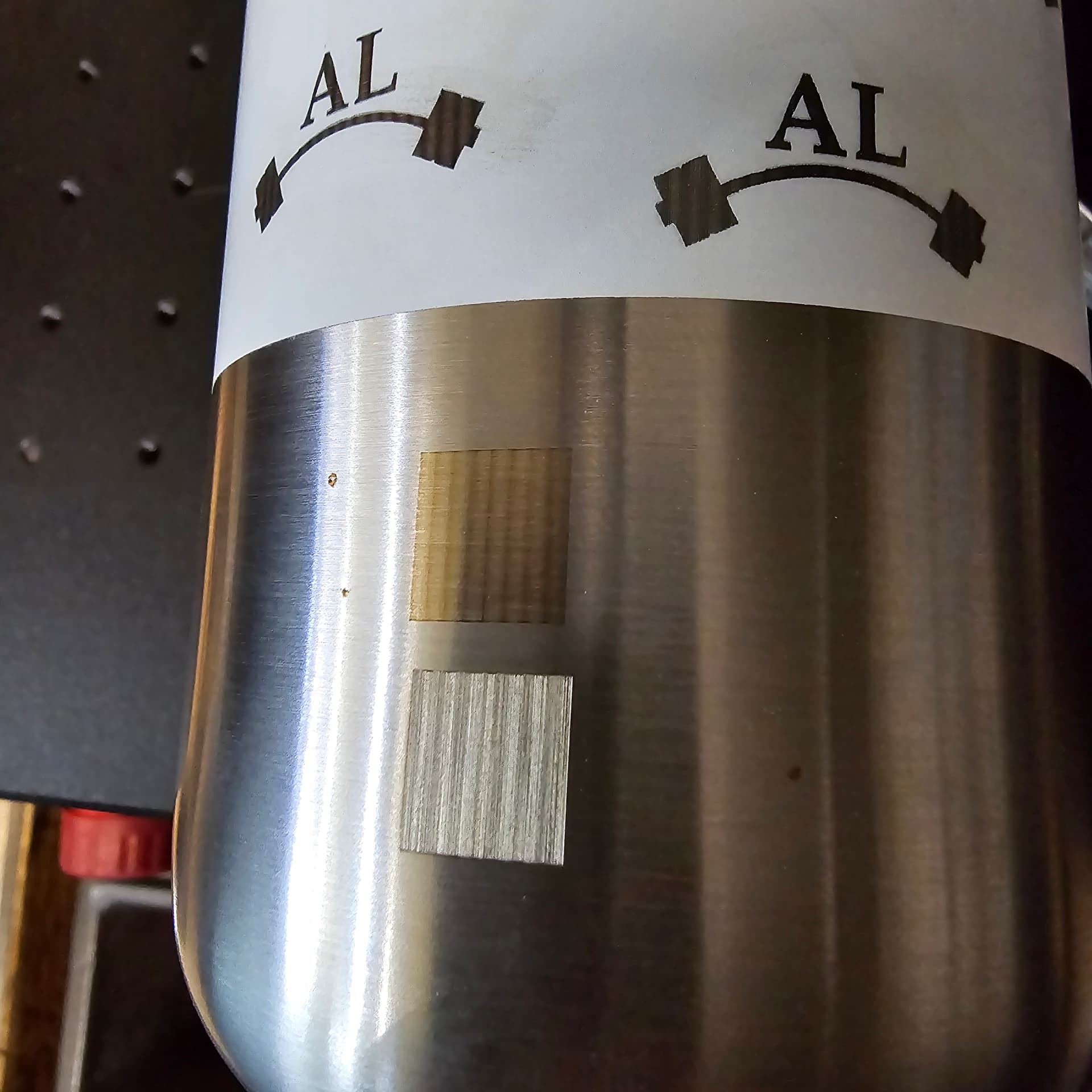

Recalibrated all the TC and put the jump settings to the safe slow settings. Nothing has changed. Tried to do some 3mm squares filled with .025 interval and all different slices divisible by .0195.
I can hear the laser stuttering/pausing/skipping steps a couple of times during the test. You’d think a solid 3mm square would fill consistently and evenly, and it does when Im not using rotary. I have tried two different computers with the same result. Any ideas?

Yes parallel to the axis of rotation. Here is 100x100 square on the bare bottom part of this cup. Same pattern.
Really looks like a cadence from the rotary moving unevenly or incorrect diameter. Are you still using the parameters you show above?
