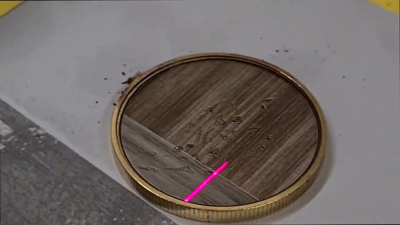

Hey G’day,
Has anyone experienced Galvo working ok, then power cuts out continues scanning but without power.
Happened twice to date, my fix is restart lightburn. I have been fortunate where its stopped working 5/6 minutes into the job and not halfway through the job.
I thought happens once its an anomaly, twice well it could become a habit.
I have a 40 second clip if you watch it all the way through you’ll see what happens, cutting fine then gone, I have an overhead shot so you can see the scanline I’m talking about.
If anyone can shed some light on this would be appreciated.
What kind of laser source do you have? JPT/Raycus?
We’ve seen this before… I don’t know the current status, seems to prevalent with a Raycus source…

60watt JPT M7
I called the supplier of the laser, they remote logged in to my pc, first thing they did was switch over to ezcad2, they seem to have come across this issue before.
So I guess not the machine, soon as they logged off I said ty, then switched back to LB lol…
I thought maybe an issue with PC/RAM.
Restarting LB fixed the issue so was thinking possible memory leak corrupt file.
Any way not particularly stressed by it knowing that you are all on top of it. So long as it doesn’t catch me 1 hour into a 1 hour 5 minute job I’m happy :stuck_out_tongue:

Does this shut-down happen consistently at the same elapsed time or position?
If it’s not identical - is the timing similar (several minutes into a task) - always between layers? Halfway through is good to know but not as telling as 7 minutes in or after this cleaning layer with these settings.
This might be new and this might be related to Settings Drift. Either way, I’d like the opportunity to capture this.

Both jobs - I will called it red line of death occurred around the 7 minute mark.
Both were 3dslices.
each time I had to shutdown LB restart and was good to go from there.

Well no work for me today, red line of death can not do a thing. Was working for a while now just being difficult.
Testing simple image to an axe, doing cleaning pass, first pass ok second red line.
Restart LB restart laser, first pass ok second redline again. All within first 60 odd seconds.
Restart redo, no cleaning pass just doing a halftone about 60 seconds in red line.
Delete redo file, same thing so today is a loss. Will try again tomorrow uploading files for you to look at.

Have tracked down the issue, and its not a lighburn problem it was a source problem and heat.
For whatever reason, the source was overheating reaching 50c and the magic red line of death appears.
