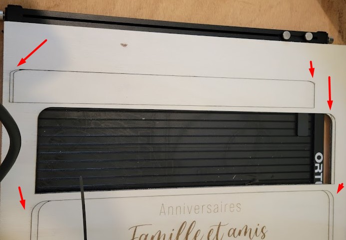

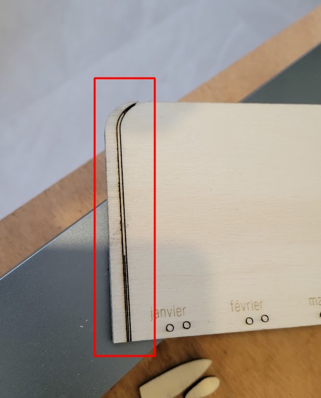

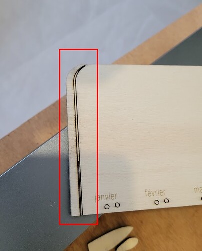

I’m using a Ortur Master 3 with Light burn, everything worked well except yesterday when I tried to cut with 5 passes a large piece of wood.
As you can see on pictures, the path of the cut changing after 2 or 3 passes … Any idea ? I have the gcode if it helps …

You are engraving at 250mm/min - this speed shouldn’t be an issue.
I would be interested to know the set values for the accelerations associated with $120 and $121. If these machine settings are high, the lost motion can be generated when jumping to your next pass.
Another setting that can influence how much time (or distance) the engraver spends accelerating, is the default maximum (travel) rate $130, $131. When the engrave speed is set low for production, if the Default speeds are still high, the engraver will speed up until it arrives at the high speed, travel a small amount then decelerate back down to the engrave speed.
You can read the settings by typing $$ in the Console window in LightBurn,
followed by the Enter key.
You can scroll around in the Console window and Select, Copy and paste any of the settings you’d like to share.
If the Settings are fine, the next step may be checking pulleys and belts. :slight_smile:

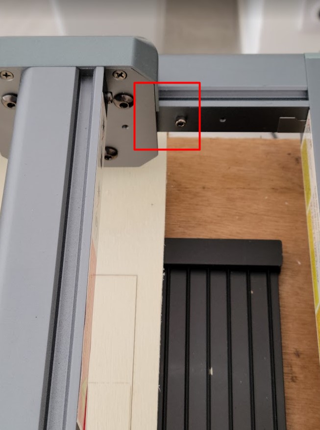

My next step would be testing each and every set screw (in the pulleys) with an Allen wrench or Hex key to ensure that they are all tight.
The screws can shake loose and the unwanted motion slowly increases.
just checked an the belt are tight, I checked that 2 days ago and was already ok. I have an other issue, maybe its related … the “home” position is incorrect, to far away from the real home position. When I move the laser manually and “get position”, X is “-10” … weird … Maybe I can reset the home position ?
Belt and pulleys are two entirely separate checks. A loose pulley can spin infinitely around the motor shaft regardless of belt tension. A slightly loose pulley can shift back and forth slightly. There may or may not be flats machined machined on the motor shafts. If there is one or more, a grub screw should firmly engage it/them.
As you also have roller guides , you should check the eccentrics to make sure the carriages are free of slop.
