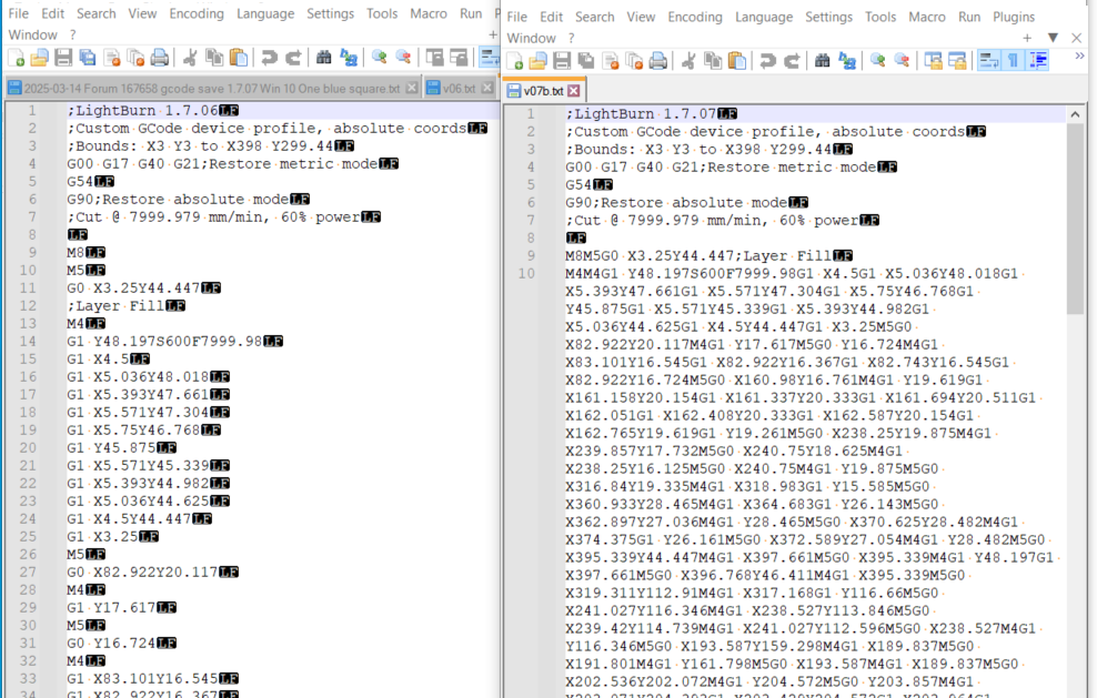

Somehthing has changed in 1.7.07 in the CGode exported files, that they no longer works in my AtomStack or is shown in LaserGBRL.
If you open the file in WorkPad, you can see the lines are not separated, but they are on a long line.

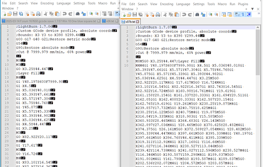

I made a duplicate copy and renamed it by adding ‘Wordpad’ to the filename.
I opened the duplicate copy in Wordpad and saved it.
I opened both files in Notepad++ and enabled ‘Show End of Line’ characters.
View - Show Symbol - Show End of Line
The renamed duplicate had CR LF line ends and the file directly from LightBurn did not.
I renamed both files by changing the suffix to .GCODE
LaserGRBL only recognized the Original file from LightBurn and loaded it successfully showing the rectangle I had drawn in LightBurn.
LaserGRBL did not recognize the file that was modified by Wordpad to have CR LF line endings. It wouldn’t even display it as an option to Open in LaserGRBL.

As you can see, these files are not identical.
LaserGRBL does not recognize the .gc file renamed as .gcode
And my laser does not work with the .gc file (it reads it, move a bit the laser head without turning on the laser and return).
Tested in 2 different computers. Both generate the same strange files.

No argument here. They are different.
A Custom GCode device profile is being used. It’s still labelled ‘Experimental’ in the Custom GCode device set up process.
I have reproduced the behavior with the absent LF characters.

I am using a custom one, because we were discusing a way to make the Atomstack X40 work (there is a thread about this somewhere). The translating movement were way slow, and a custom with some tweaks make the movement faster.
