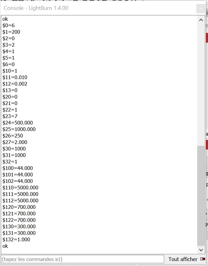

With your engraver connected to LightBurn, In the Console window in LightBurn, please type the following:
$i
pressing enter after each one.
Please select and copy the text from the Console window in LightBurn into a reply here. These reports will show us the System Information report from your engraver and the Machine Settings report.

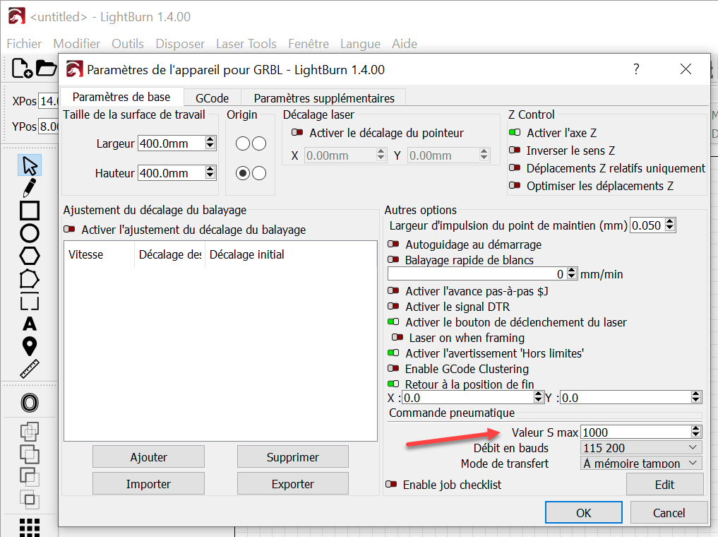

One is in the Device Settings window. Please open it in LightBurn and capture the information with a Screen Capture tool.

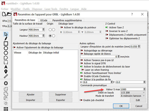

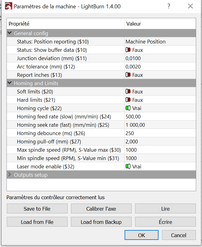

J,ai pris trois capture d’ecran puis mes paramètre on l’air correct
mais toujours le meme problème avec mon laser
In the Console window, Please enter the following:
$31=1
then press enter.
This should restore your power scale. :slight_smile: On more thought remaining.

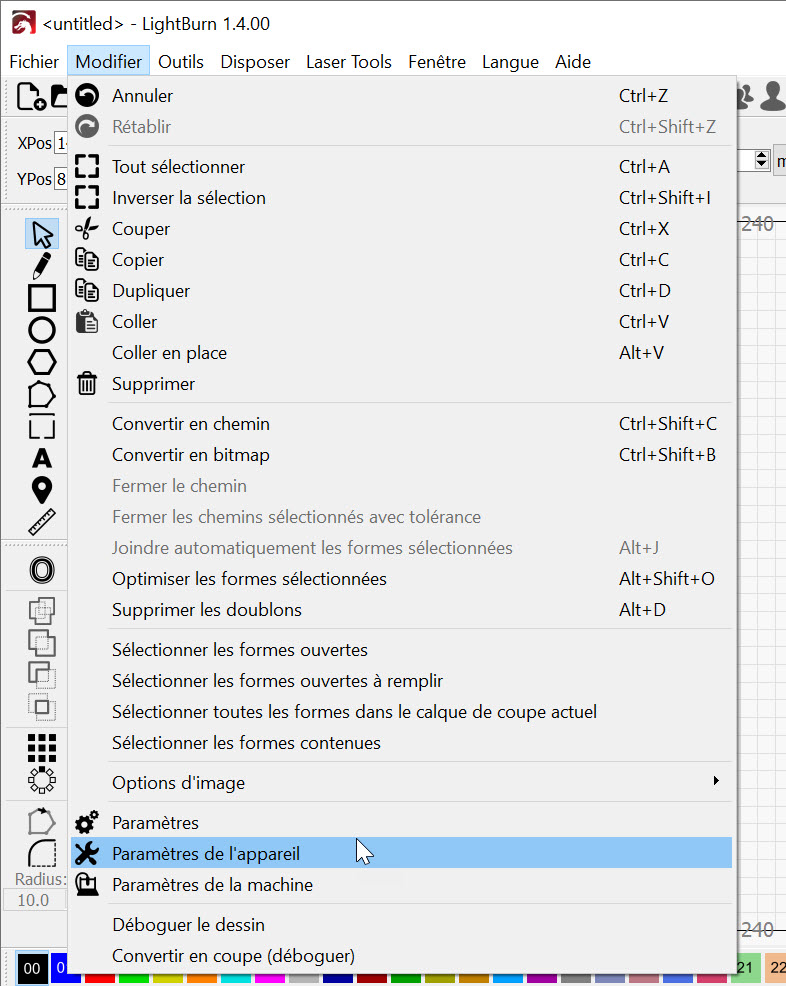

We should review the Setting for S-Value max in the Device Settings ‘Pop up window’. It shows up when you click Edit, Device Settings, and look toward the bottom right corner. If S-value max = 1000 you are clear to re-test.
