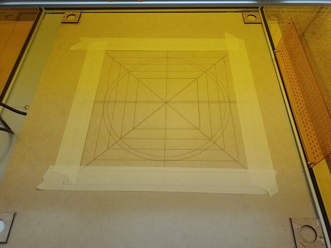

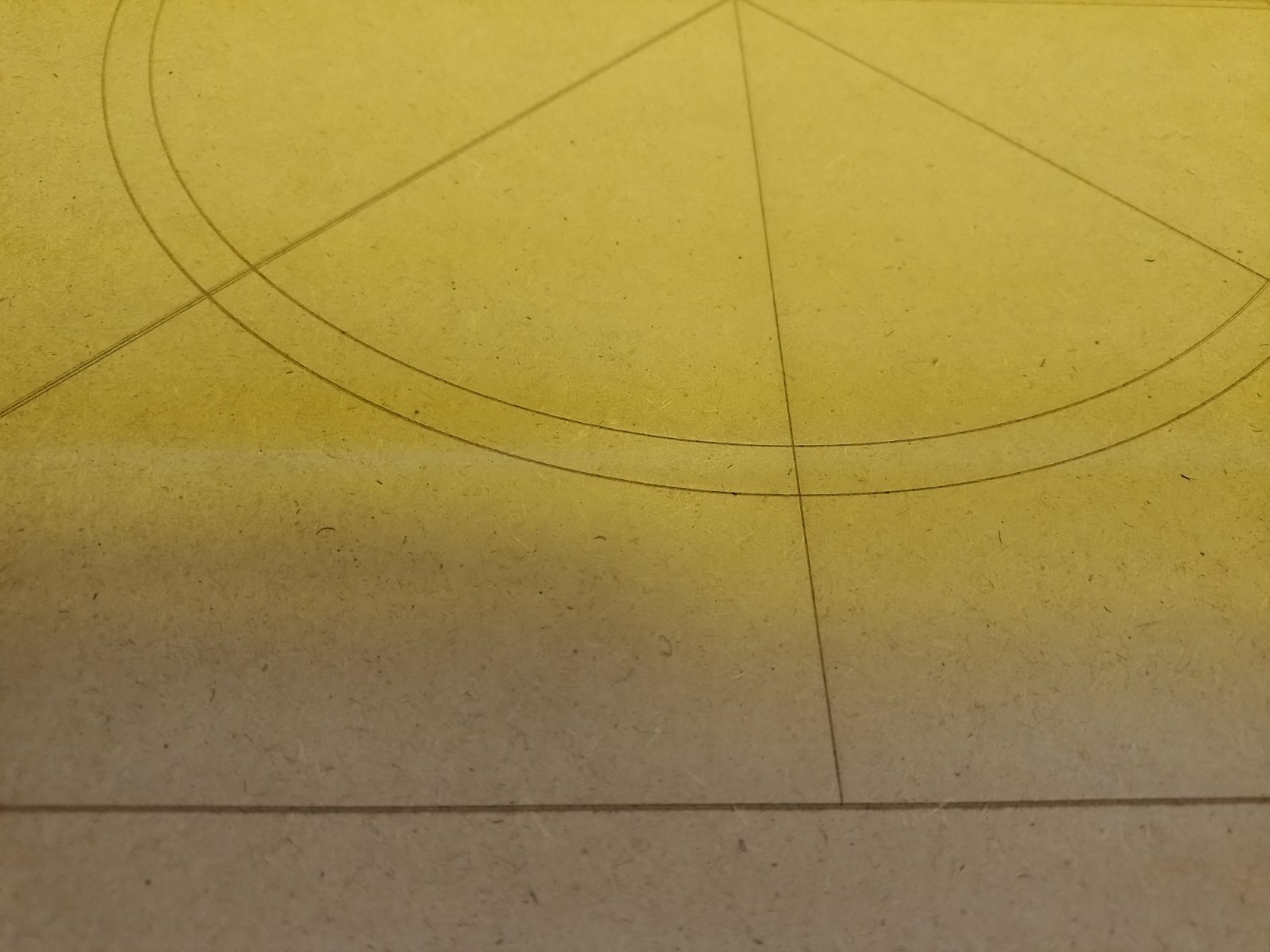

So as shown in the images it is noticeable that when the machine did its full workspace (399x399) engraves at around 20 000 mm/min and 100% power after every run the line would miss by a little so after some time of repeated squares it just became this super thick line and it was not possible to read anymore if it was any better.

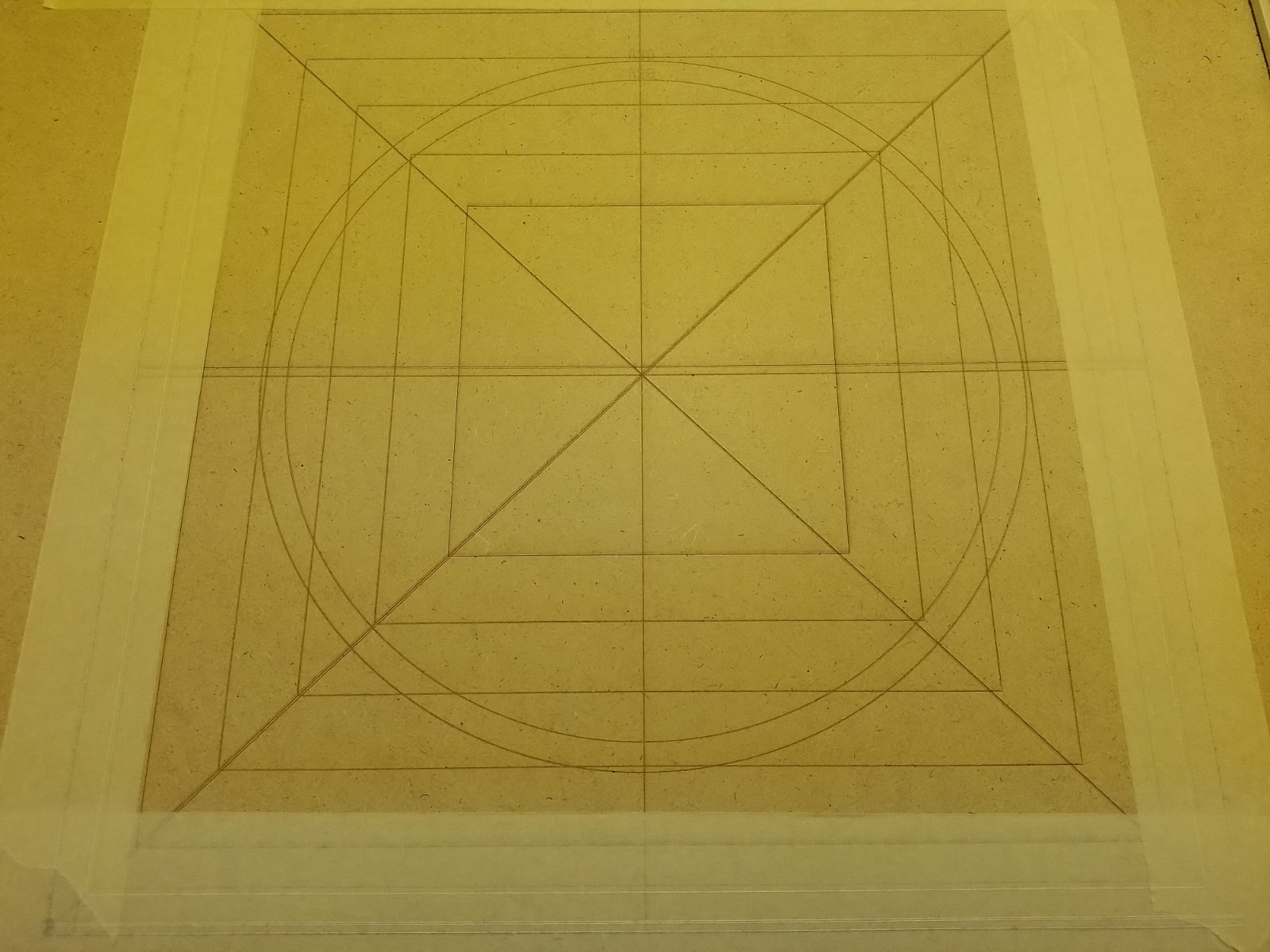

After that through different files and runs diagonals were drawn and also a cross trying to get ti the exact center of the workspace but if the lines were drawn individually they would very visibly miss their expected position (case with the line going on the X axis that was placed in the center of the LightBurn coordinate system missed by going almost 1cm upwards on the Y axis.
So afterwards, working with smaller squares of sizes 375x375, 350x350, 250x250, 150x150 at 10 000 mm/min and 80% power the lines overlapped perfectly every time. Only that now the previously drawn diagonals did not match all the angles of the squares. And it occurred that after manually measuring all of these “squares” they actually went +1mm on the Y axis.

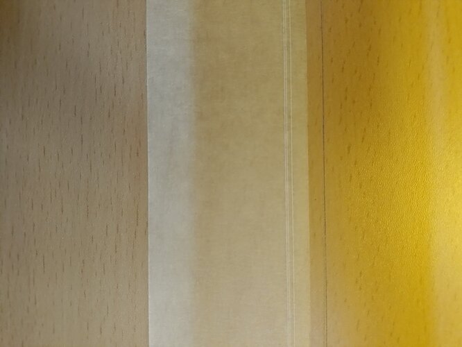

After placing some masking tape over the lesomal sheet to have visible markings after an attempt at slightly tightening a Y axis belt that seemed a little looser all the squares overlapped perfectly also in bigger sizes, only that now through the masking tape it was seen that the lines do not overlap even if the same dimension was specified and to top it all of after a couple of perfect runs one of the squares was cut shy of aprox 3mm along the Y axis.

Home the machine, then run a circle in a known location. Center and corners perhaps?
Do this 3 times, and see how they line up in each quadrant. Is the drift in one axis, or both axis?

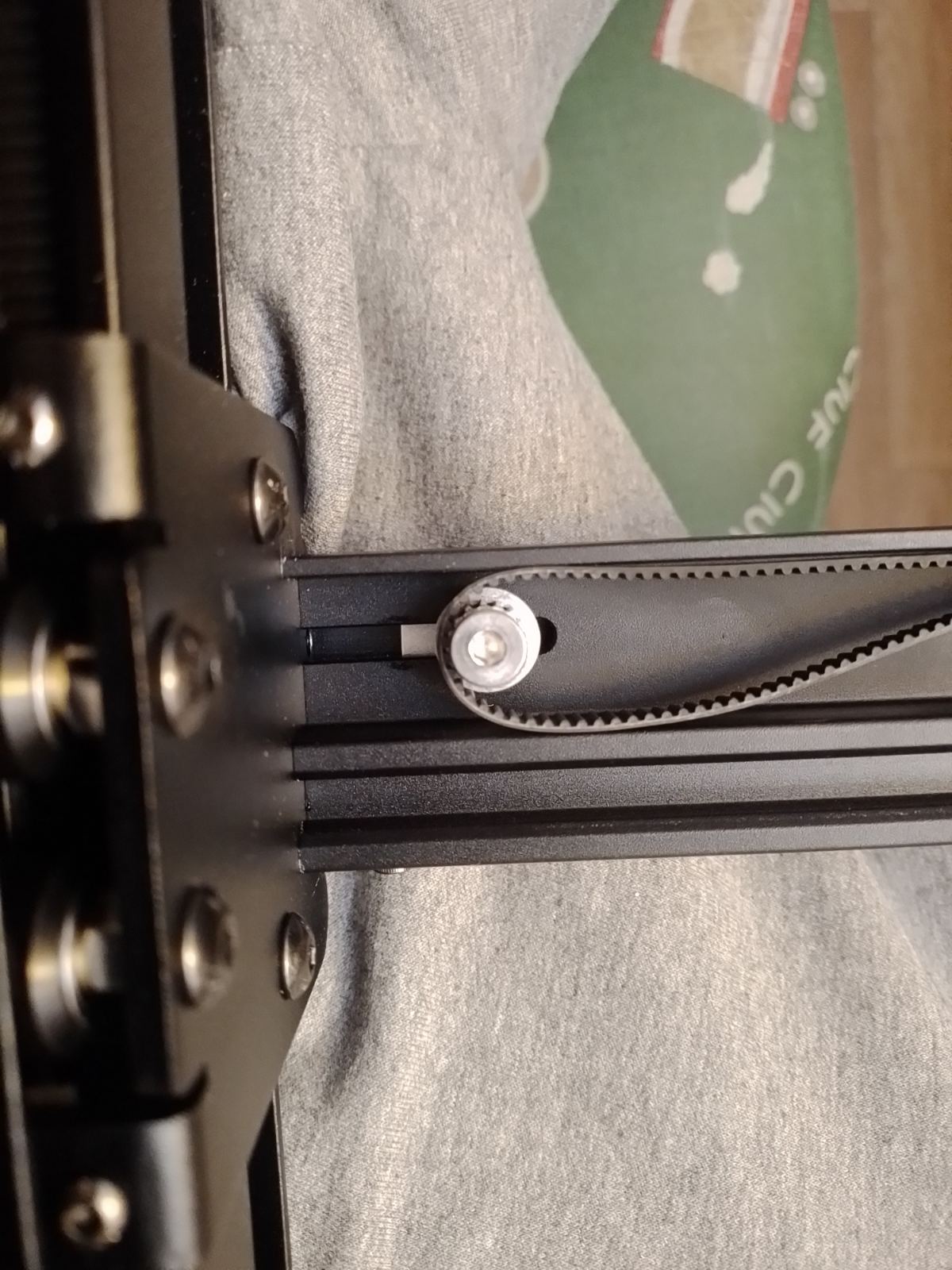

The one horizontal line that is off axis in the photos you attached is interesting - I wonder if you had some belt slippage, or a loose drive pulley on the Y axis. How far apart are those two lines? 5mm?
So the space between the two lines is about 4mm and note that the line was drawn in a separate file that contained only the line itself differently from the file in which it contained the full rectangle and the vertical, horizontal and diagonal lines. In short if all the geometry is not done in the same file or same run/pass it wont align. As for the noted offsets, slips and errors they happen mostly on the Y axis but sometimes there are some X axis slips or irregularities (maybe they are caused by the Y axis slips?)

As for the files with the circles, diagonals, vertical, horizontal and full workspace square they were done at the 20k speed and that did seem to challenge the machine itself for such a high area. As for the smaller squares they were done at 10k speed and the results appeared significantly better apart from the offset from the Y axis adding the +1mm and when doing the testing on masking tape it did not overlap with those same rectangles drawn on the sheet and it did give a sudden -3mm when drawing over the masking tape so it seems as there is surely something wrong at the Y axis combined with the foul settings. When testing also small text writings on smaller areas it did not miss the text even after multiple runs. The machine is in an enclosure and the sheet is pushed up to a corner of the enclosure, as for the stability of the workspace it is generally stable but the sudden movements may have contributed to some slight wobble.

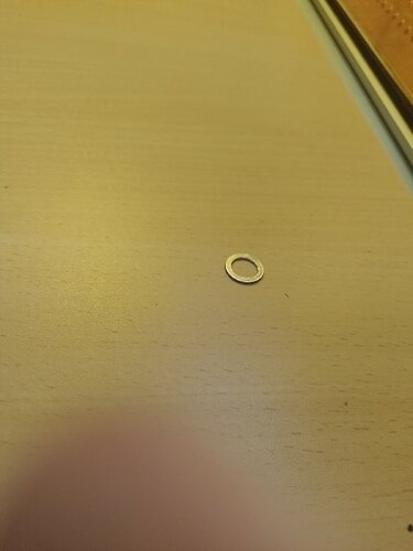

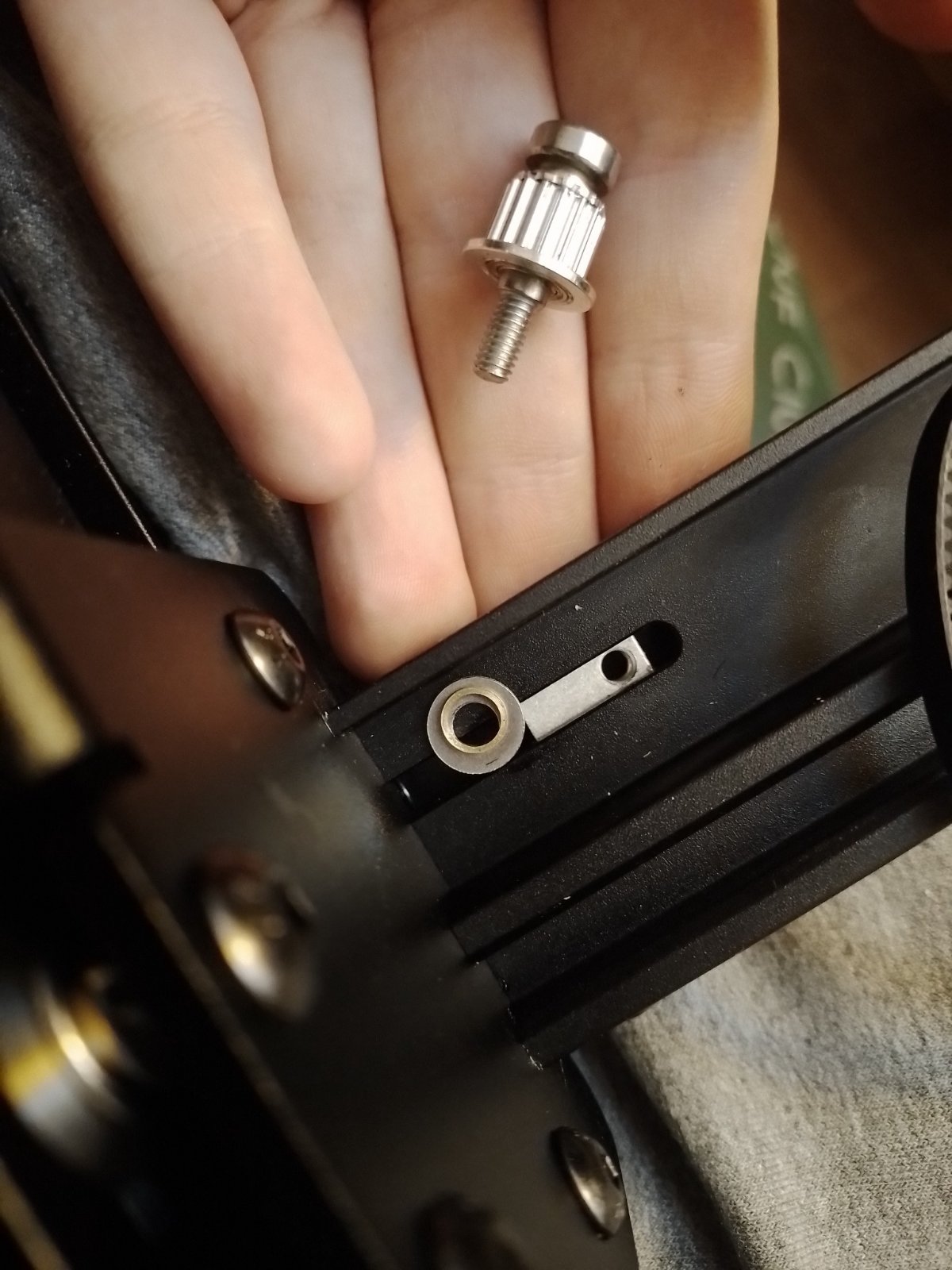

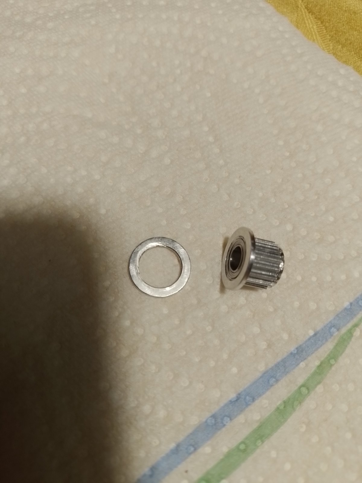

Those pulleys never come as a 2-part item. That one is defective and must be replaced.

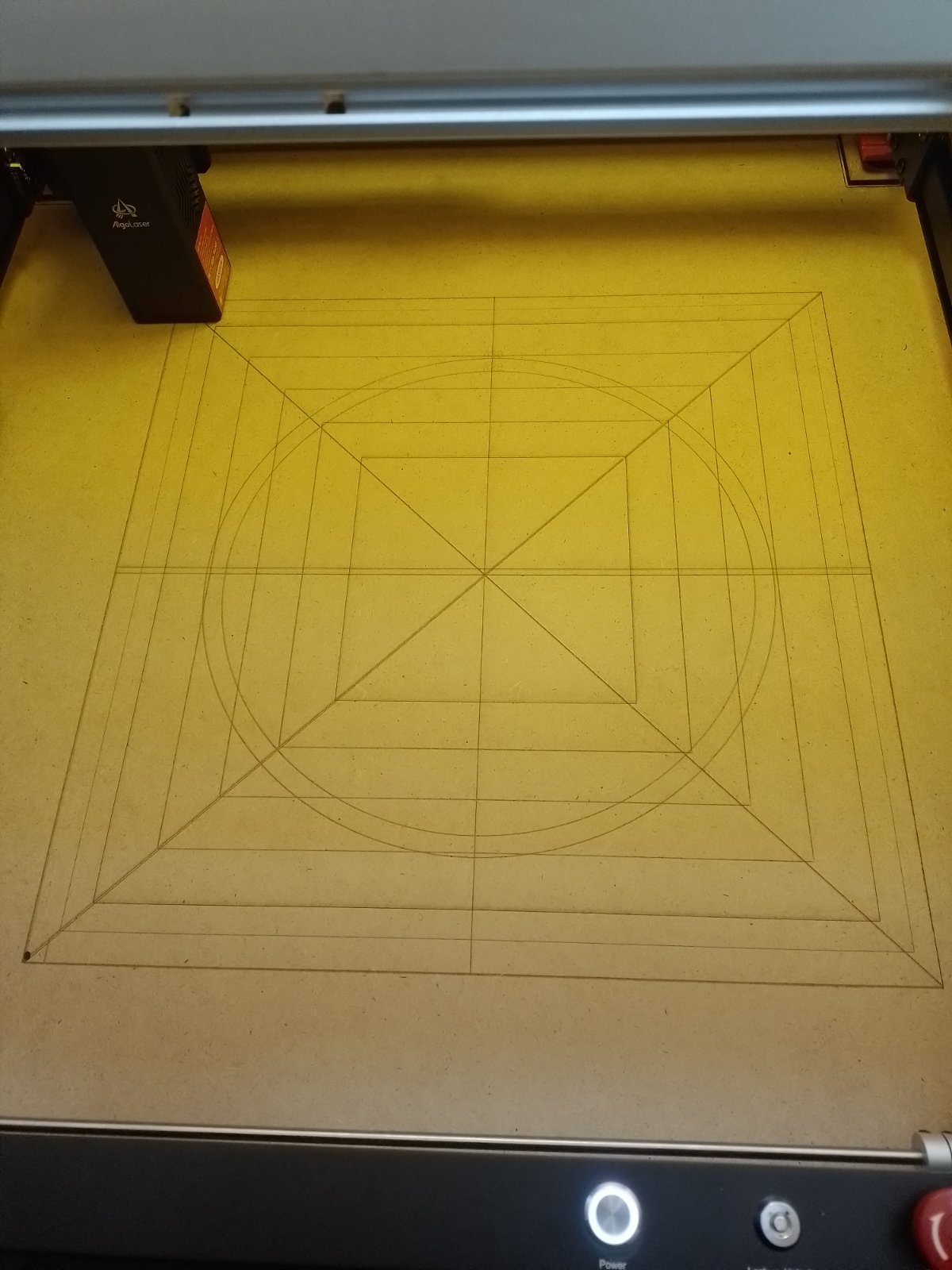

Okay so the pulley has been replaced, all the belts tightened and machine factory reset so after drawing the full workspace test square a couple of times all the sides match except the lower one on the Y axis that misses by around a mm each time. At this point it might seem controller/software related? Also during this same session of square runs a slightly smaller square was made and it has done ok. After finishing a job that required raisers and moving some things around the machine was replaced with the original feet in the same position with the small feet holes. After running the small square it hit all the side except again the lower one, and after starting the full workspace one as the machine first moves from X:0 to X:399 and then comes back firing the laser to X:0 during this session it would always stop at X:0 and emit an error beep and the lightburn console would display: ALF 122.
So even if jobs should not be done too close to the border as it could trigger a soft limit in the overscan move are these misses on the X:0 - x:399 line normal and could there still be some underlying errors or problems related to the controller/machine?
Here is a related image
If you look at the GCode output, you will see X400.000, not X399.000, in the code. It is not Lightburn or the controller. What you are reporting is an error of 0.25% of full travel. I am betting that is well within the design specifications of the machine. It could also be a measurement error. You said smaller squares measure fine, so I would not think it needs any more adjustment..
