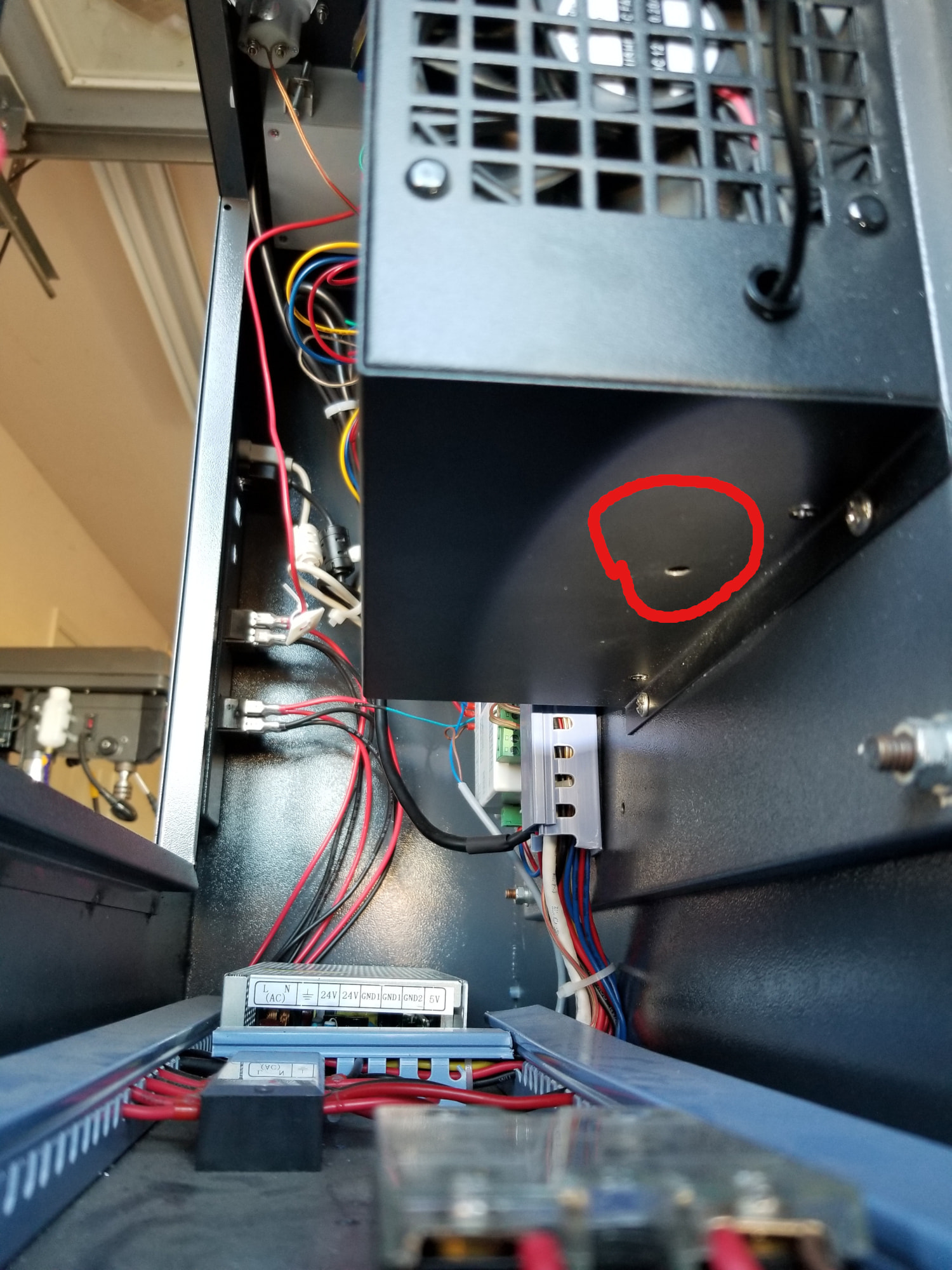

In my machine you have to be a contortionist to adjust it.. I hate doing it because of how uncomfortable it is… Also mines on the bottom and the 20 turn pot is a bit inside of the hole. More difficult to get your screwdriver into the pots adjustment slot.
You can adjust for maximum current or maximum watts out. Mine is currently configured as watts out, not current. I know mine hits it’s full rated (working current) output at 13ma. At 100% power I’m getting 50W… I find it more easy to figure out what I’m doing.

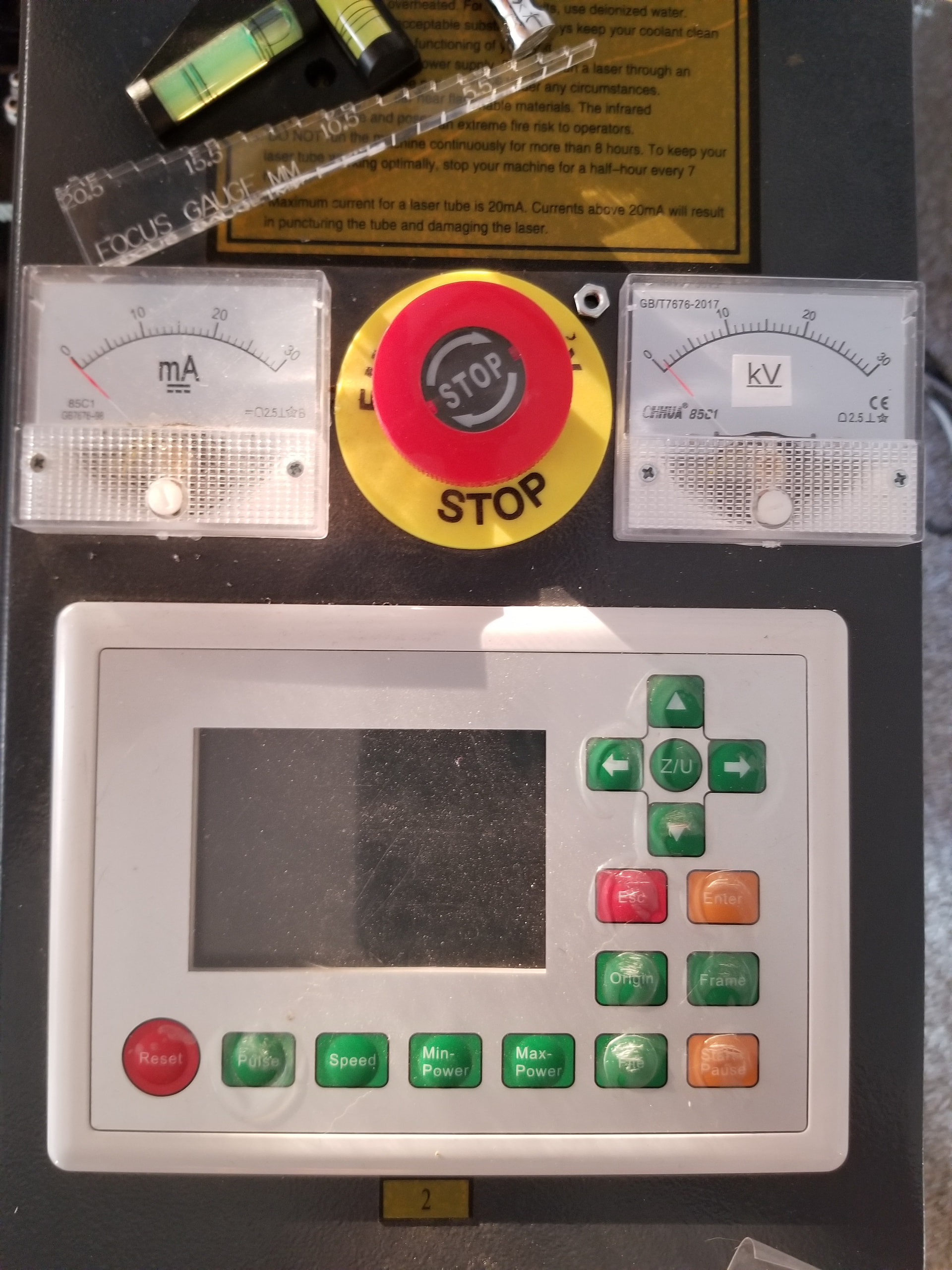

Do you have an external ma meter?
This is my console, the ma meter is on the left, the right one is a volt meter.

My machine has a ma meter, but no voltage. I do have several fluke meters and scopes, but the highest DC one I have peaks out at 1500vdc. If I want to verify the onboard ma reading, my only option would be isolation/inductance

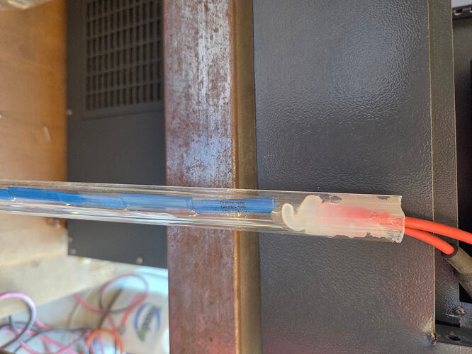

The meter has been modified, or I should say the encapsulated resistor failed. I can only assume that the epoxy filling shrank or grew enough to break the connection. I doubt your ohm meters can measure 600 megohms, none of mine can.
Made a very similar one with flat pack resistors with only the hot end insulated with silicone.

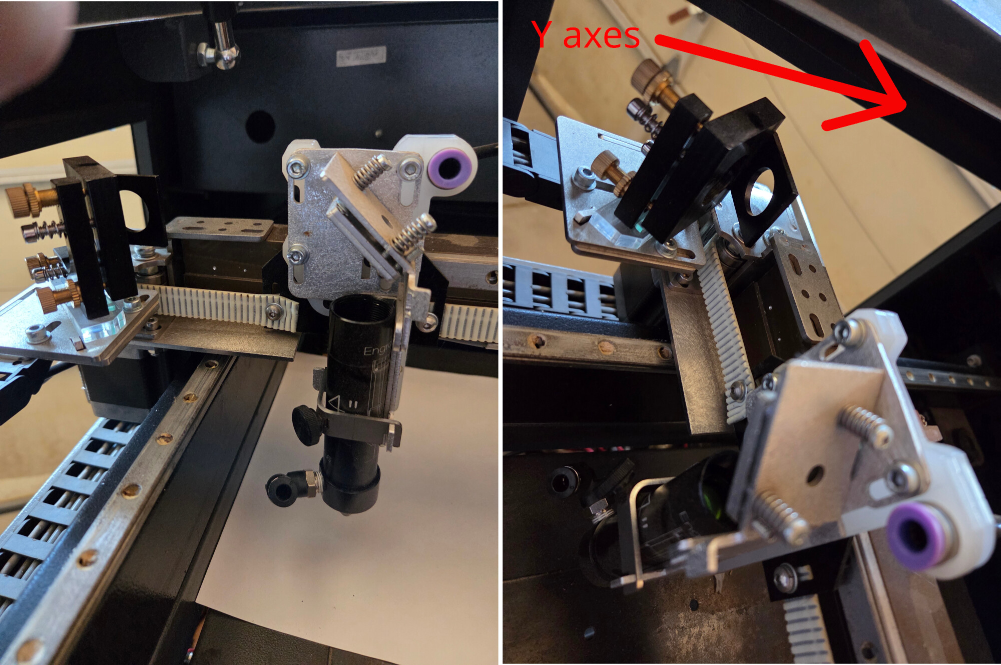

Found my issue. I still had an allignment issue with mirror #3 to lens. Up and running correctly now… i also set max power output from the main power supply
Chock it up to learning. We have all had, at one time or that other, frustration while doing an alignment.
