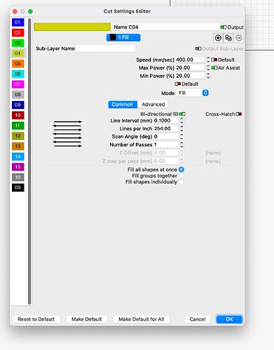

Is this what you meant about line spacing? Should I bring down the line interval and bump the lines per inch up?
Henry
What interval are you using?
Most co2, with stock lenses, struggle to get a 0.20mm spot, limiting resolution to about 128 dpi.

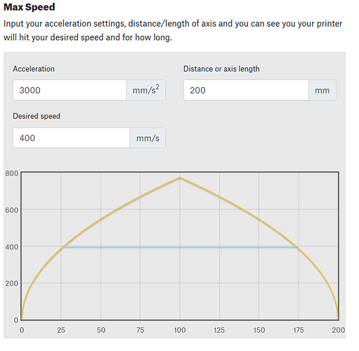

You might want to limit your speed, for more than @ednisley mentioned and ensure you’re using a reasonable interval for the response time of your lps…
The minimum response is usually placarded on the lps and is usually 90% output voltage <= 1mS (1/1000 of a second).
If this is the case and we use the worst case 1mS value…
Running at 1000mm/s will allow you to toggle the tube every mm, the best resolution would be 25.4dpi…
If you slow down the 500mm/s, it can react twice every mm and the best resolution would be 50.8 dpi…
Just keep these in mind… hang in there, I’m sure you’ll get a handle on it. I’m with Ed, I think you need to slow down a bunch. You can figure out how much room it takes to accelerate to maximum speed using the calculator.
