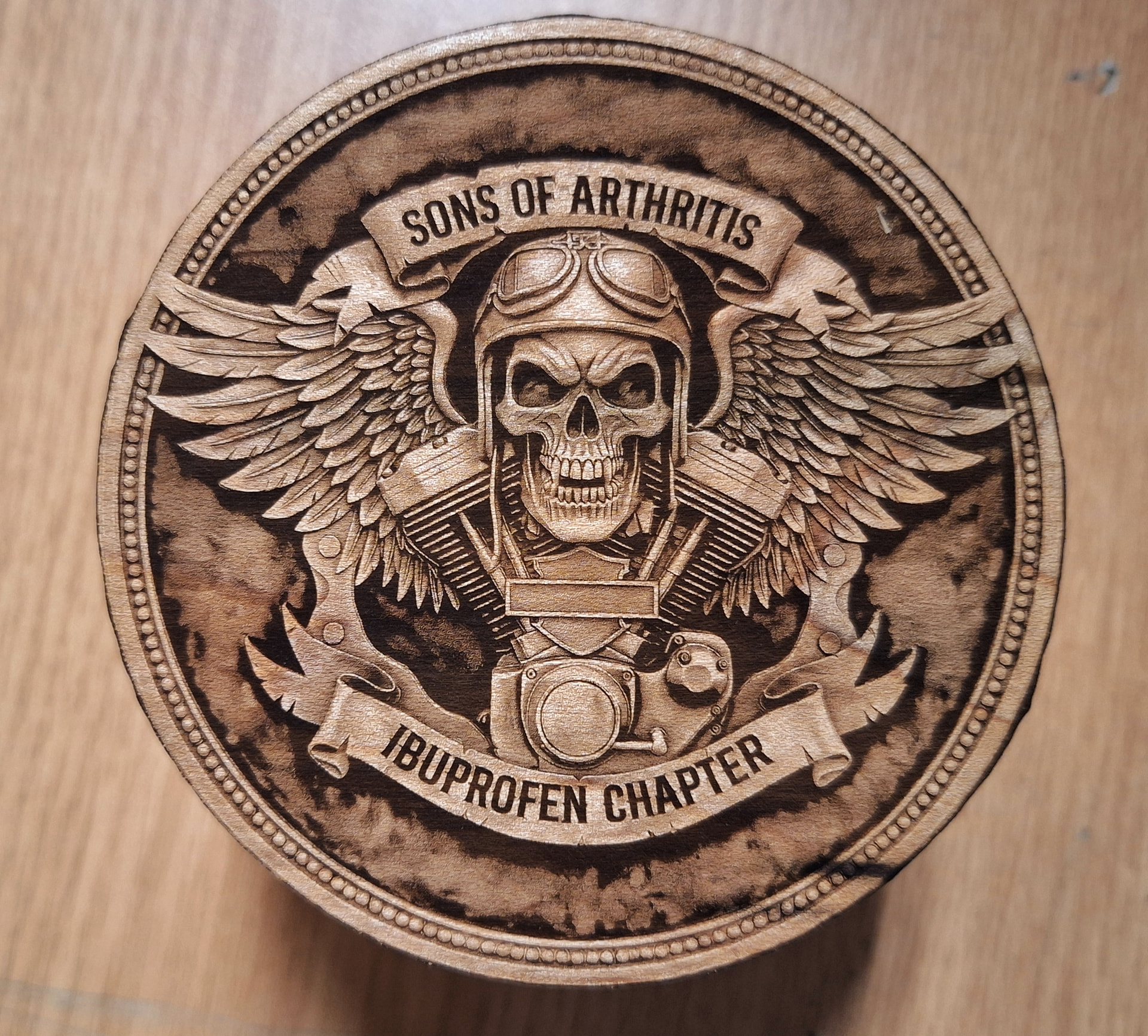

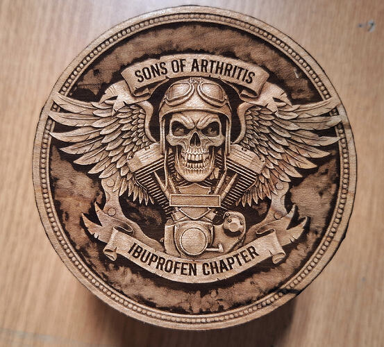

0.5 mm Black satin Business cards
1000/28%/120kHz/100ns
Stucki Dither 520 DPI
0.025 Dot correction

I’ve been staring at the jarvis/stucki dither examples.
The shadow of the hat is really needed as part of the photo, but it’s almost eliminated with Stucki… I like the range of the Stucki better, but I think the shadow is an important part of the photo…
What is your feeling on this difference?
Its really a deep Rabbit hole
I,ve found that it ALL depends on photo and how it was processed

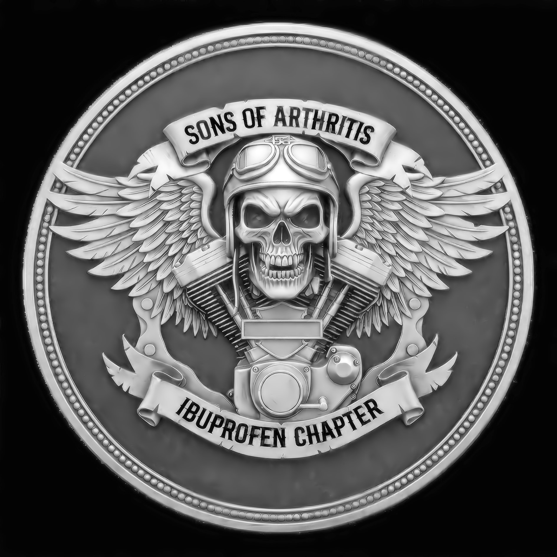

95% of time I run through Gigapixel first
I,ve also found IMO that the DPI I choose to dither in
The photo I use has 2X that dpi
So if I use stucki at 508 DPI …I insure photo is 1000 DPI
