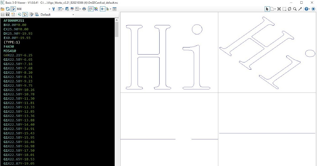

Why do I get Error Code 11, i’m etching text generated in Lightburn, the error occurs in the same place on the second letter every time. When the same file is exported as G Code and run in Laser GRBL there is not a problem. I do need to run it through Lightburn as it has more controls than GRBL, can anyone assist.

I don’t see a flaw in the Gcode at all.
Can I ask which VIGOTEC engraver you’re using?
Have you reflashed the VIGOTEC controller to run standard G-code?
Vigotec uses a Proprietary version of GRBL and I believe this is the source of the error:
I do not know why you aren’t having problems with LaserGRBL. Problems ‘should’ be occurring there for the same reasons unless you’ve addressed this somehow.

The two welcome messages are the same graphic run 1 after the other, after switching off some of the layers, to show you the different errors, this time 24 & 2, I did mention this in the related message. Does this give you any more of an idea, as also mentioned if you want i can send you the file.
As mentioned yesterday, I tried running a file (again text) that was generated and engraved within Lightburn without any problems, now comes back with error 24 at line 35.
I saved as g-code, loaded in to bundled software LaserGRBL v4.8.0, and it has run without any problems. Would it make sense to try to reinstall my machine in Lightburn in case something has gone wrong during the 2 recent updates as this is when the problems have arisen.
