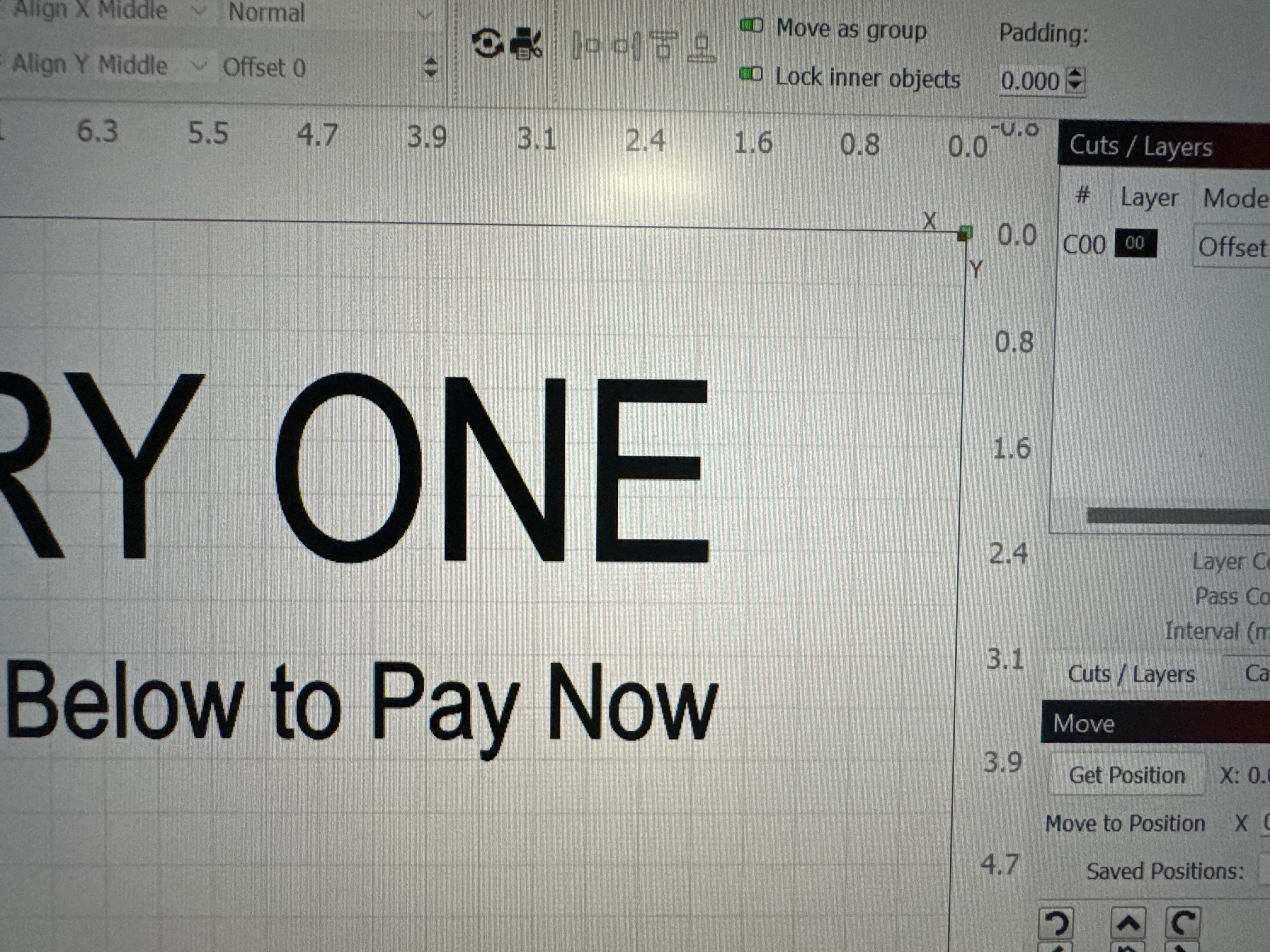

The issue is, when in Lightburn the project is 1.9” from the right, on the laser bed it starts 3” from the right which obviously creates issues. I did a lot of reading and tried the resolution of using absolute cords (prior to this it was printing 6 to 10” left, so much so I couldn’t get the entire project done because the left section was cut off. ). At least I’m only off an inch now. But this has to be some sort of setting right? It doesn’t make sense to have invested thousands into this and not be able to align the bed measurements with the lightburn measurements? I really hope is stupid simple and someone asks me, did you enable this in settings? Boom fixed. It’s weird I can’t find this exact topic online, But I suppose that’s why this forum exists.

It’s not clear what you’re trying to show in the photos.
In what way is the position off?

My apologies for not explaining well enough the photos were showing in Lightburn the words were 1.9” to the left of the right side but the bed is 3”. So it’s off to the left by 1.1”. I have not jogged to all four corners but I have seen it in all four. I will do a thorough check based on your advise. I think the bed is static tho so I don’t think it could be off by so much.

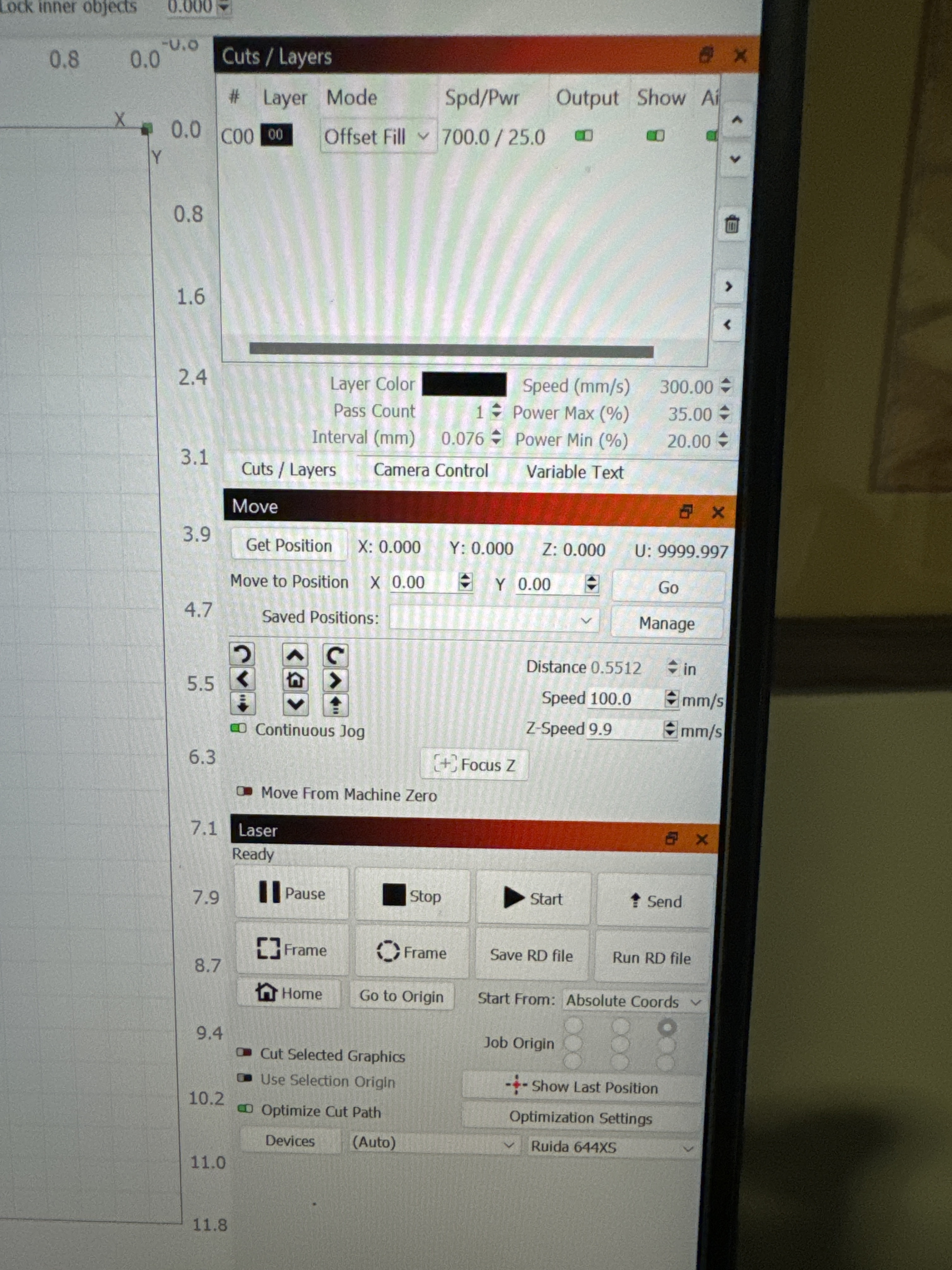

I do notice an option under move that says move from machine 0 which is off. Also worth mentioning during my attempts to resolve the issue I had read setting the laser options “start from” to absolute cords. That prob doesn’t matter.
I assume this being off 1.1” shouldn’t be able to happen at all? It doesn’t sound like it couldnt be anything I have done or failed to do in setup? Calibration failed or something? I’m gonna include a pic showing the right column of settings in case it might show you something.
I appreciate your help. I am getting frustrated. I always end up with the problems that shouldn’t happen but do because it’s me lol. Ugh. Hopefully you have an aha moment and help me resolve it :-).

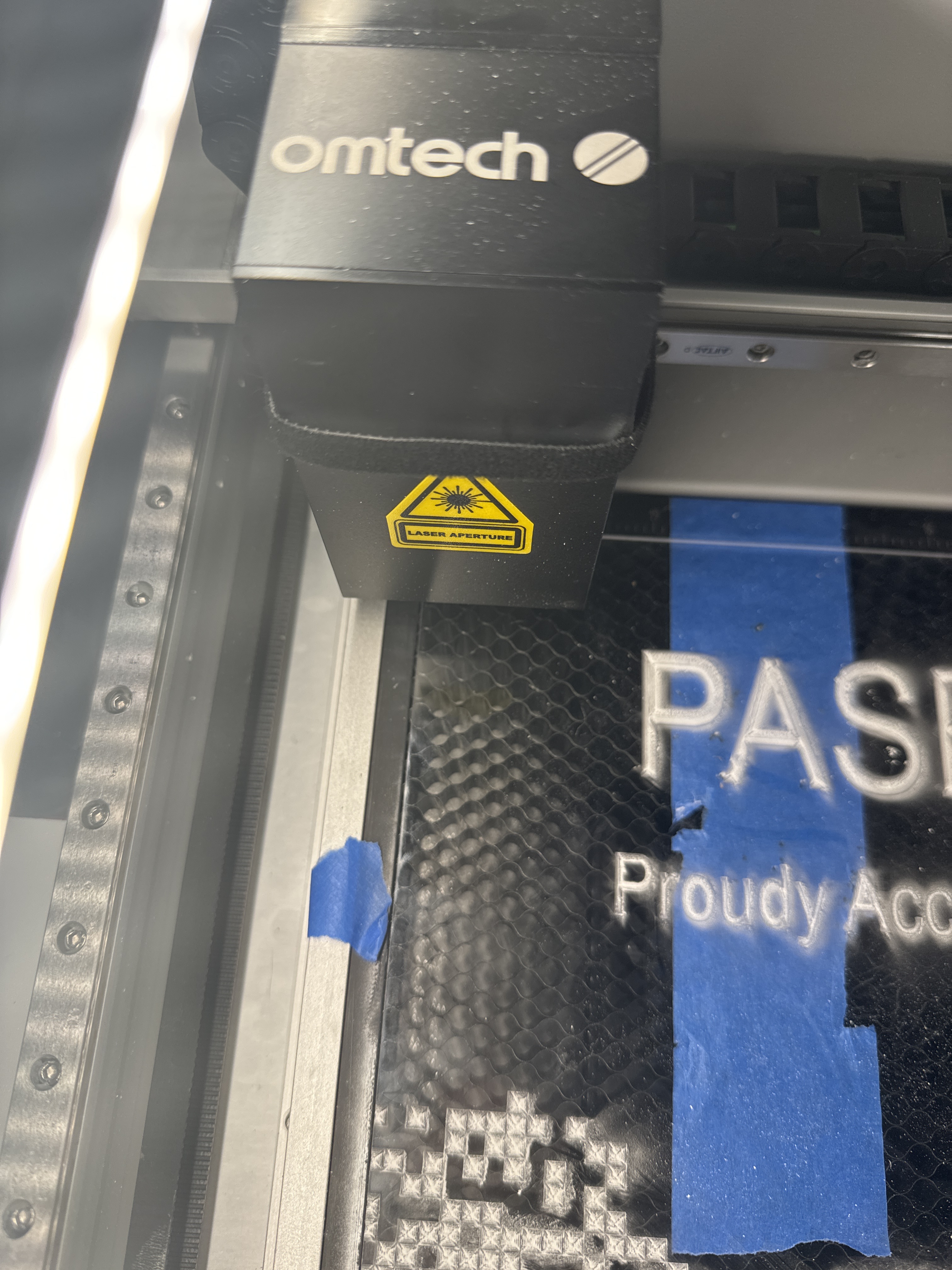

There is no collisions in any direction. So I will take that as a win lol. The bed top measurement reached beyond the 21” mark (the actual bed measurements should be PROCESSING AREA 20.1" x 11.8") to the left.
Going down the laser lands right at 12”.
That said, feels like that might be the issue? It’s going too far left to 21”+ which is why it’s starting at 1.1” to the left? How do I resolve that problem?

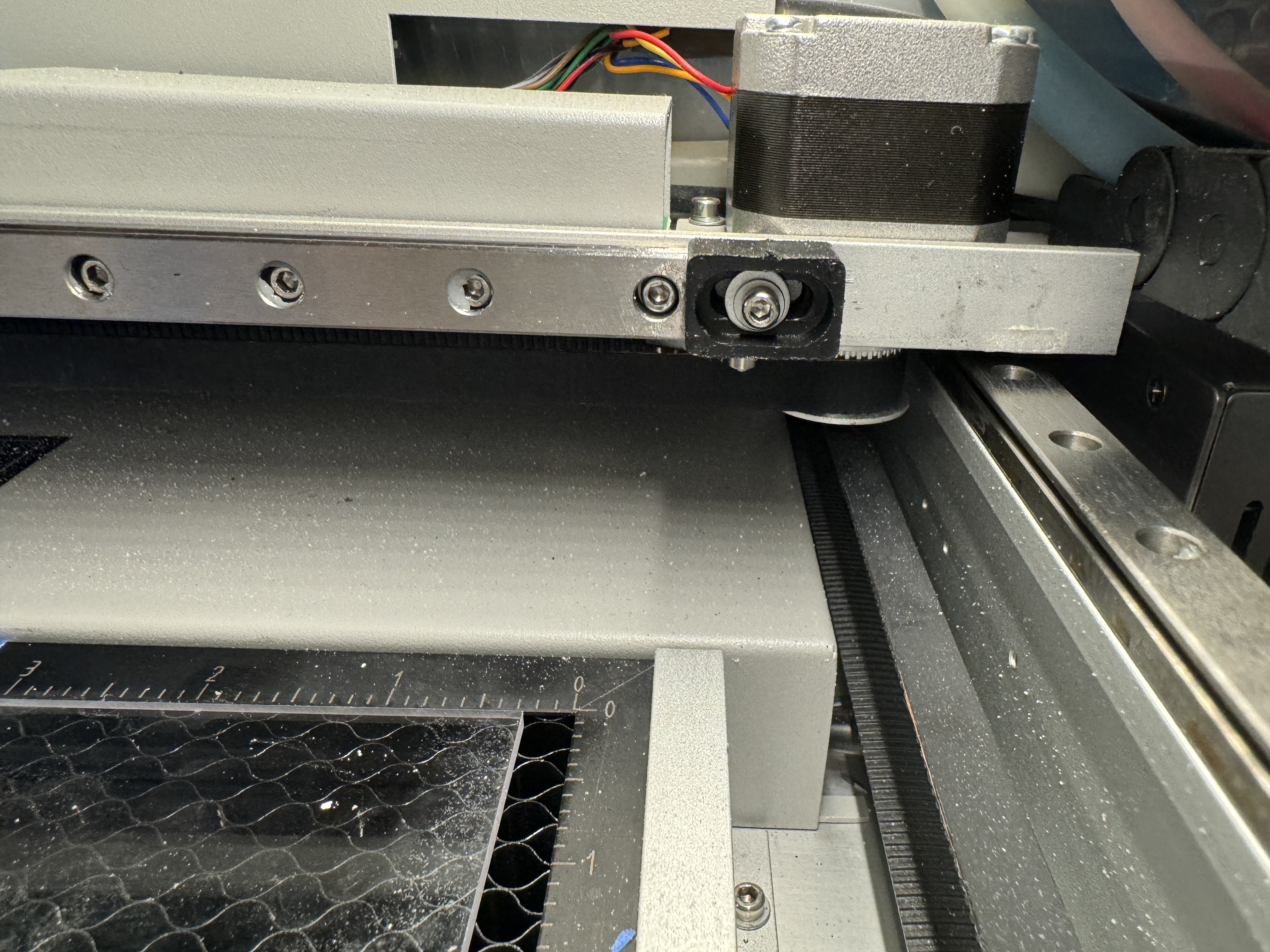

So that last inspection made me manually see if I could move the ladder farther right. I realized there is a bumper there. So I don’t think there is any way to get the laser to 0, however the bed goes to 21” left, seemingly to account for this. So is the drive rail mounted too far left? Or is the program not recognizing the shift. But why would they not just move 0 left an inch so it would be easy to understand? See the photos below showing location of laser while against right bumper as well as showing how close right bumper is to the edge of the bay vs the left bumper being farther out.
I suspect the measurement markers on the bed aren’t intended to directly correlate to addressable work area.
A few potential remediation strategies:
  1. somehow force a relocation of the bed
  2. relocate homing sensors or triggers
  3. change home offset distance in the vendor settings. Make sure you have a backup of the settings before doing this. There’s a risk that this will reduce the addressable area on the other end of the laser or potentially cause a collision
  4. cover the current measurement markers and “redraw” them so that they match your actual laser position
  5. leave as-is and either ignore markers or apply a mental offset. For reference, I have the same type of measurement markers on my bed and I’ve never used them.
I don’t know what homing sensors/triggers are. How strange of an issue. I appreciate all your time and assistance. You know when looking at the rail the laser is on, the stop on the side that is off (right) is closer to the bay than the other side. Almost like either the bay or the rail was put in backwards. But I don’t see any holes that are extra. I probably won’t ever be able to confirm that idea. lol.
The machine will have a sensor/switch that determines that something has come into proximity with it. The triggering component is usually some ferrous tab or part of the machine itself. There will be one set for X and Y.
This is what it used to home the machine and their physical location determines exactly where the machine stops after homing.

I got some hands-on with the Polar today. For certain the bed measurements are not intended to directly correlate to addressable space. They are simply bed markers.
