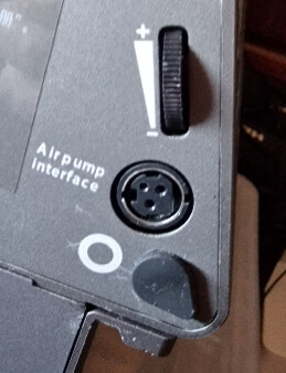

Gifted a Creality Falcon 2 Air Pump how to get it to work with Falcon 10watt
How do i get a Air Pump from a Creality Falcon 2 with a Circular connection to work with a Falcon 10wat laser, i though i could run a 24 line what the electomagnetic do not activate the diaphragm

I believe Creality has a custom connector that requires a Falcon 2 motherboard to work.
I dont think you can - easily - give it 24v unless you rewire it.

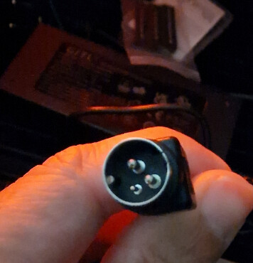

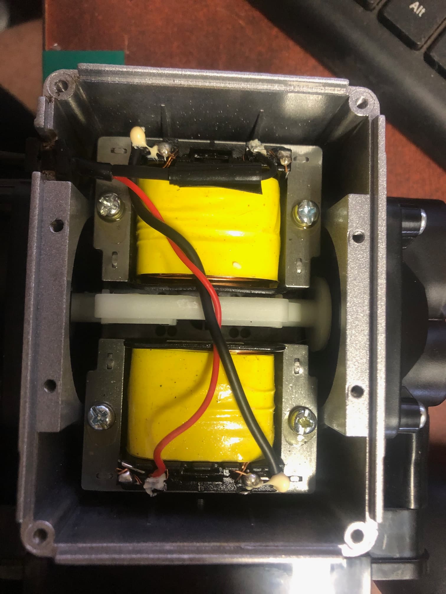

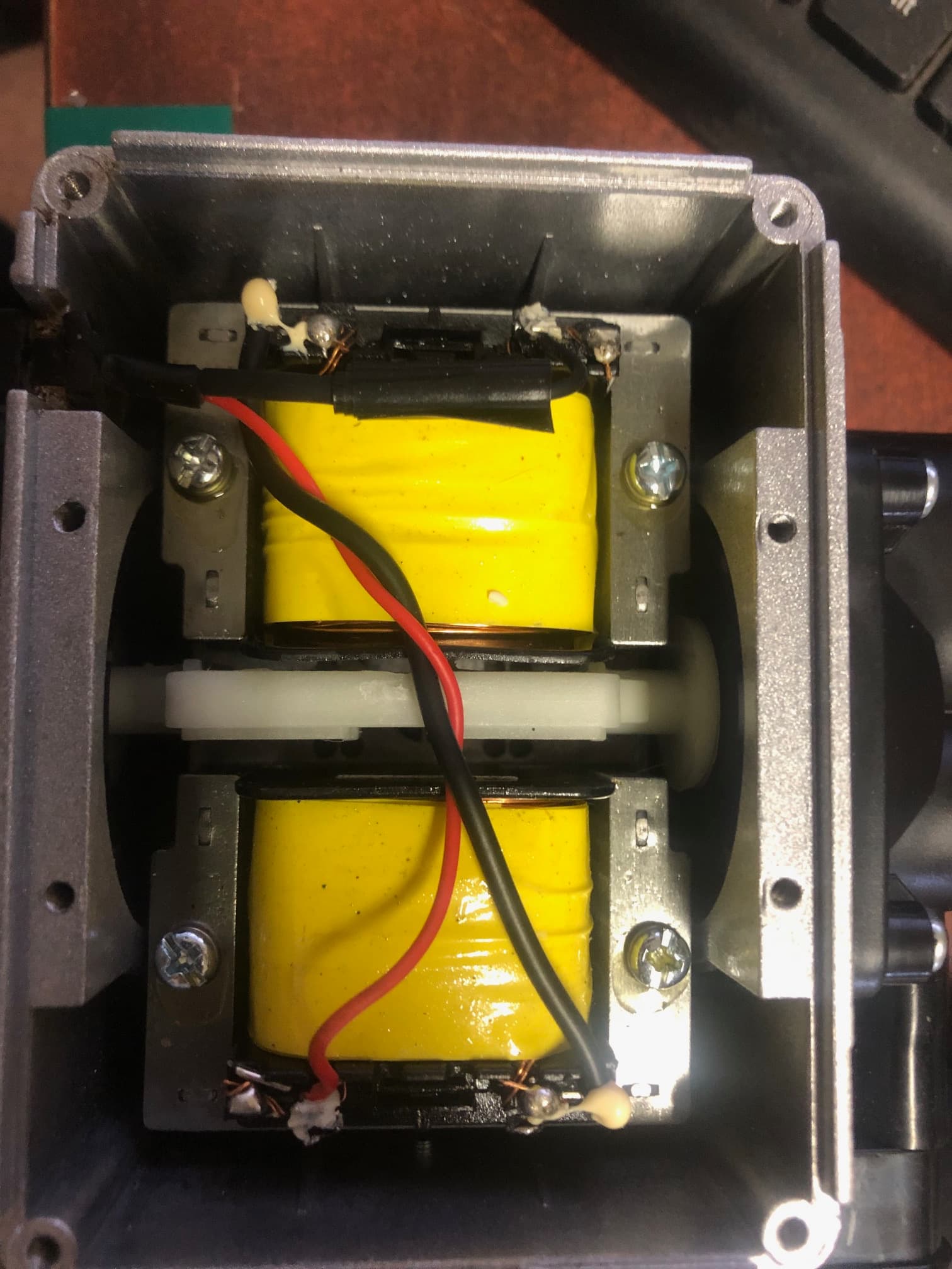

thanks i was looking how to rewire so that i dont have to worry about the circular connector cause i think there is a trigger in the 3rd pin , but the confusion comes from when i opened the pump there are 2 wires in but even it i swapped the the wires with a 24v power super direct i get a connection but no moven on the diaphragms, but on the falcon 2 there is no issue
THe problem is we are uncertain on what makes these “tick”
is it a modulated signal from the motherboard, a form of PWM? or a simple DC signal
Given the wiring i see it shouldnt be a simple 24v DC in signal

thank you appreciate 24v AC correct
