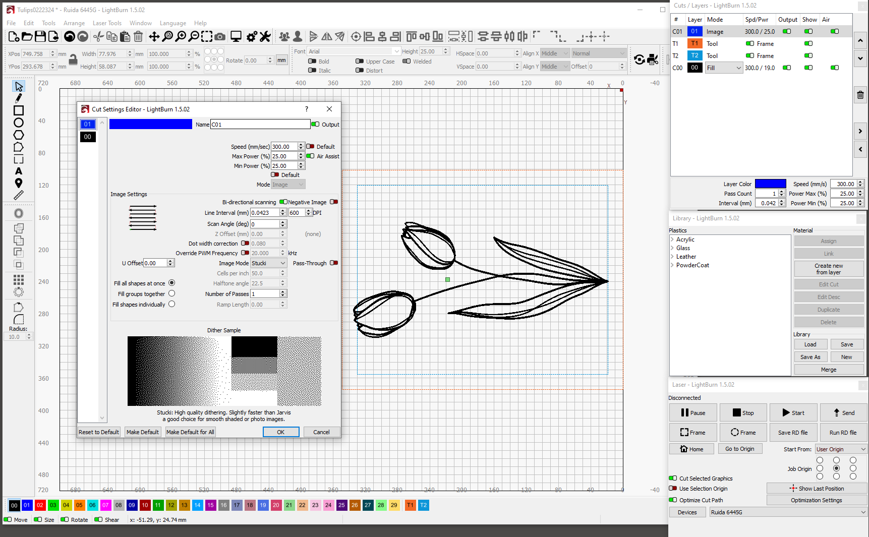

80 watt Redsail RUIDA filled line art engraving. I developed settings using test grids. No matter what I do, the edges always have some random blowout (clear glass broken away from main structure). What can I adjust to mitigate this problem. These are glass panels for cabinet doors with large grapics.

I confirmed with the glass supplier that this is not leaded glass. I have used engraving processes with and without dish soap to reduce surface heating. I ran multiple scenarios with LB test grids and a microscope to determine the best settings for my 80-watt CO2 laser with RUIDA G6445 control. The grayscale/image file gave the best results overall. However, all tests showed the edge blowouts as seen in the photo attached. The photo shows just a sample edge. These clear sections are very visible and are sporadically place over the whole graphic. They do not show up on the interior of the filled lines. The client is an interior designer and will spot a flaw like this immediately.

The cut settings indicate two active layers:
  • C00 = filled vector @ 390 DPI
  • C01 = Stuki image @ 600 DPI
What benefit does hitting the glass with two different versions of the same pattern produce?
The line intervals seem too small, given that the typical COâ‚‚ laser spot size will be on the order of 254 DPI = 0.1 mm. Smaller line intervals dump more energy into the glass under adjacent lines, which may contribute to the larger fractures due to localized heating next to adjacent cooler glass.
Perhaps a wider line spacing will reduce the chipping by depositing the energy along non-overlapping paths.

My apology for not being more clear about the history of this problem. I first started out with filled lines. When that did not work after many tests, I switched to an image file for testing. Dithering has helped to improve the quality of the process. I will repeat my testing with lower dpi. I see the results in your photo and that looks like it might be the solution. Have you experimented with defocusing for photo engraving on glass?

I suspect a dithered image looks better than a simple fill because each dot produces a separate glittery pit, rather than a trench. If that’s the case, then Halftone or Newsprint dithers may look better on glass than on, say, wood, because they tend to break up solid color areas; Jarvis (and similar) allow solid areas that may be overheated and spit out large chips.
With that in mind, a defocused dot may either produce a bigger pit (thus overlapping with adjacent pixels) or reduce the energy below the level where it damages the glass (thus producing no image at all). It’s certainly worth investigating, but it will introduce Yet Another Variable along with speed / power / interval.

First of all, thank all of you for responding with your suggestions. My image is a thick line drawing of tulips (about 2mm~3mm wide lines). It is about 12" x 18" and I am processing the image along the x-axis at 0-degrees with air assist. I am about 90% successful right not. I will employ your suggestions with both fill and image type files and report back. Thank you again.
Newsprint setting did the trick. I will play with power/speed a bit more to see if I can get a deeper frost appearance. Thanks again for all your help.
