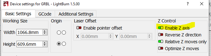

when I move my laser to the starting position via the “Go to origin” button to get to my workpieces, the set focus (“Autofocus”) is also moved to an initial position. Is this normal? Is it possible to turn this off?
I don’t want to readjust the focus every time I insert new material.

Disable this and see if it works.
