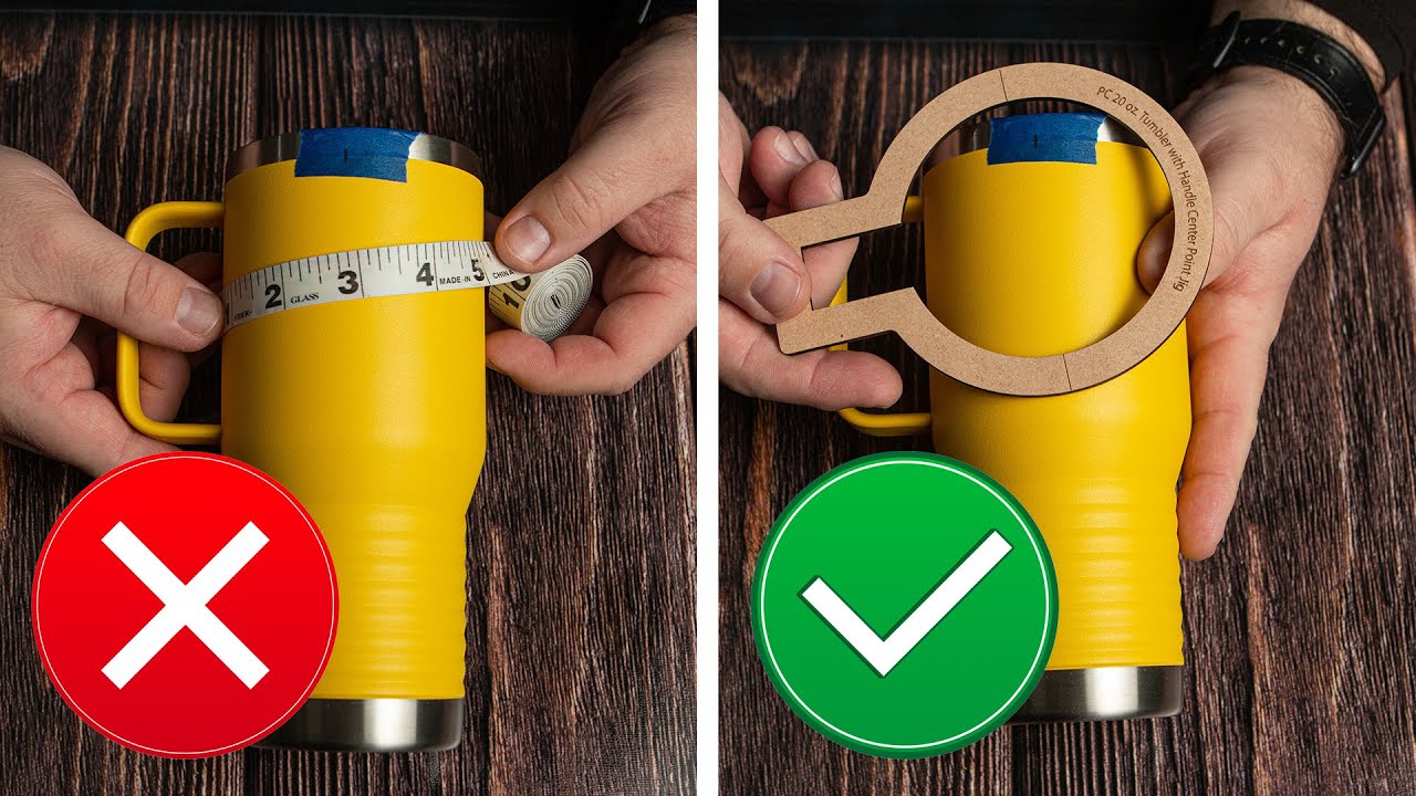

Make yourself a jig similar to the one in this guys video and use painters tape on the cup before you mark. Faster to “clean”
Video is for a large tumbler with a handle however the same principle applies to your mugs.

By having a template it will allow the engraver the ability to mark in the exact same place on multiple mugs.
This is useful when you get a large order (i.e. sports team, promotional, etc)
Framing is great on single items however repetitive engraving without a jig will be affected by human error of not remembering exactly where the last cup started the engraving and getting mismatched end products.
