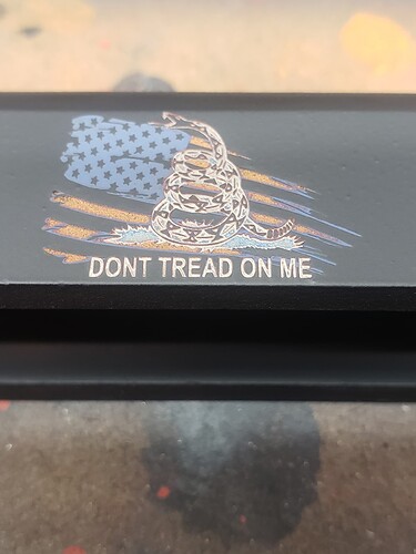

Gold and Black Glock Slide Laser + Cerakote

That is gorgeous, what is the process?
I’d tell you but then…You know… :slight_smile:
Ask lots of questions here and LMA
Pick the most complicated vectors imaginable.
Dial in layout.
Typical Cerakote 2 color (with out the stencils), prep, spray gold, flash cure, spray black, full cure.
Do a test block same time.
Practice on test block.
Stress out for a day or so.
Use parameters from test block to burn slide.
Have a cold one.
Show off photos!
Test block:
3 color experiments:

1911 slide castings are 15-20 bucks on Sarco, need to block or smooth a little bit but good for practice. Can’t find Glock practice slides.
What make of laser? Diode or Co2
60 W JPT M7 from XT Laser
Using a very low setting though so about anything that can scan at 0.01 spacing would work.
