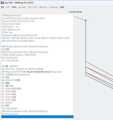

Here is the sample

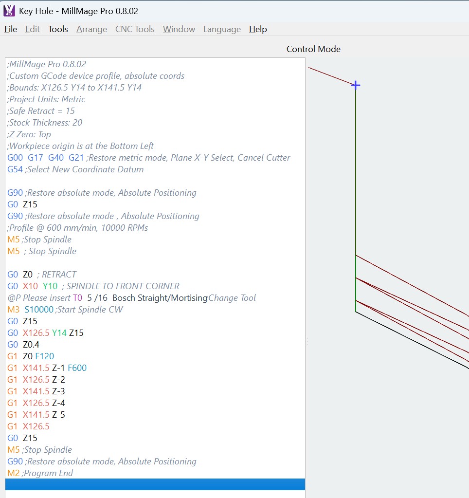

Fair enough request. How about you upload your offending .mage file and I will see what it outputs on my system with the steps you describe?
Hi Mike,
As requested here is a file from a .mage file from my machine.
Key Hole.mage (4.8 KB)
Mark
Here is the GCode created by my system.

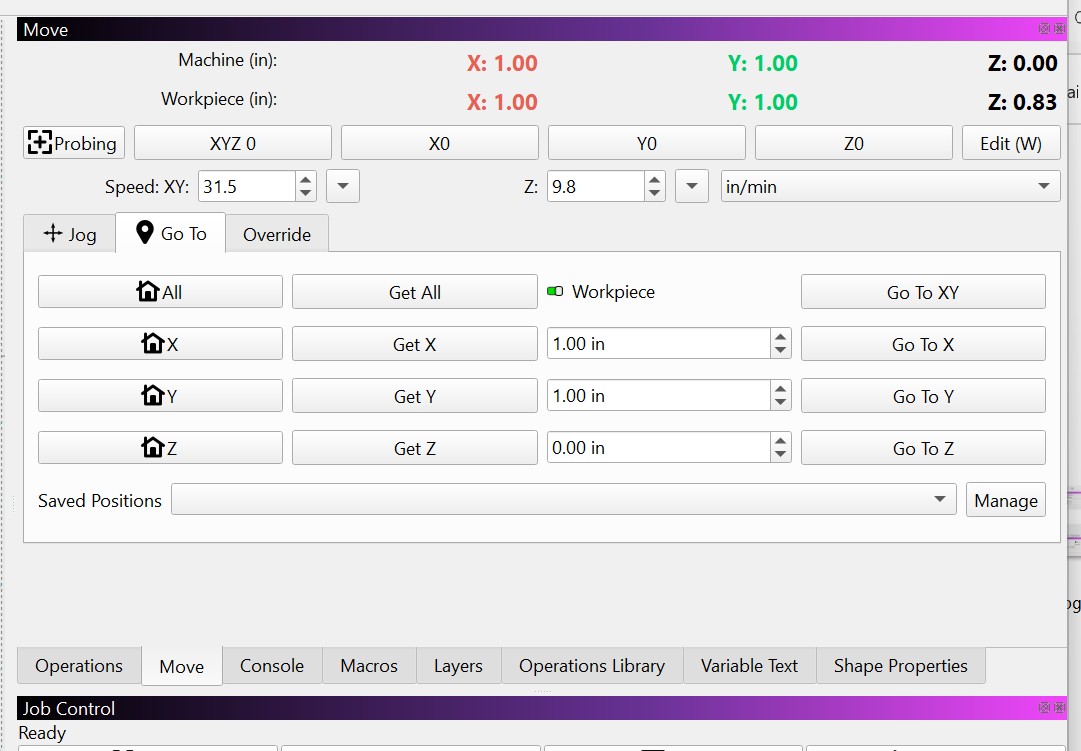

The problem is on the Move panel…
The “Go To” buttons are not working.
Yes, I know. Testing now…
This is the Go To 1" in X&Y…

?<Idle|MPos:25.400,25.400,0.000|FS:0,0>
Just so you know, you can enter commands in the Console window one at a time for testing. It is possible the GCode output may not match the manual commands, depending on the flavor of GRBL device selected. I expect just plain GRBL would be correct for your machine.
When I enter GCode in the console I get the correct response. It’s just the buttons.
The values zero out before sending to the machine.
Mark
