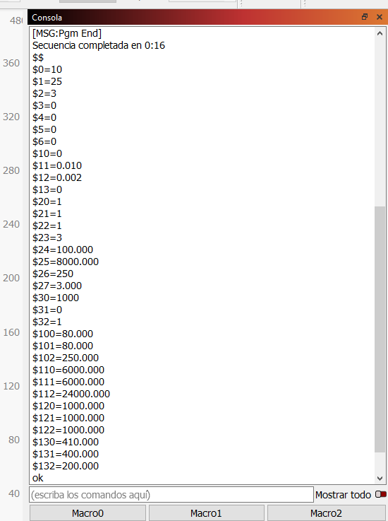

Graba al reves en espejo
al principio no tenia problemas, pero ahora cuando voy a grabar un diseño, en pantalla esta bien, pero lo graba en espejo, para que grabe correcto, en pantalla al diseño le doy a seleccionar todo, al icono espejo en la barra superior de herramientas, se gira en la patalla de visualizacion y graba correcto.
¿Como se corrige, o que comando hay que usar?
Gracias y saludos

To begin with, close all the side windows until the “console” window occupies, from top to bottom, the side of the monitor. Type $$ in the console window.
Then in the menu bar select edit - Device settings and center the “device Settings” window as in the image in order to be able to see the rulers on the desktop.
Take a print screen and paste it here

What origin did you select in laser window? Make sure it’s bottom-left as well.
You have $2=3. That should be 0. Check here for all values: Firmware Update & Settings - Diode Laser Wiki
If this is the problem, when you move the laser head using “move window” buttons the Y axis should be inverted. Is this right?
As OP doesn’t complain about that I assume there is nothing wrong with X and Y direction… :thinking:
Correct. But if he has a stock S9, the value must be 0, or he did something wrong. I guess he accidentally changed that value and never tested the manual move buttons.
