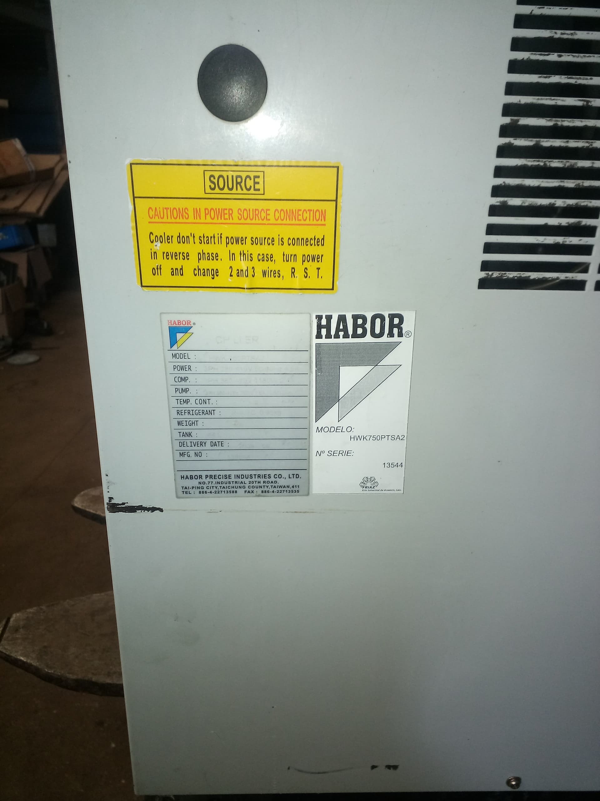

What I intended with this was to create a label with a representation of the brand’s logo in gray scale where I would also include the model and serial number of the machine. This is because I maintain many identical machines that work in very dirty environments. So the customer regularly uses a cleaning product that must be identical to the thinner because it erases the data from the original labels, this is when they do not paint the devices including the label. Just seen. ![]()
Because of this, the maintenance history is lost because it is impossible to identify the machine.
My idea was to create a laser-engraved label that would not be possible to “erase” with thinner or the type of product they use to clean machines. It doesn’t work if they paint over it, I know, but fortunately they don’t do that on all machines.

1 - That has my first idea and still my goal but I have a lot of difficulty getting samples to test. Only in quantity, and then include the financial part of the company in the mix too…
Afterwards, my laser machine seems weak (not very powerful (5W)) for working with stainless steel, anodized aluminum would probably be more successful.
2 - Wooden labels were very well applied as badges saying (I’m an IDIOT) on the forehead of those who erased the labels and painted over them. ![]()
Not so much in industrial machines (milling machines) surrounded by oil vapors, filings projected in an incandescent or very very hot state. ![]()
3 - I had some expirience with acrylic/plexiglass, it could be an option If it weren’t for the hot filings and solvents that will probably damage them.
4 - It’s the best idea I’ve heard so far. Furthermore, it is more affordable than having to make replacement labels even in euros instead of dollars. ![]()
