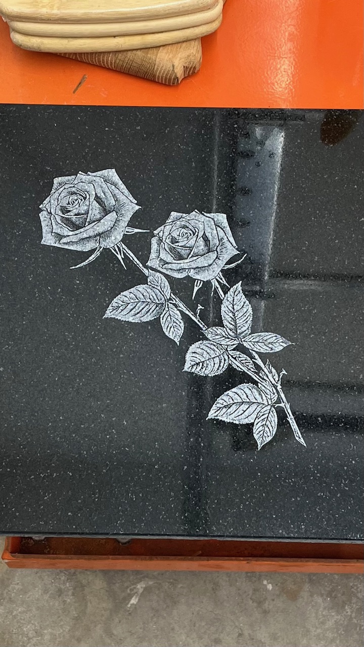

Hello: first time posting to here. This was done on an AP Laser SN4024 using PhotoGrav and Lightburn. I ran this at 7 speed with 22 maximum power and 17 minimum power, Jarvis Mode.
so beautiful
thank you!
