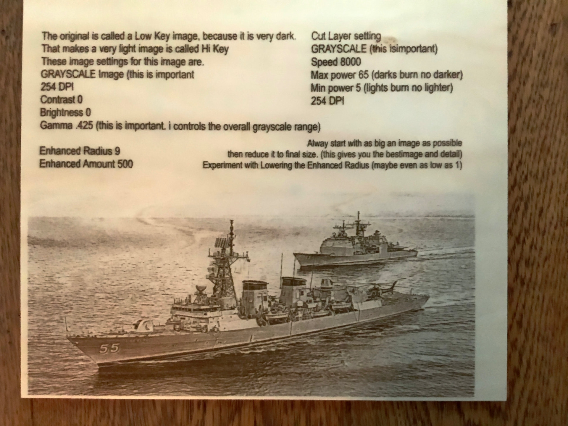

Output as Grayscale at these settings
A closer look
I will try and upload the file. It was created with version 2.1 prerelease 11.
If I can it will be warships.lbrn2
This very dark image (black cat crossing an asphalt road) is called low key.
A very light image (polar bear on snow) is called high key.
This Image is closer to low key.
The settings does a few things to adjust the image.
The gamma sets the range from light to dark original may be 100% black. And 0% light.
it is a straight line ramp from 0% to 100% black.
Changing it to .425 brings the black level down to a much lighter level, but retains the detail.
If you were to change the contrast you would warp that ramp form a central point.
Brightness moves that central point and moves it up or down that ramp.
As for the Enhancement (sharpness). Don’t know why the call it Enhancement.
The amount is overall sharpness you want.
The radius is a little tricker to explain.
The radius looks at a single pixel, each time you increment it you expand the that to incorporate another row of pixels around that single pixel. The system decides what the average density it will assign to this pixels. The bigger the radius, the more sharpness is calculated based on the amount you have set. Experiment around with the settings to see how they work.
Now for the cut/layer settings
Using GRAYSCALE
Speed will affect that you power settings are. These work for me, you machine will probably be different
The Maximum and Minimum power determines the darkest and lightest level you will engrave.
So 100% black and below wont engrave any higher than this setting.
This works for Minimum and does the same for the lightest area.
So a 0% and above wont engrave below the minimum power.
You can still apply any of the other styles Jarvis, halftone, etc.
If you can understand how all these settings work together, you have made dealing with images so much easier to get the effect you want.
I usually take select the image and do a test, stop and make a change then display and start off where I stopped. Take notes as to what you are changing. Do this until you have dialed in what works.
Then make a preset so you have a starting point for the next time.

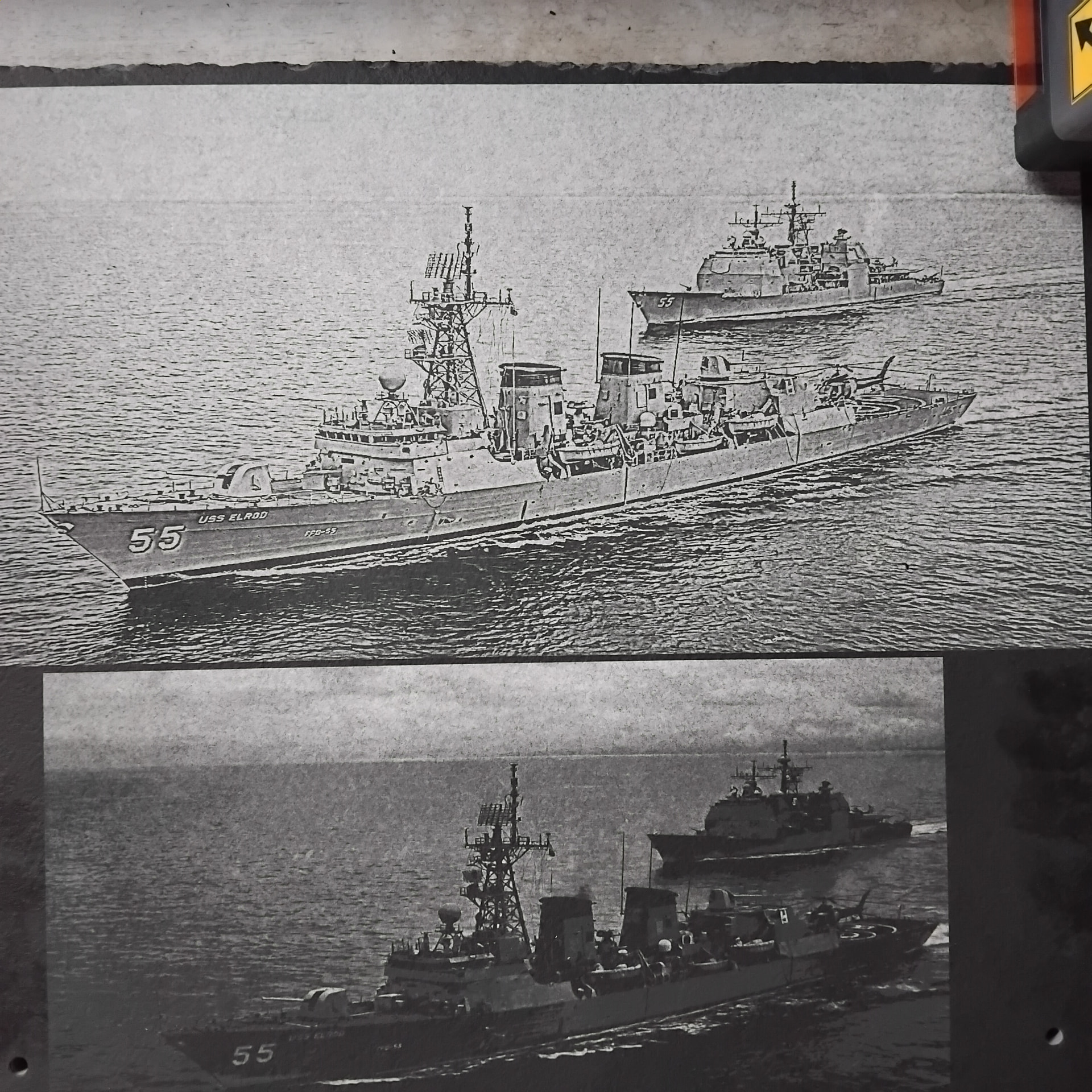

I did your warship on slate this evening but I reduced the speed to 4000mm/min and power to 14.5/Min ‘0’ (using 20w diode), I also set Gamma to ~(-750) Enhance-R (2), E-amount (400), Greyscale.
It didn’t look right so I re–set Power to 32%, Gamma 1,200, and it came out better but still a bit bright (missing the midtones), I may try again with Gamma up to 1,450, Time 1.37hr.
It could be done easier with Jarvis/Stucki but where’s the fun/headwreck in that.
You created some nice white-space in the image around the defined black lines and it assists contrast but your idea with the pixel dimm’s is really good and I’m trying to get that technique this eve.
It was late this eve when the job was finished so I left it in place with no photo as the light in the workshop was low so will do that tomorrow also.
Doing it on slate will definitely take adjusting the setting. Grayscale won’t work on slate. Slate is one of those materials that it either marks or it doesn’t,

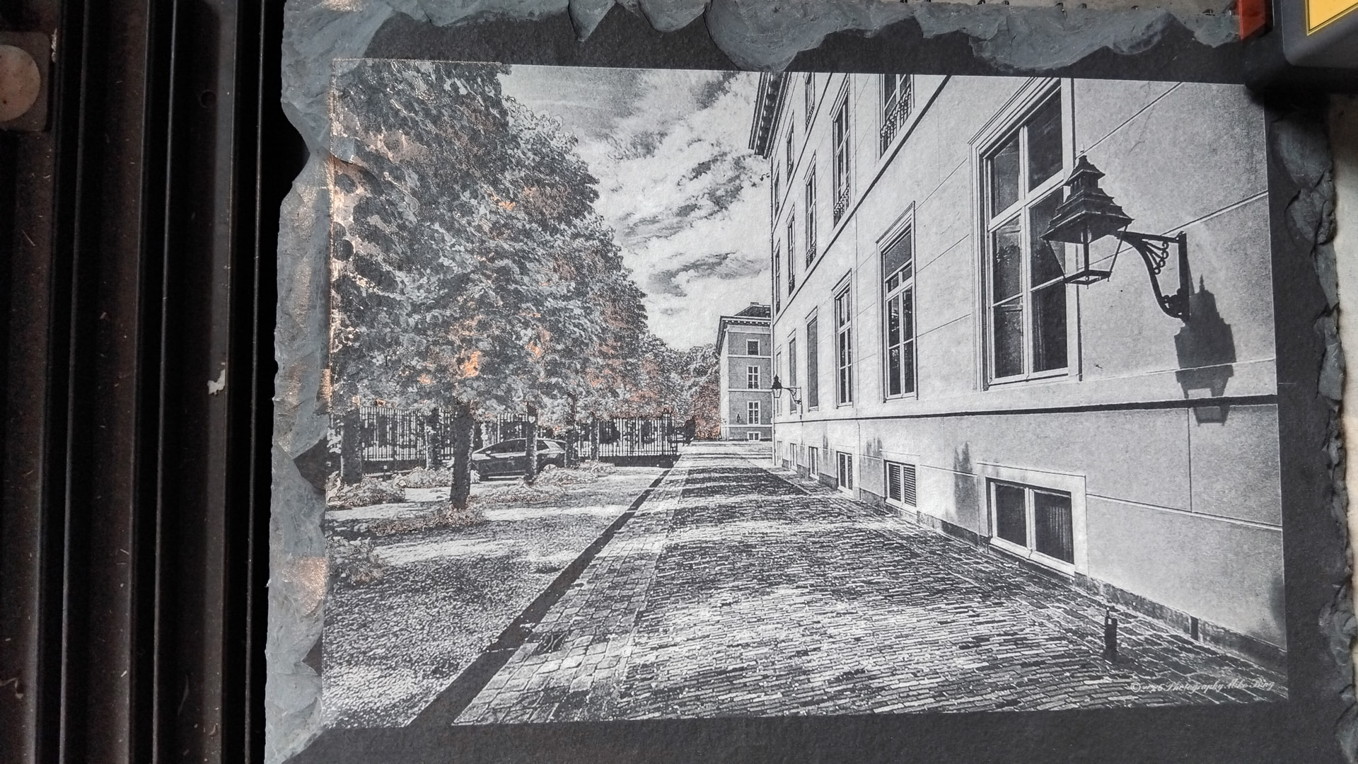

This is what I got from the slate, it’s 260mmx180mm..ish.
I did the second one with a Gamma of 1,900 but it’s too dark, I got the clouds to show but probably it needs to have what’s above the horizon altered so both sky and ships appear OK.
Your results are about what I would expect.
Is your output Grayscale, that’s what it looks like to me. I would crank up the brightness, and adjust the contrast together the clouds back. The image should appear fairly flat. It may require some additional sharpness.
I haven’t played with slate much. Keep trying, and keep me posted. This is interesting.

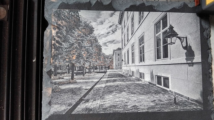

Here’s a Greyscale of a photo taken by a photographer I know called Mike.
I tried adding a bit of copper color by masking but it needs work.

that’s cool.
is that on slate?
