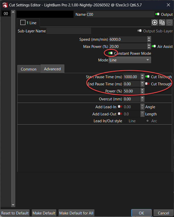

Hi John,
Try using the standard GRBL profile and then enable ā€˜constant power mode’, in the Cut Setting which will cause M3 to be used.
And you can add a pierce dwell if you need it also:

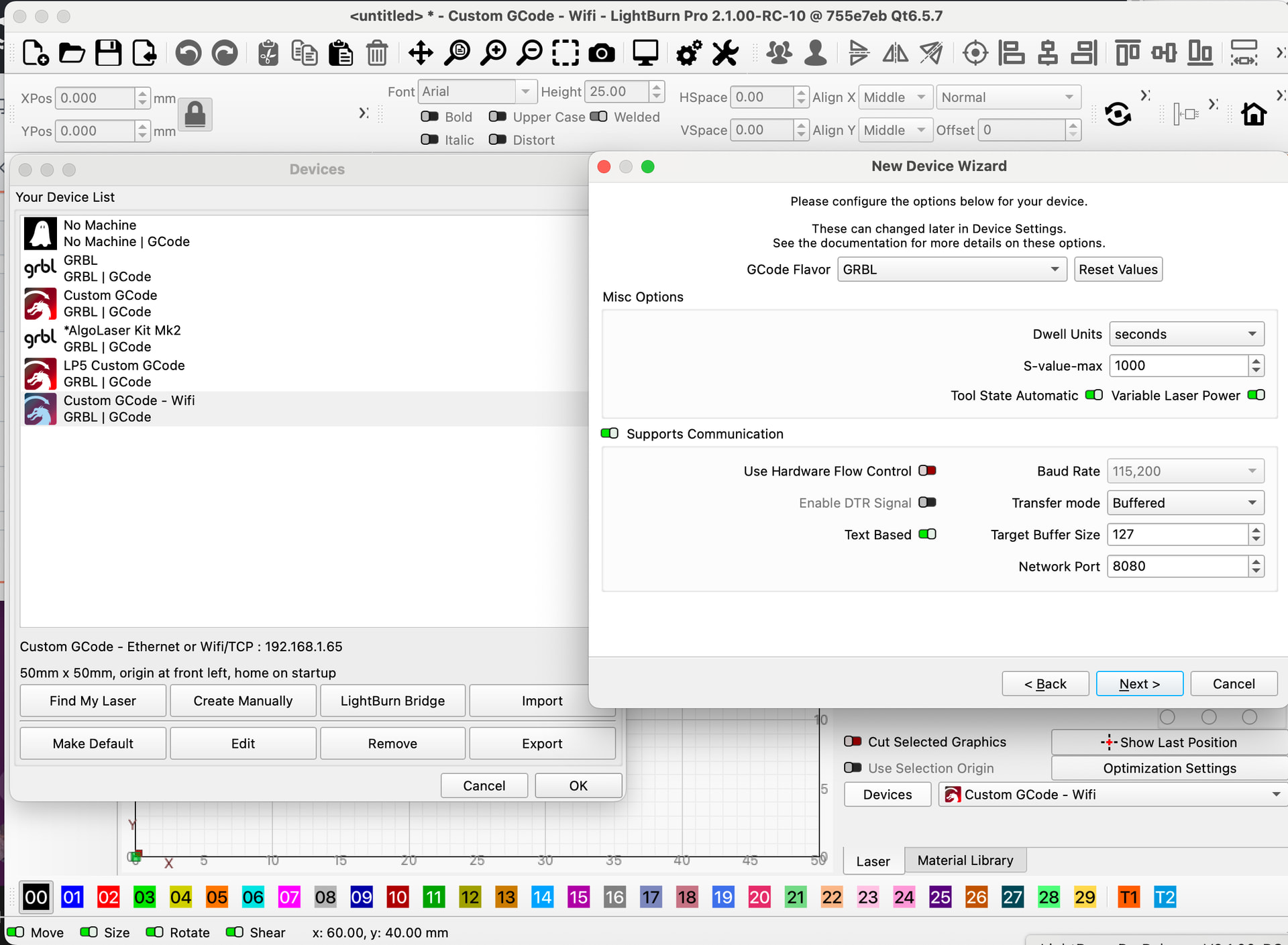

Thanks Nicholas,
I have added a Device with grbl profile and added the local IP for the Mks DLC32 but when I look in Console window I just see ā€œWaiting for connectionā€¦ā€, and if a send a small cut job, a Message box pops up telling me laser is busy or paused.
Any suggestions on what I need to do to get it to connect??

Both Mac mini (wired E-net connection) and MKS-DL32(wifi connection) are on the same subnet. Should I turn ON wifi on mac mini?

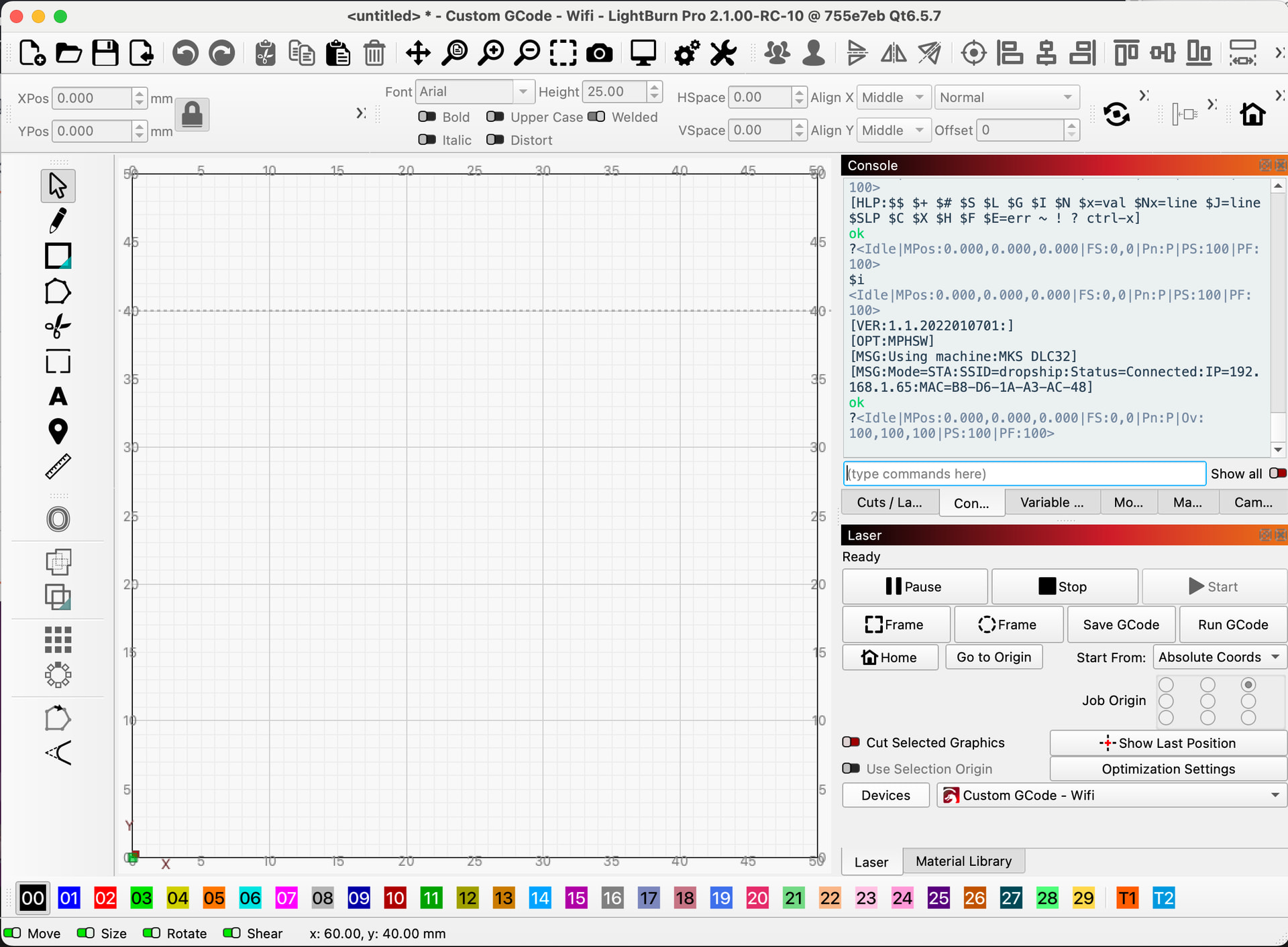

I set the MKS via the connect screen and recorded the IP, I then used it when creating the grbl profile in LB. I can ping the MKS from my mac mini. Checked my router’s device list and mac mini is x.y.1.30 and the MKS called grblesp is x.y.1.70, so they should be seeing each other…

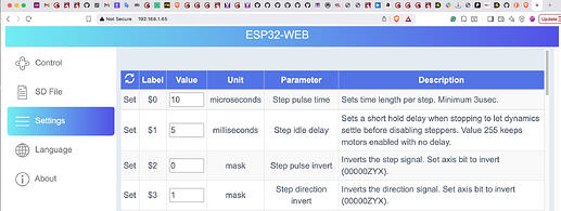

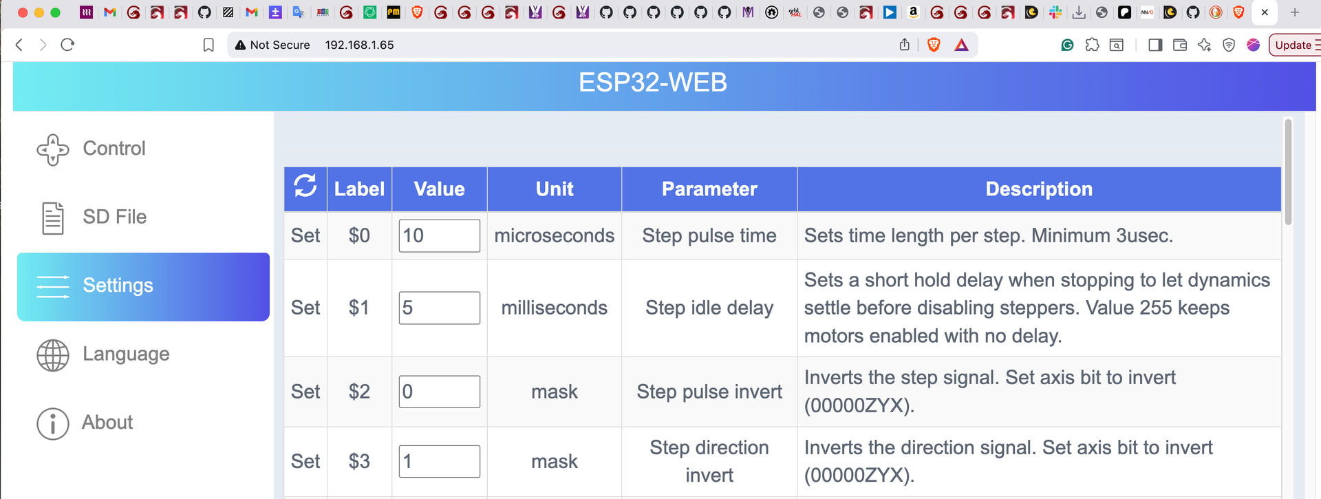

First, you can enter the IP in your browser. The controller should offer a web interface. Next, you need to change the port in device settings. It’s often set to the telnet port, but most ESP firmwares use 80 or 8080 to connect.
Thanks 8080 was the ticket to success
From the same subnet, connected to the Wifi, the Brave browser on my Macbook connected right away.
MKS-DLC32 details:
Board Version: MKS DLC32 V2.0
Firmware: V2.08(8M.H24.20220107)
LightBurn needed Port 8080 in the Device setup.
