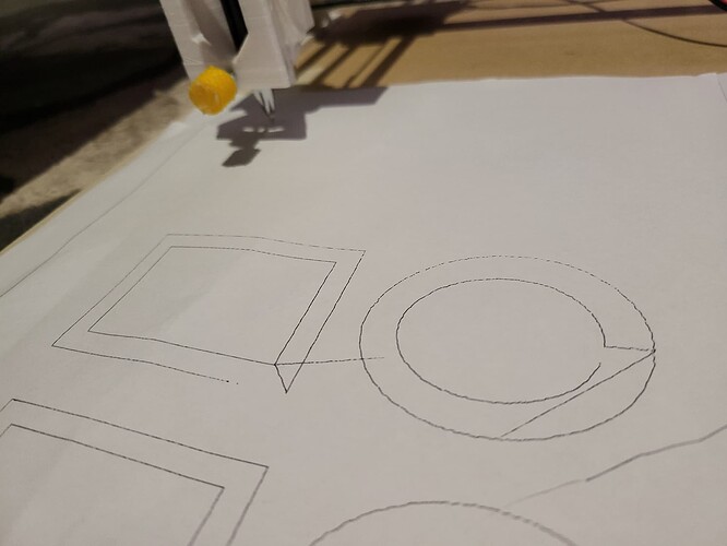

I ended up hot gluing the rotated servo 180 degrees, it works now kinda, the problem now is that it moves too fast before M3 or M5 commands finish lifting the pen so I get marks when the pen is still lifting and the plotter is moving to the next cut line.

This may not be so easy to remedy.
Some suggestions:
  1. optimize the pen position such that it doesn’t take much actuation to go from touching to non-touching states.
  2. reduce the rotation amount required to go from touching to non-touching.
  3. reduce acceleration and speed to minimize the amount of drag time
  4. move to something with faster actuation like a solenoid
Or just revert to manually altering the g-code and adding a delay after each M5.
Thanks for the suggestions, I am getting close!
If you have to draw two separate square the pen have to lift up between the squares
