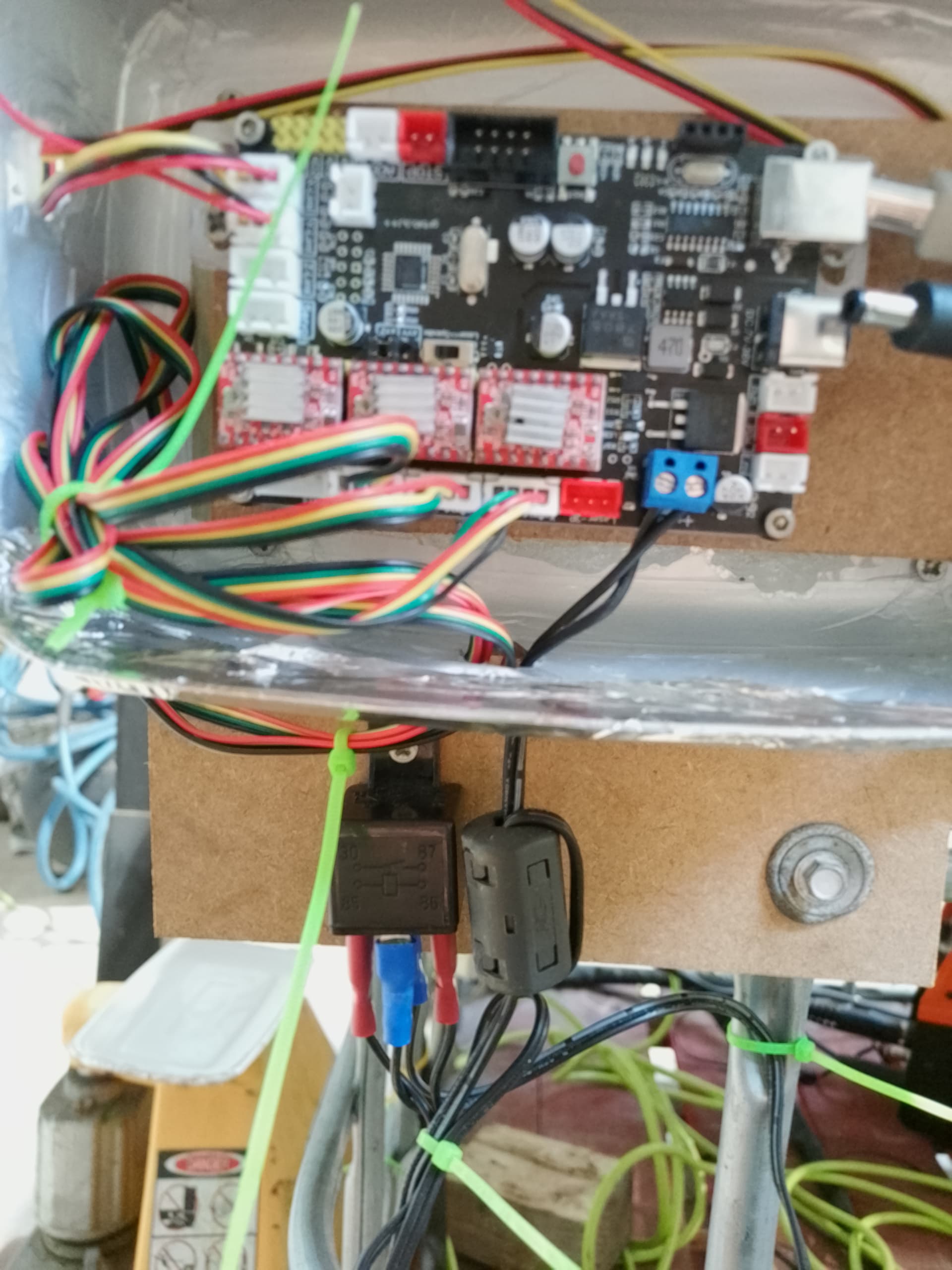

Having a problem with the plasma cutter causing the controller to poop itself. I’ve shielded the controller with foil tape. Have ferrite filters on the trigger wire from the relay and on the USB cable, I’ve even tried to isolate the power supply to work off of my camping trailers solar system but all still the same. Any thoughts would be great.

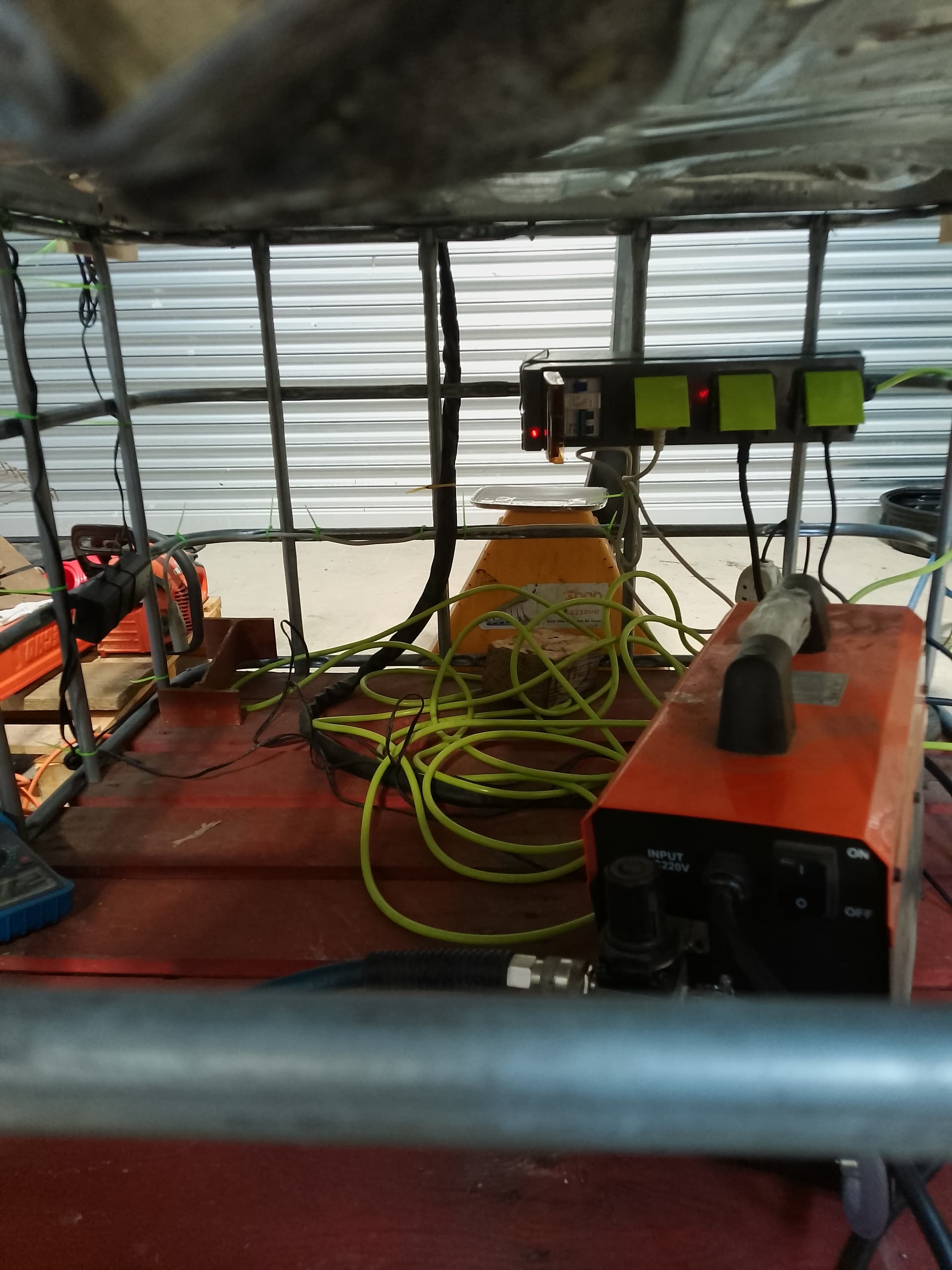

Was just thinking, it still has the eu 2 prong plug on it so it’s not earthed… Might be something there.

Does your relay have a diode built in?
It’s a grbl base controller that came with the CNC kit that I built this from. I’ve covered the box with foil tape hoping for the same affect.
No error message. Just drops USB connection.
Maybe try an SSR instead of a conventional relay (if you use one, I didn’t see it in the pictures). Might help to reduce noise.

Was heading out the door when I took that pic and had it on a battery to test. Everything is fine with the plasma cutter is off but when triggered it’s like the controller reboots. Looking into the ssr’s. Might be just the sudden hit with power from the trigger wire that’s pushing the em burst.

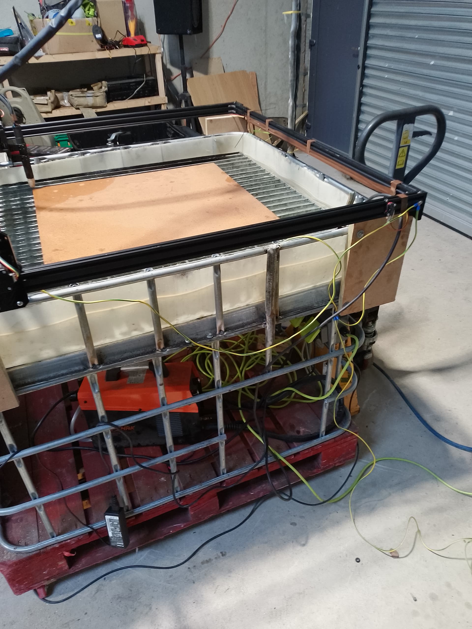

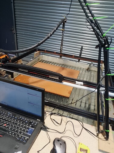

Oh man building into an IBC tote is genius! I need to build my water table out.
Have the full build of it on my YT channel… https://youtube.com/playlist?list=PL1HIJa6YTLy_BbFJ_VaN-KoXQ3HaI3Obr&si=anP_pWGBrsQlTUVZ
Is the ground of the plasma table in anyway connected to grounds on anything electronic? It could be motors, end stop switches, pcbs etc! The table mesh bed and the plasma unit should be well earthed. As previously mentioned the plasma will be very electrically noisy and dumping a lot of it probably to earth. If you could move the electronics as far away as possible and cover all motor and end stop cables with a screen like a foil and maybe insulate the motor mounts and shafts. Tricky
Going to try changing the plug on the plasma as it’s only on a 2 pin eu plug and pick up a SSR relay. Motors are mounted to polycarbonate parts. Have the controller mounted to a piece of MDF and the pox it’s in is foil taped.
