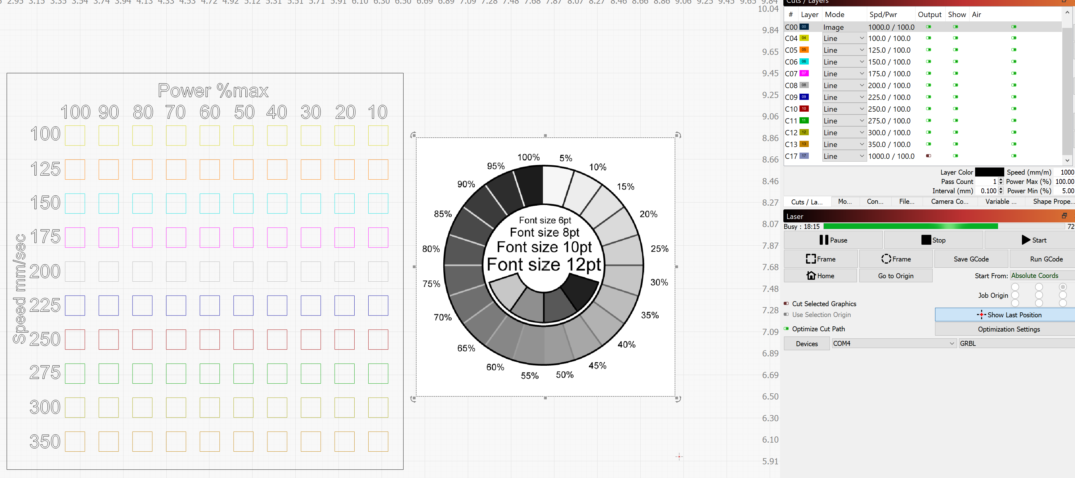

I recently bought a laser cutter/engraver (https://www.amazon.com/dp/B097RJ4SFR?ref=ppx_yo2_dt_b_product_details&th=1) for a project I’m working on. The project involves printing 2D designs from a software called Pepakura onto cardstock, then manually and painstakingly scoring and cutting the hundreds of pieces, until ultimately assembling them into a cardstock framework for a fiberglass + bondo costume.
I solved my scaling/layering workflow to go from Pepakura to Inkscape to LightBurn BUT I feel like I’m chasing a moving target when attempting to burn anything.
Here is what I’m currently attempting to test print:
My unit has a variable focus diode. I have tried this on the cardstock 3" away, and now 1" away (focusing the laser in both locations), with exactly the same results:
By the way, that test took ~38 minutes to complete.
The first problem is the occasional gaps that seem to happen after the laser moves. The next is finding the ideal power + speed. I have determined some of the factory settings were incorrect ($32, for example, as well as falsely inverting y-axis) but I’m hesitant to play with those without some direction from the wise and educated (you all).
