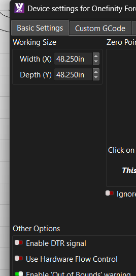

dI have a DIY Mini Mill it is controlled by an ESP32, running grblHal. normally I control it with Openbuilds Control. when I connect to MillMage I get conflicting information. The Job Control panel says “ready” , the console “waiting for connect” and or the following

probably missing something simple? I use Lightburn for my V1 engineering MPC laser. I would love to be able to use MillMage, for the mill, and also a Plasma Table.
thanks in advance
Try enabling DTR Signal in your device settings.
You’re right. It definitely looks like it’s not connecting.
From what i’m gathering here:
It appears that the OpenBuilds Control is file-based and isn’t set up for streaming from a sender.
There might be an option to enable it in the config file but I’m coming up empty.
Do you have a link to the firmware used for your controller?
To me that looks like a boot loop. You should try to flash the firmware again. Did you use the web flash tool?
I had seen mention of DTR in another post, that didn’t help. The ESP32 was flashed from a bin file on openbuilds. The machine works fine with openbuilds control
