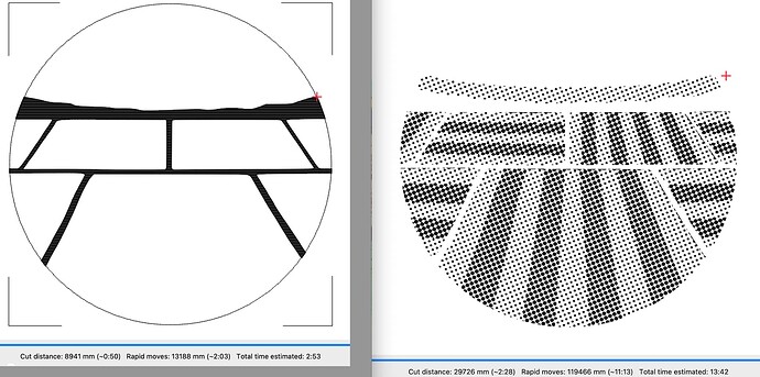

That’s interesting, if it’s some kind of light coloured plywood in the middle?, then maybe something like this?
I’ve done this in a two part process;
-a plain Fill for the roads & hill (low line interval and defocussed for speed)
-and for a textured effect the remainder of the image has a Halftone dither with a low cell count (18/in).
Test on MDF, I gave it a quick sand and light brush just to bring the contrast back a little.
Just wanted to see roughly what it might look like on plywood with a little acrylic paint thrown on with a brush (trying not to get the paint in the halftone cells).
Didn’t get the sky or colours quite right, but hey it’s only a mockup!
HalftoneFields.lbrn2 (631.6 KB)

This picture is what I am talking about maybe shouldn’t have posted a colored picture
This the one that I have finished but in the center circle I could not get the second horizon to trace it is very light and would not trace but with the center circle that is the shading or something very close that they want to keep. My question is since this is an image file it takes 2 hrs to burn so I was wondering if there was some way to keep the shading somewhat and reduce the time burning. Could it somehow be converted to another file type that would burn quicker or have layers to apply different heat settings to acquire the proper shading. I hope this is clearer than my first post. But I need to keep the light and darker shading of the center circle

Could you make it a Vector and if there are more verticle lines than Horizontal, then turn it 90deg to work more on the X axis.
Can you darken the Horizon that will not trace until it does and darken the rest of the shades respectively so they all show, Or put it on its own layer.
I would do it in two parts like @NicholasL suggested, or maybe even 3 for that horizon.
  1. For the border lines, use Offset Fill and that will reduce some of your time.
  2. Use less LPI (larger Interval) and take advantage of the wider charring.
  3. For the shaded part, defocus a little, crank up the power, and speed it up
You do not say how big that thing is, so 2 hours might be quite reasonable.
This is what I am asking how do you break up the the center drawing and keep the shading so they can be put on layers so different settings can be applied I don’t know how to do that
@NicholasL broke it into 2 parts. That was the hard part. The shaded areas are now in separate sections. You should be able to select sections and assign them to different layers.
As for those light and dark stripes next to each other, there is little you can do to split them up. Someone with more drawing program experience than I have may have a solution.
I doubt there is a shortcut that magically does this. Just take your time and remember CTRL-Z is your friend.
Would ‘Show points’ help in this case.
Trace the image - Show points - using the little scissors snip away all unwanted, and assign the remainder to a layer - Apply setting.
If this looks like it will work, do a CTRL-D and assign the copy to a new layer. then take the snip tool to it.

No need to use trace for this, if you right-click on the image and select ‘Adjust Image’, you can adjust both the Image Mode and Settings to bring the second horizon back, since the original bitmap is still present.
(The Adjust Image tool is one of the most useful tools in LightBurn that seems to be often overlooked.)
