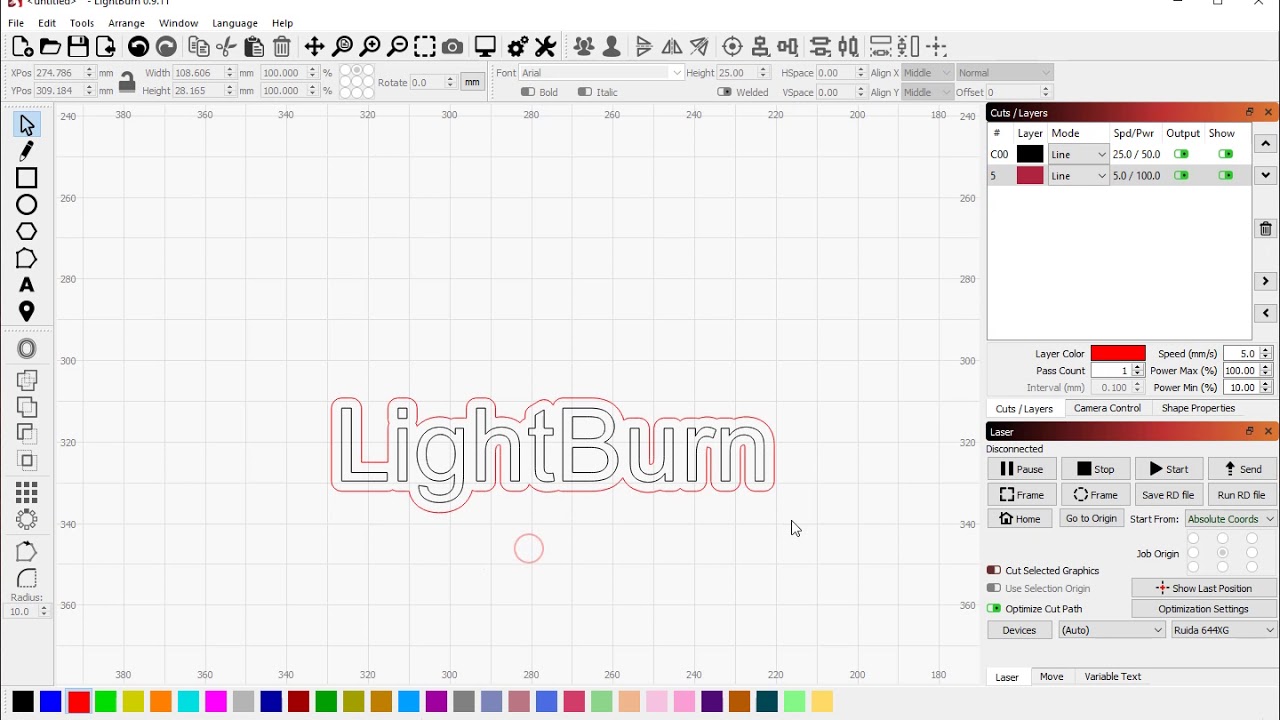

Thank you for drawing our attention to this. Which OS and LightBurn version are you using when you observe this behavior? How are you testing to find these results? I ask for these steps to assist us with initial testing to reproduce this behavior.
When I turn OFF Snap to Object, I still have Snap to Grid (Grid Snap Distance set to 10.00mm for this test) enabled and working as expected. For this test, I am running LightBurn 1.6.03 on an M3 Mac - Sonoma 14.5 (23F79).
2024-08-01_12-57-36
Further Update: Working with Oz, we have been able to reproduce and have a fix, which should be in the 1.7.00 release. Thank you, once again @ipodsync.
