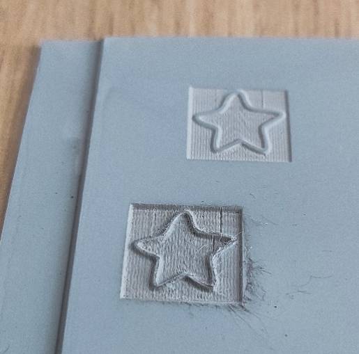

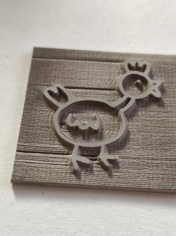

Hello,
I’m new to lasercutting/engraving and Lightburn. I recently bought a Creality Falcon2 20W and I try to create some stamps. This works fairly well, but I get some additional grooves in the final result. It doesn’t seem to matter where I put the rubber in the working area (top right, bottom left, …). It occurs in all my test cuts so far. It doesn’t seem to correspondent with any traversal moves. I use Fill mode, 1 pass, 1750mm/min, 0.1mm interval.
The chicken is about 35 x 35 mm, the star about 20x20mm.
Any suggestions would be greatly appreciated!

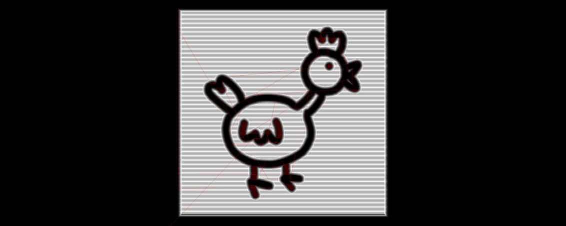

Have you watched it in preview to see if the machine is doing something different in these areas?

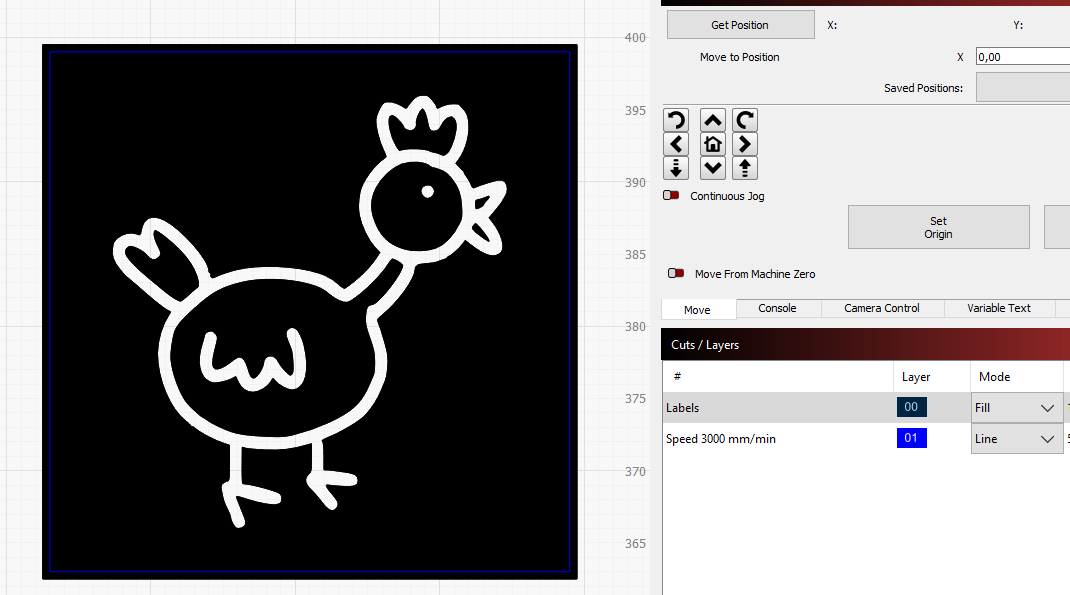

May I ask what you have selected for DPI or Line Interval?
The background ‘grain’ looks like the curtains artifact that belt driven devices make.
I doubt it is part of the artwork:
It also doesn’t correspond with any of the traversal lines:

The DPI seems to be 254, with a line interval of 0.1 mm. I think these are standard settings from the Falcon2 profile, I didn’t change anything in this screen (being new to lasercutting):

For the Chicken (Rooster?) , check the Y-Axis belt(s) for crumbs or debris entering and leaving the drive pulley.
Is the image with the stars rotated 90 degrees to how the stars were produced?

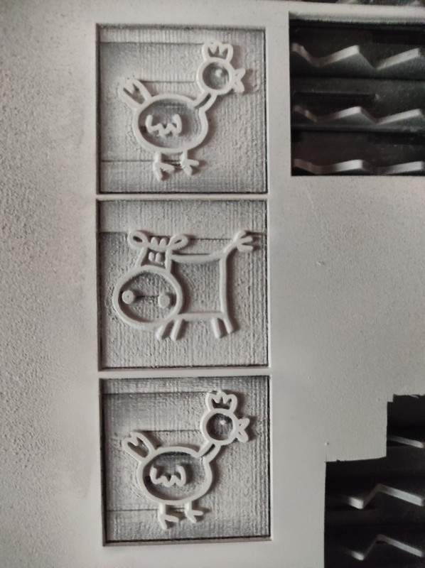

I finally had the time to look a bit further to this.
It’s 100% sure that the grooves are not image related: I engraved the same image three times:
  1. Bi directional fill
  2. Bi directional fill, but with the image rotated 90°.
  3. Offset fill
1 + 2 were engraved at the same time, 3 afterwards. (don’t mind the upper part of 1+2, the rubber was thinner there and I forgot to take this into account)
As you can see, there is some kind of overlap in the offset fill + there remains a high spot all around the ice cream as well.

The grooves look like they would correlate with the edges of isolated areas of Flood Fill.
So turning Flood Fill off should fix it.
As to why the grooves are occurring?
-could possibly be over-accelerated rapid Y-travel loosing steps and not placing the start of the next fill area in exactly the right place.
-could be backlash in Y.
Either way, the over-sensitive rubber means you will have to work harder to tune your machine to get the results you need.
