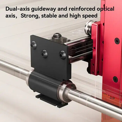

How to ground your diode engraver, to limit bugs during engraving, made on twotrees ts2 10w, also works for other diode lasers, approximate setup.
photo 1: a cable connected to the laser chassis
The cab,e passes through the cable guide chain.
Picture 2:
the cable coming from the laser is connected to the chain support on the metal part. photo 3: Photo: a cable leaves the plate towards the motherboard
picture 4:
the cable leaves the chassis and is connected to earth, a radiator in my case.
picture 5:
connection to the radiator
the screws being metal they conduct the current, the cables must be in contact with a metal part like steel or aluminum, check with a current tester that the connection is continuous from the beginning to the end.

I know better than anyone, it’s not a grounding of the 220v network! The wire would be much too small, laughsand it would not be up to standard.
It is only a way to drain static electricity only.
I hope this forum doesn’t end up like 90% of the others, with only jealous criticism and nothing constructive.
The ground (equipotential connection) would be made from the power supply of the motherboard, but as only the cable going from the sector to the transformer is equipped with wire with three conductors, safety is ensured only between the socket and the transformer, past its lowering to the voltage of 24V, nothing is grounded. I repeat it is just to drain the static electricity, resulting from the friction of the Pom wheels on the path, as it is insulating it creates static electricity and constitutes a sort of giant capacitor, and an infiltrated part finished in the USB cable.
To those who know how to read…
I look forward to seeing your ideas on this subject. This is a solution to a problem that is Non observable and that could take lots of time to find…after mechanical and connectivity checks.

Since antiquity, with amber (electrum of the ancients) and hair, we have observed in a simply derisory way, one of the greatest and most complex discoveries of humanity, namely electricity, the first observations were made on static electricity, then much later on electricity. Since then I have reduced the number of interruptions in my engraving by 80%, I only wear cotton clothing, and once I took a slight static discharge, my laser stopped dead, from where this idea germinated.
So I looked at my machine in detail at the construction level, the problem is in the Pom wheels, they generate too much of static electricity.
The conditions for creating a kind of capacitors.
I tested my system with a simple balloon, a small piece of paper, my hair too (!) in my system they were attracted, since I connected the cable, no more worries at this level. I ordered ferrites to make an electromagnetic shield, which I will put on the power cable (new 4A power supply soon, because when I burn at 100%, everything crashes)) and on the USB cable which is already shielded but not sufficiently.
I have 30 years of computer maintenance and I know full well that static electricity and certain unfiltered electromagnetic waves cause bugs and problems in computers. Such as data loss.I just want to be able to complete 100% of my work without interruptions, wasted materials and time. The software has problems too but it is not in my capacity to resolve them, the team of programmers works wonderfully on it. I don’t have all the answers or absolute knowledge, but I come from the world of mechanical engineering and microtechnology, so if I can help, it’s with pleasure.

Hello and thank you for the compliment, it is indeed a mix of high-end products and unfortunately low-end products, like the power supplies which stop engraving at 100% etc. Afterwards, the subject must be well understood, especially the difference between putting a mass for static electricity and a system to stop EMI, and making me put the current from the sector to the ground, it looks similar but it has nothing to do with it.
I know that many people still have two-pole electrical outlets, which is prohibited in France. From experience I know that if my machine is properly grounded etc, I do not need to wear an anti-static bracelet.
I’m just trying to help people enjoy their machine and save time and materials.
For food, unfortunately, we are far from the system used on PC, namely 3-conductor socket and grounding and earthing with in addition the spread spectrum system (PC BIOS) to limit EMI, metal chassis and motherboard ground connected to chassis thanks to the screws of the motherboard do not the passage hole on the pcb is ALWAYS covered with tin to ensure this famous electrical contact. DLC32 and other motherboards do not have anything similar, just a ground (negative pole) on the pcb, etc. for full-fledged computers.
The movement of the rails causes negligible static load (air friction etc).
On the other hand, the Pom wheels, therefore in plastic, due to their rapid movement and especially the fact that they are sandwiched between two metallic rails, forms a primary capacitor (an insulator between two conductors, pnp or npn type).
