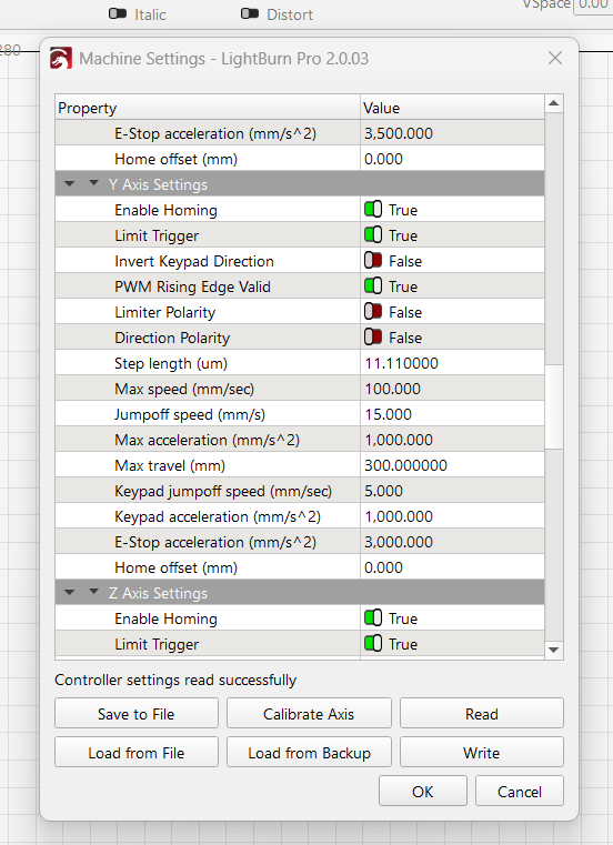

Hi, I had so much trouble with my machine, with the Y speed at 1000 it jumps teeth on the belts, makes grinding sounds and the gantry jumps around, after contacting gweike support for the 100 time they wanted to see my vendor settings, they told me to reduce the Y speed from 1000 to 100, this finally fixed my issue, and my machine has no issues now, I don’t know if the Y setting should be at 1000 but the most I could push it to was 150 before the issues started again, I can only think the weight of the gantry and tube, and or some software might be causing it, anyway my machine is usable now, Here are my vendor settings from the machine , I hope they help, good luck.

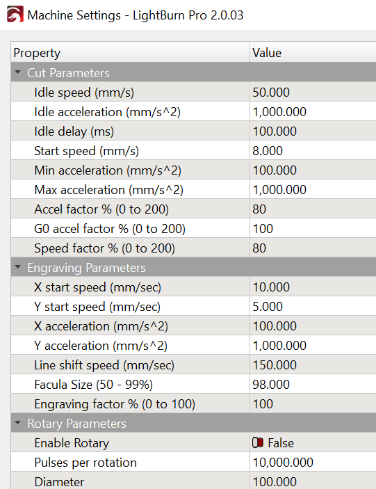

I made the changes, but still not looking right. Do you mind sharing the Cut Parameters and Engraving Parameters? Also, I’m on Lightburn 1.7 - not sure if worth upgrading?
Feel free to post screenshots of the settings and pictures of the outcome so we can see what’s not right.

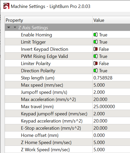

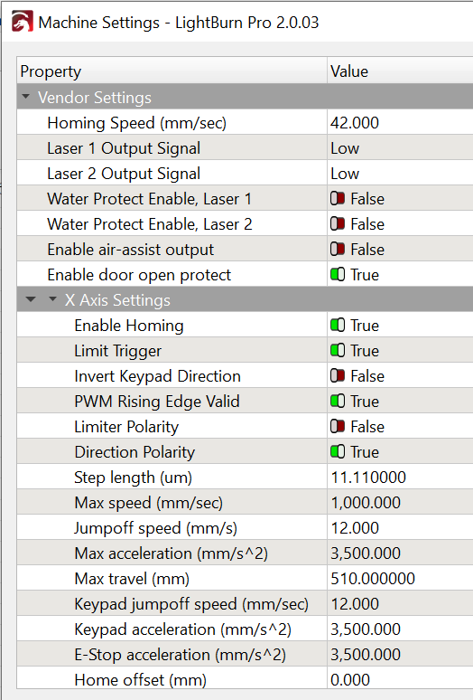

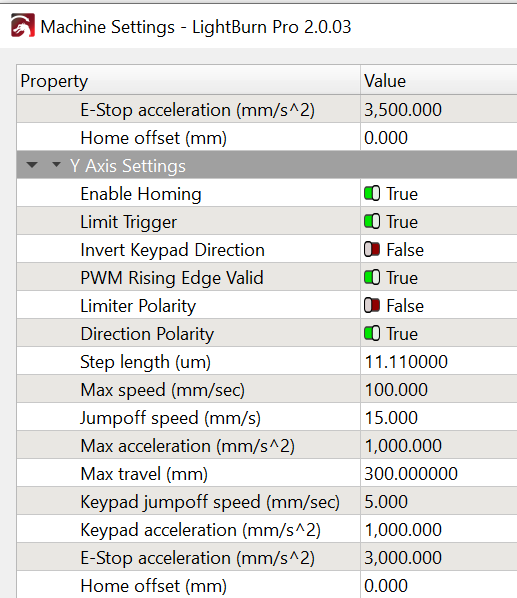

Here are my settings anyway.

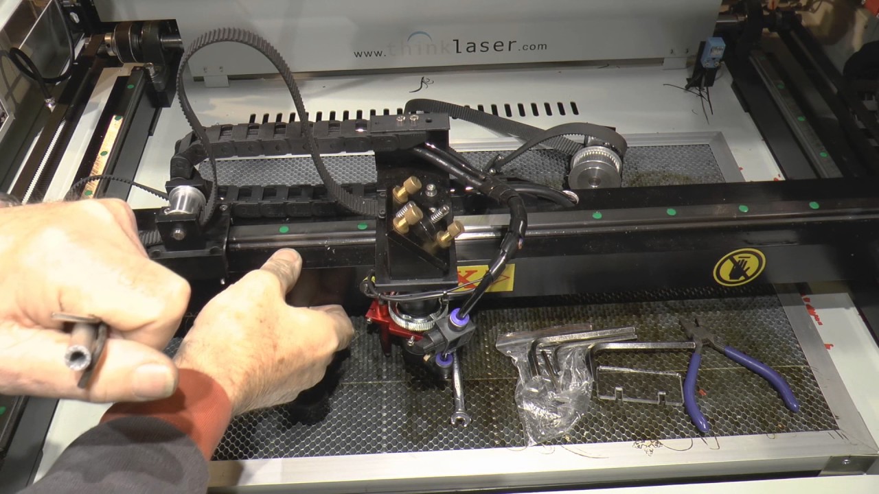

Try loosening this bracket again, wiggle it a bit, and move the Y-Axis towards the center. Tighten it there, so it hopefully ends up where it want’s to be.
You can also do this test:
And this video by the legendary Russ Sadler:

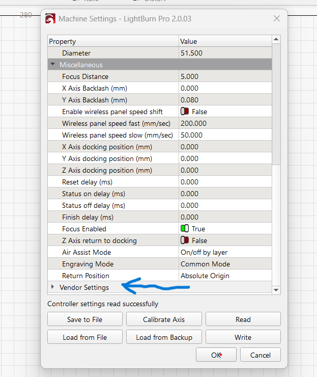

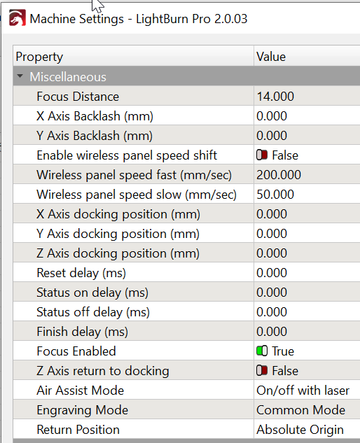

I received Billie’s default settings from the Gweike Cloud:
Machine Settings Gweike 20250925.lbset (14.3 KB)
As far as I compared from the screenshots, you are using the same settings, except for the Y Axis Max Speed 100, recommended by Keith.
You can select “Save to File” from the Machine Settings window to export your settings to a .lbset file, and compare the two files with a diff tool if you like.

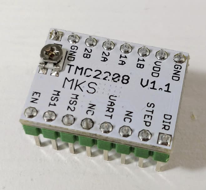

A feasible test is to measure the vRef voltage of the stepper motor drivers.
The motor current is adjusted and measured with the trim pot on these guys:
I wouldn’t know the correct value. Maybe, @jkwilborn has a clue?
