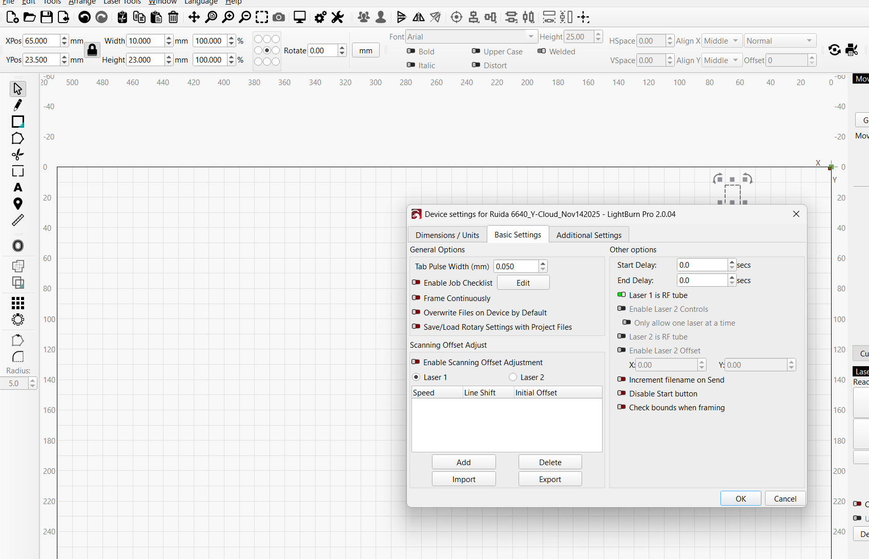

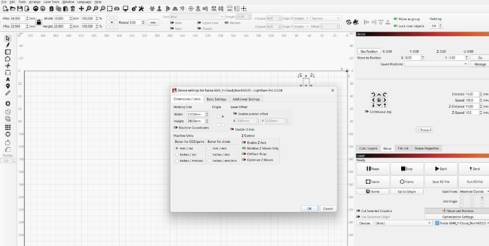

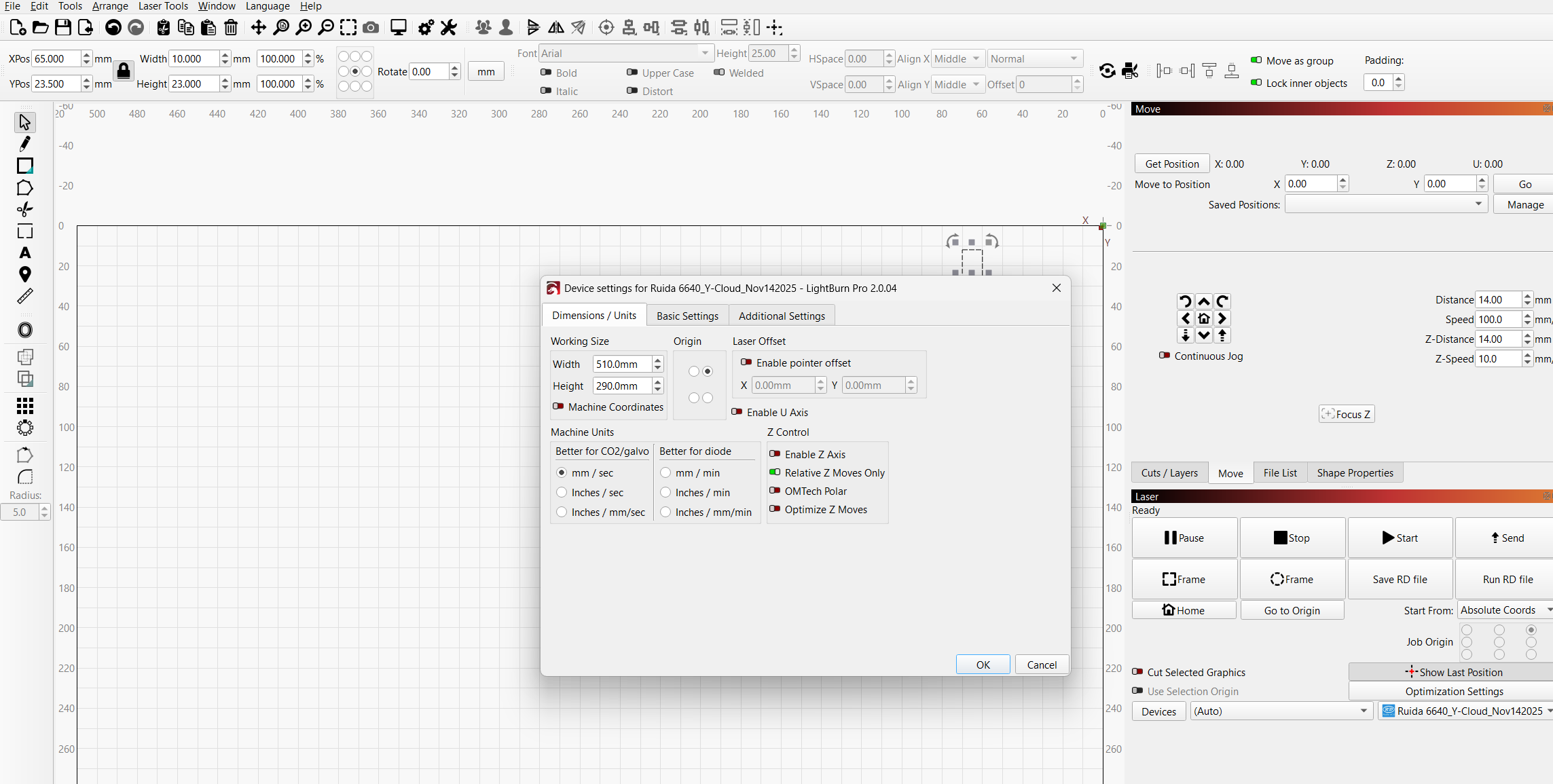

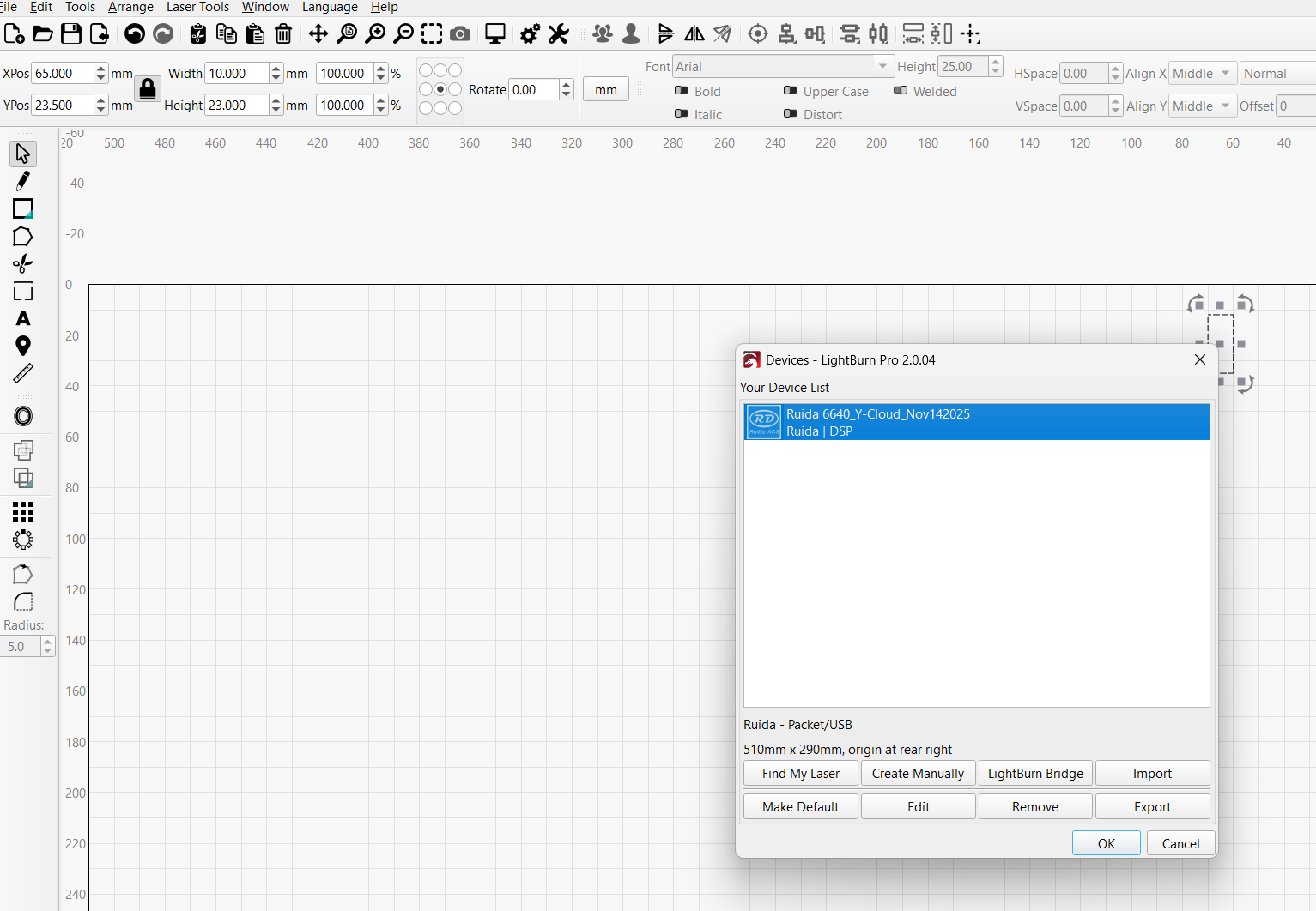

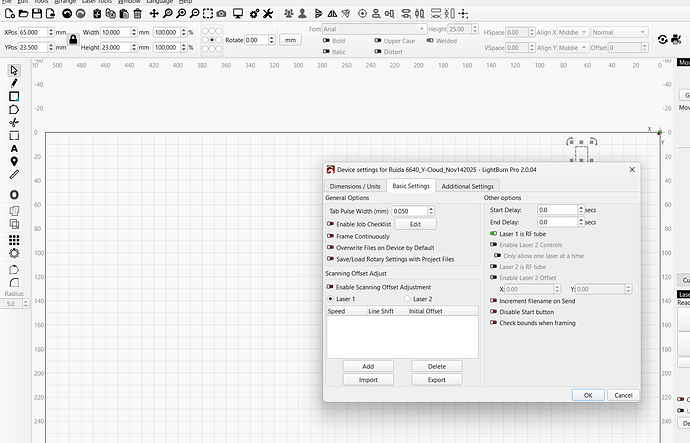

Hello I have a Gweike Cloud RF laser and have had this machine for about 4+ years. It has worked in the past but recently have found that it is not firing on start up and after a lot of time trying to run a job it mysteriously kicks in and starts to fire. It is set to Packet (vs Serial) and I’ve tried both without success. The machine is framing correctly and also following the design whether it’s laser cutting or engraving. All that is good - the laser itself is not firing.
