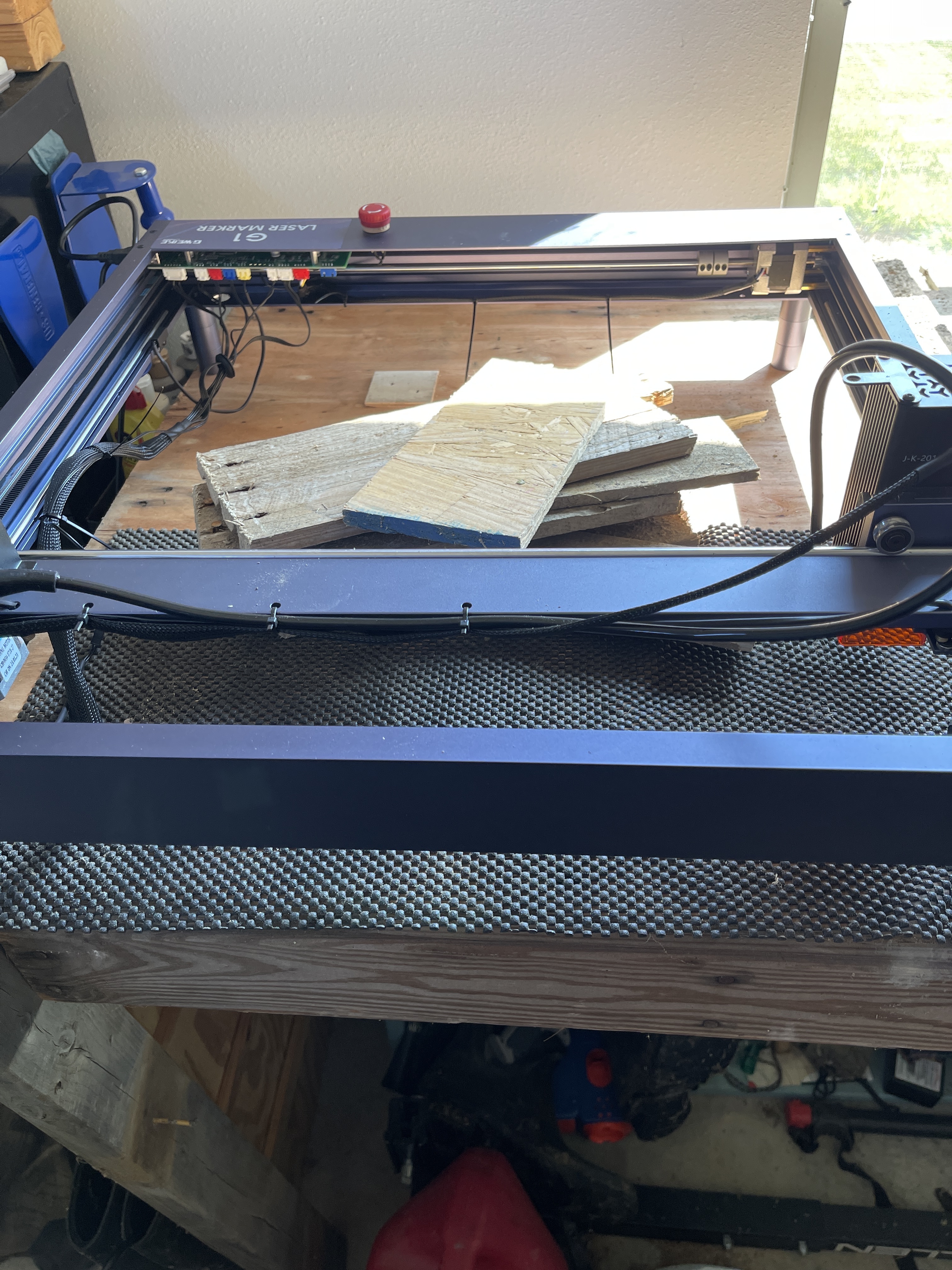

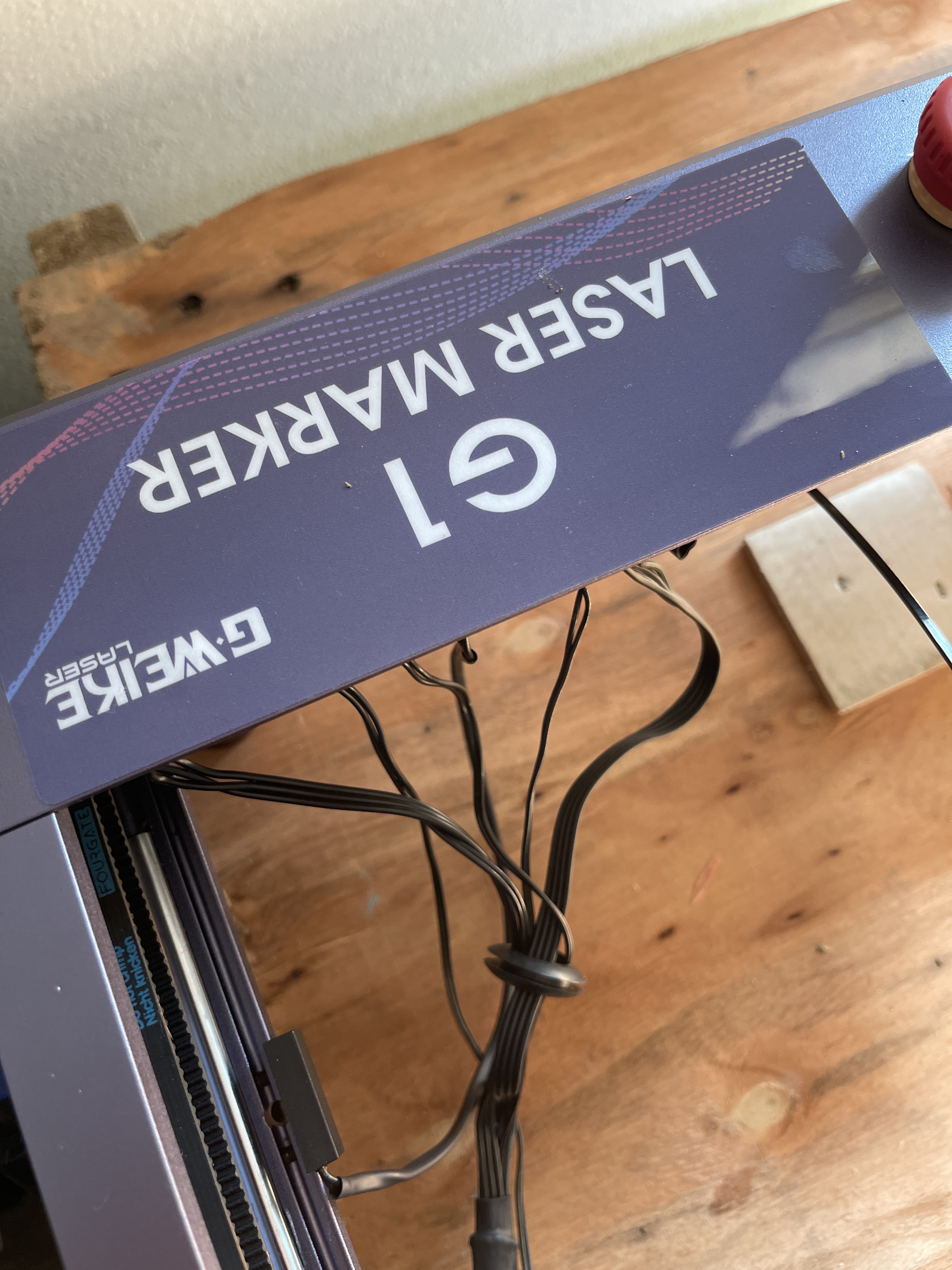

So here is my machine. I got it for free from Gaming Geek YouTube channel. He couldn’t it to home. I got past that part. I do wonder if the baud rate on my usb port is too fast?
It is a smoothie board 1.2
When we see Gweike, most of us think co2 with a Ruida controller… that’s why you’ve gotten strange answers/questions… It was in your profile, that I looked at, but didn’t catch the G1 model… :crying_cat_face:

Can you post the boot information and any other console information that is displayed around the error message…

Can you please provide the following:
  1. Full screenshot of LightBurn with the design loaded and ready to burn
  2. Full text of Console showing the error and any reference information
  3. To what corner of the machine does the laser home? I noticed that your pictures have you looking at the laser from the back of the machine. So please answer relative to native orientation of the machine
  4. After homing, if you push “Get position” in Move window, what are the reported coordinates?
So you guys are brilliant, and it works. Thank you very, very much.
turns out I’m an idiot, and I don’t understand starting positions in the setup menu.
