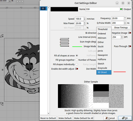

Normally you use the 3D Sliced option in the cut/layers for the type of dither or image mode. I know that Lightburn will run the G2 but I think it still reports and uses a grbl type controller. So, I would doubt that 3d sliced would be available with a grbl machine.
In the cut/settings editor, select from the Image Mode (green) pull down the menu and select 3d Sliced (red).

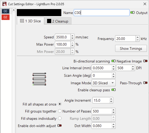

I didn’t do a ton of 3D-Sliced relief engravings, but had good initial results with those settings:
  • Medium Speed
  • Max Power (because I’m impatient)
  • 500-1000 passes.
  • Low Frequency for more ablation. Generally, a lower frequency means that the fiber source charges up longer for each pulse, leading to higher power output. (Think of the frequency as the grit of sandpaper)
As Jack pointed out, there is a specific sweet-spot, where the laser emits the most power. But I’m not sure where that is on the Gweike.
You won’t find the Q-Pulse setting on the G2 Pro. It’s a Fiber source with a fixed Pulselength.

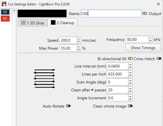

Cleanup Pass after 20 passes:
