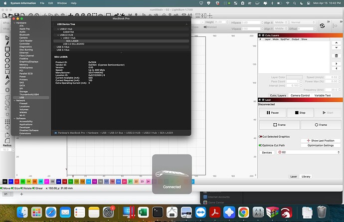

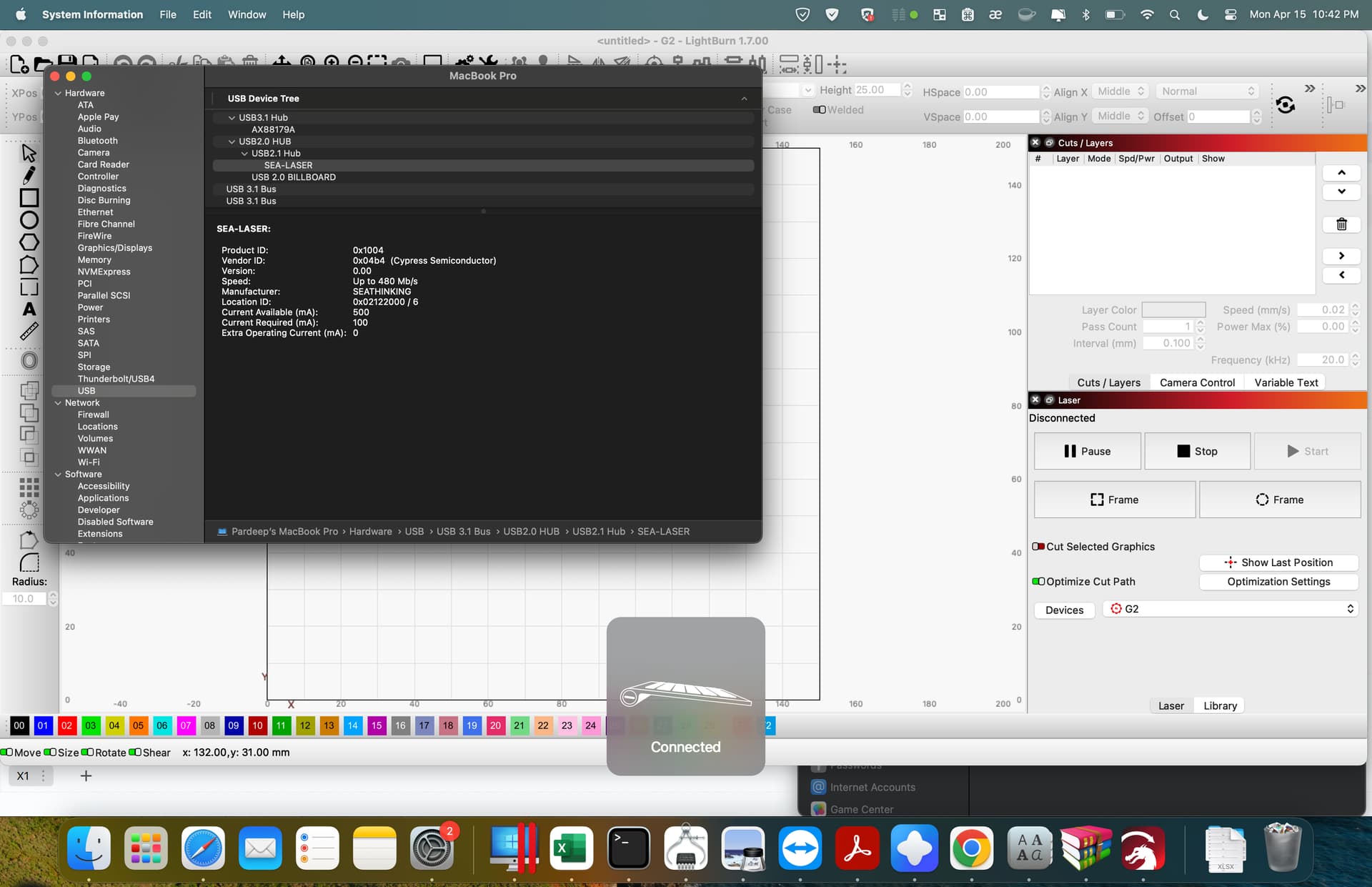

Lightburn not connecting to G2 Fiber laser on M1 Mac. I have connected it Manually and selected the sea cad file. Is there any thing else i have to change. Using LightBurn 1.7
I don’t know where you find your usb device information on a Mac…
That’s the best place to start, ensure the os can see the device… If the os can’t see it, Lightburn can’t connect to it…

If you can, I’d suggest loading, what was a working version and see if it is indeed a version issue. I kind of doubt it… but you never know.
Check that the os can see it first.

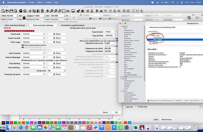

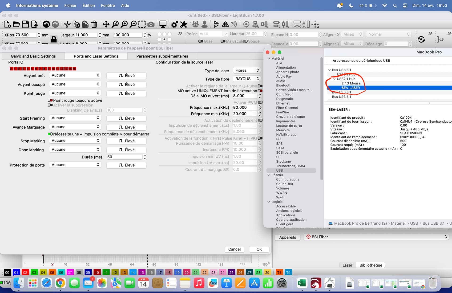

Bonjour, Meme problème avec le G2 Gweike, Lightburn 1.7 et Mac ? j’ai 2 Macbook, un de 2012 system intel avec osx Monterey et un de 2023 system M2 osx Sonoma la licence Galvo est activé sur Lightburn mais pourtant rien ne fonctionne ni sur intel ni sur M2 le laser est pourtant reconnue sur l’USB du Mac.

None of the suggestion work I have installed the both FTDI and CH341 driver yet no change. Under system repost I can see device connected as sea laser.
Pareil pour moi aucune des suggestions ne fonctionne. J’ai installé les pilotes FTDI, mais aucun changement.
