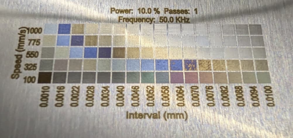

I found that the Speed and Interval settings produced the best color differences on stainless steel:

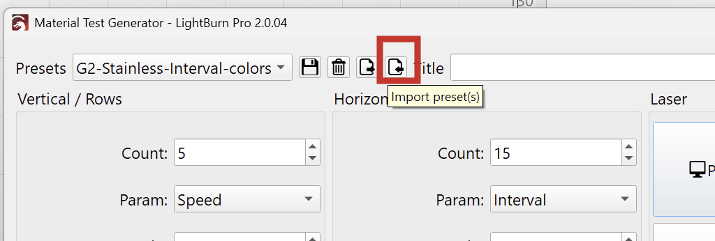

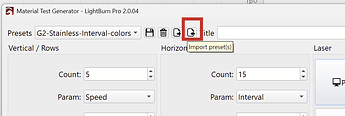

You can import my Material Test Preset here:
G2-Stainless-Interval-colors.lbmt (1.2 KB)
Be aware that this is a delicate process! (The colors are a result of nanometer-scale variations in the oxide layer thickness, which filter some light wavelengths. :exploding_head:)
A consistent focus height is crucial for reproducible results.
