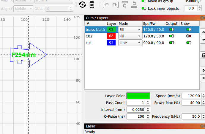

  2. I’m trying to cut and engrave 1mm brass, and having some difficulty. More on that below.

Got Glaser running ok after figuring out that the supplied USB cable was no good. Ran some test pieces in 1mm brass with the intent to engrave dark text and then cut an outline for some custom tags.
First Trial:
I used the recommended settings from barchlaser.com to start with for the dark text and cutting.
Dark engraving:
Speed 150
Power 90%
Frequency 60
LINE SPACE: 0.02
Did not do this:
HATCH : 1
HATCH type: Bidirectional
ANGLE: 90
Text came out dark but raised rather than engraved, like it basically burned the brass to slag but left it in place. Cuts were very shallow and also mostly just a puddle of dark slag in a trench.
Cutting:
Speed 100
Power 90%
Frequency 37
WOBBLE DIAMETER: 0.30
WOBBLE DISTANCE: 0.1
passes 5(not mentioned by barch, but the promo videos for the G2 showed it cutting in 4 on .5mm)
But didnt do this:
HATCH: Bidirectional
HATCH angle: 0
LINE SPACE: 0.5
Second test
Tried the published settings from Gweike for engraving brass and it took off a lot more material(≈.5mm), but was not dark at all. 1500mm/s, 60%, 30khz, 200 passes
Cutting I tried their published settings as well, but I can’t find them now. I believe it was very similar to Barch’s recommendation, except frequency 30, and I tried 25 and then 50 passes.
Even 50 passes didn’t cut through. But it was close enough that I can see a line in the bottom of the brass along the trench. This took a while for such a small piece. Do you have any recommendations for how I can get closer to the awesome 4 pass cuts at .5mm Gweike shows in their promo vid?

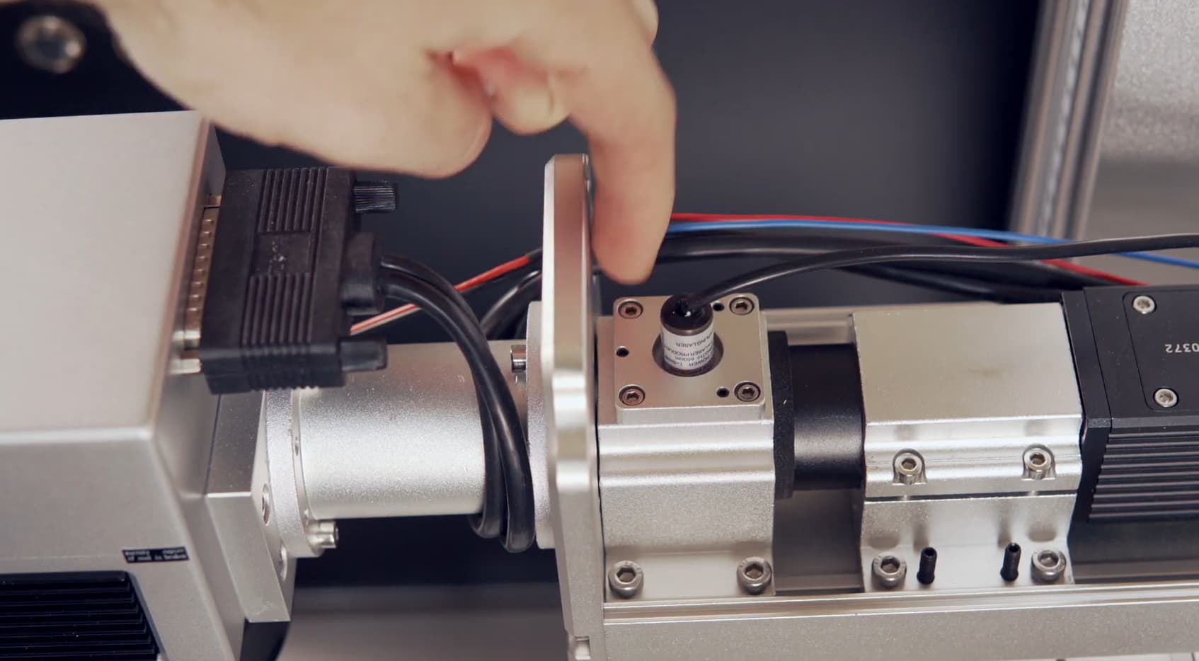

To give more context of why that is:
The Galvo Red Dot Alignment video briefly shows the beam combiner in another galvo:

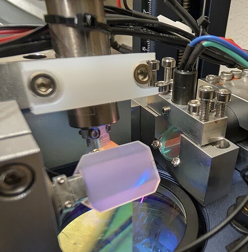

This is how that part looks in a G2 Pro:
The laser from the source comes from the right and passes through this slanted, mirrored glass. Above it, in the aluminum block, is the red auxiliary laser. The four screws align the red dot laser to be in one line with the fiber source.
I got lucky and never had to adjust it on my machine. The easiest way is definitely to do it in LightBurn by following the video.

Here are some general tips for cutting 1mm+ metal for fiber sources:
  • Focus is key! Set the focus halfway into the material.
    When focusing, don’t necessarily trust only the two aligned red-dots, as this depends on an accurate calibration of the second, angled assist laser. The methods described in this video are more reliable.
  • A strong fan blowing on the material helps keep the temperature under control and remove ablated material.
  • Use Wobble! Increase the “Wobble Size” and decrease “Wobble Step”. This creates a larger gap, so the beam can “get in there”
  • Use the lowest frequency to get more power per pulse. (like coarse-grit sandpaper)
  • I personally prefer a fast speed of around 5000 mm/s
  • And do as many passes as needed. Sometimes more than 200 passes!

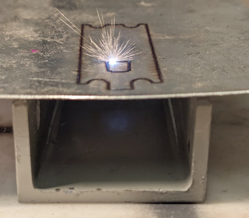

You can try with something like this:

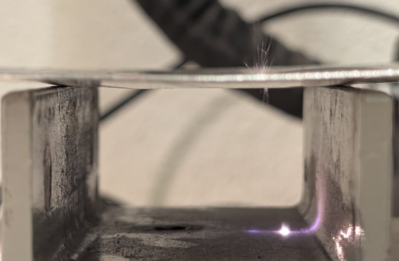

I like to place the material on an elevated platform, so you can see under it (with safety goggles!)
Here, I’ve set it to 500 passes and let it run until it’s through:
In this case, it was 0.75mm stainless. I don’t remember, how many passes it took, but this small bracket took 30 minutes to cut!
As Jack noted: these are engraving machines. But with enough patience can absolutely be used for cutting.
Let us know, what you end up with. Share a screenshot of the used settings and pictures of the results, if you like!

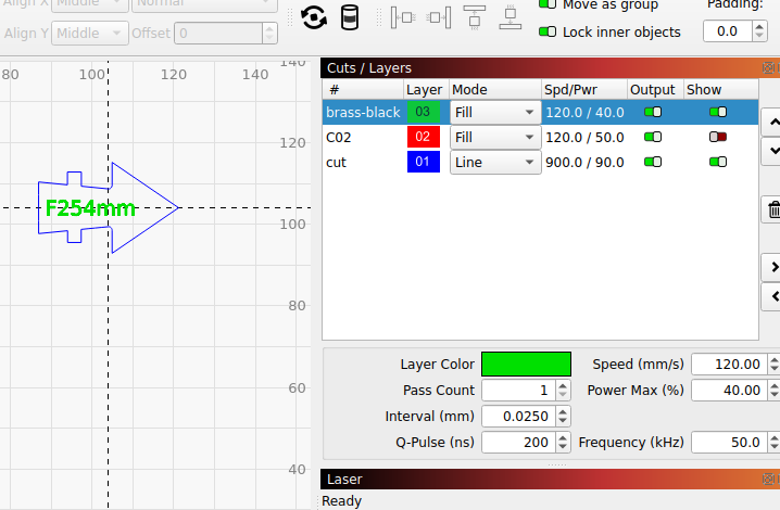

Dang, can’t believe it did stainless that thick! I finally ended up getting one small tag to cut through brass by running multiple sublayers. it took 39 minutes. The settings were
  1. 10mm/s, 100% power, 30hz with .1mm x .1mm wobble, 10 passes
  2. 1500mm/s, 60% power, 30hz with .1X.1 wobble, 10 passes
  3. 10mm/s, 100% power, 30hz without wobble, 10 passes
  4. 1500mm/s, 60% power, 30hz without wobble, 20 passes
My thinking was to make a wider cut at the top with wobble, and then to clear out the slag with the faster passes before driving deeper with the 10mm/s passes again. I have a little belt clip fan that puts out some serious CFM and will add that to the setup.
I did try to focus the beam just slightly under the surface, aiming for .5mm lower, based on my experience cutting kevlar felt on the Firestar.
I started where the convergent lasers indicated, then adjusted for the most agressive sound and visible interaction, and then dropped it from there. I’m not sure how accurate I was though. Looking forward to watching that focus video when I have a bit more time.

Interesting. 40% power and 50hz? that’s a long way from where my fumbling has been indicating. Thanks for sharing.
The video was just the one on the Gweike G2 max product page. I missed the text next to it that says they used 10mm/s, 100% power, and 4 passes for their .5mm example. They don’t mention frequency, wobble, etc… though
That’s brilliant!
The remaining slag is definitely a hindrance, and finding good settings for a “cleaning pass” settings is a great idea!
I didn’t dive into that too much yet, but my suggestions are close to what you already did:
Faster, less power, high frequency. All this would result in less heat buildup and therefore less oxidation. On that note, turning off the air assist during the cleanup pass could help, but the G2 doesn’t even have accessible outputs to control this if LightBurn supported air assist on galvos.
That’s exactly how I do it.
Higher Frequency is worth a try. You can think of it like finer-grit sandpaper.
It is worth noting that Jack has a slightly more powerful MOPA source, where you can adjust not only the frequency (pulse rate) but also the pulse length (Q-pulse) to control the time in nanoseconds over which each pulse is released.
The fiber source in the G2 has a fixed Q-pulse. In a way, you can be glad that you don’t have yet another variable! :wink:
Thanks for sharing the results!
BTW: Make sure to save your settings in a Material Library. for easy access in the future.

Thanks for posting the photos of the beam combiner. One looks like it’s a bit more adjustable than the other.

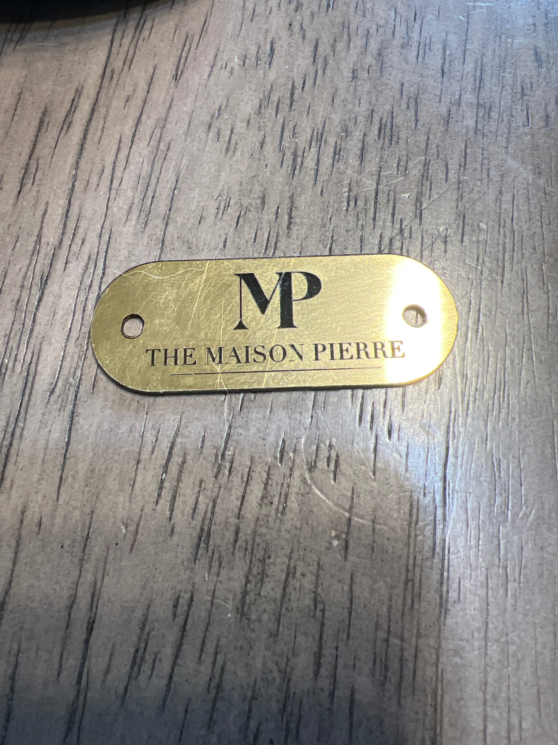

By the way, i switched to .5mm brass for this project. In 15 attempts, i only got my initial settings to work 3 times. On .5, the engraving settings i was using in the 1mm blew all the way through, despite being .2mm deep on the 1mm. I assume it has something to do with its ability to absorb more heat faster. :person_shrugging:
.5 is taking about 12 minutes with 20 passes at 20hz at 500mm/s and 200 passes at 1500mm/s and 40hz.
